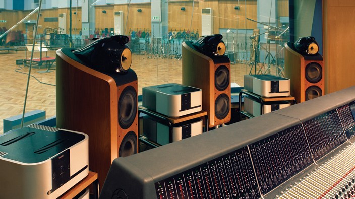

Pano, I don't blame your way of thinking. I had the exact same perception you had and figured I needed to make the sides less bright. As I did have tonality setup to sound best at the phantom center.
It is all a balance thing. Just look at speakers that show some of these deviations in their frequency curve, they usually get better reviews. Flat is not the answer. At least, not as long as we use 2 ears. Flat (or at least perceived flat, which results in a downward curve in a room) would be perfect for the side panned signals. Less so for the phantom parts. While this still might not be perfect, it is way better than doing nothing at all. The sense of realism is what I do it for. As well as the tonal balance to support that realism.
A single mono speaker would not suffer from all of this. Ask BYRTT 🙂. A huge center channel is not going to happen for me. I will, at some point, experiment with a small full range center driver to try and fill the perceived Stereo cross talk holes from a single front. I'll probably use a foam ball and have the mic in there at one ear position to rate the success of that solution.
Just read how many curves and dips there are advertised that can be linked back to what's happening here. The famous BBC dip, wrongly named but in wide use. A tilting point at 2 kHz leading to better perception of depth.
One really strange bird in all of that are the B&W 800 speakers that actually have a peak at ~3 kHz. Often quoted as being reference material and used as studio mastering speakers.
Wouldn't you just love music mixed on those speakers? They would have a natural dip at 3 kHz as the engineer would try to keep it natural sounding and actually correcting for all that excess energy they have there.
(too bad these on the picture are for Home Theatre, I do hope they used some form of EQ on those! 5.1 Material mixed on them is going to be a bit dull if they aren't)
