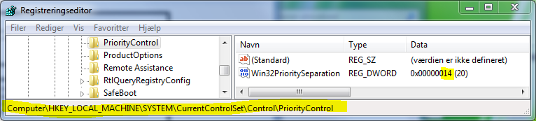

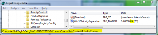

Have used tons of hours last ten days to get a new CPU/motherboard/memory to perform great sound stream 😉 you know the "eyebrows" and based on that study and to be constructive your situation have some settings to share you could try out to see if it can help also your platform, settings should make no harm simply just change them back if Zappa don't agree.
1. In "regedit" set below string to "14", role for that number is to set "Foreground and bag ground applications equally responsive" (where Win7 default is really "18" if one via GUI button set it for bag ground services and 26 if one set it to best foreground application response time which is default, but sometimes after a fresh install it starts as a older OS setting of 2 instead of 26 until one accidently over time hit ok button in the GUI).

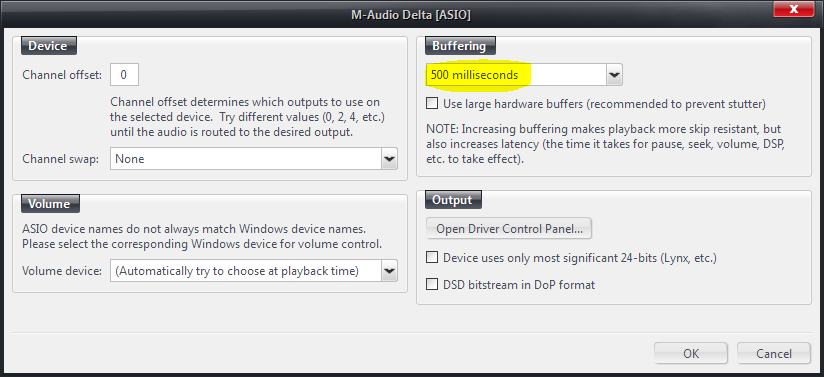

3. Set JRiver ASIO buffer to 500mS as below.

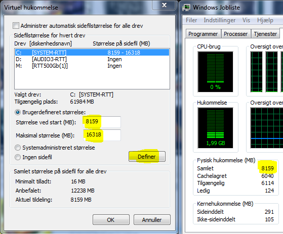

4. Set virtual memory as below where first number is taken from "Taskmgr" and second number is first x2, in study tried in general three different settings where one was default as Win7 set it and another one was ala Win10 to set it to very low numbers including the lowest possible but below was champ soundwise.
In general the four above tweaks was convincing in they worked on three different platforms one was E3-1270/C206/8Gb and new one was I7-6700K/Z170/16Gb and the old one to exchange is AMD APU A8-3870/A75/8Gb, but below point five was a bit surprising compared to old studys in the two Intel platforms had to have HPE timer turned off to get a Zappa smile. Especially the new Skylake platform was surprising in with HPE timer turned on DPC Latency raised to sky high where in past studies it used to help on latency, but a reason can be MS has modded kernel behavior down the road and ported their experience from Win8/8.1/10. By the way the new platform have stunning DPC lantency numbers with out HPE timer, with no task loaded it hovers gladly around lowish 3-12uS numbers.

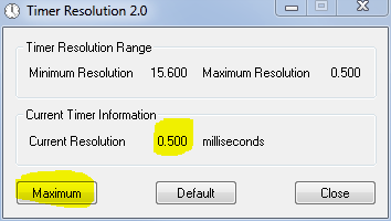

5. So for this point use ear and tools as DPC Latency Checker/LatencyMon/WinTimerTester to test if HPE timer should be turned on or off via cmd prompt as admin, "bcdedit /set useplatformclock true" then restart computer and off again "bcdedit /deletevalue useplatformclock" then restart computer.
6. When using ASUS soundcards ST/STX/STX II Win7 timer resolution is taking care of in ASUS driver software that set it to low 1mS and that should in my test be good enough when above HPE timer is on, but if HPE timer is off think use Lucas Hale tool to improve stream "Timer Resolution 2.0" to set it at lowest Win7 setting 0,5mS (link Timer Resolution – Lucas Hale).

Thanks for the reminder BYRTT, while I did have most of those settings right on my previous install I did not check all of them after a complete re-install.
