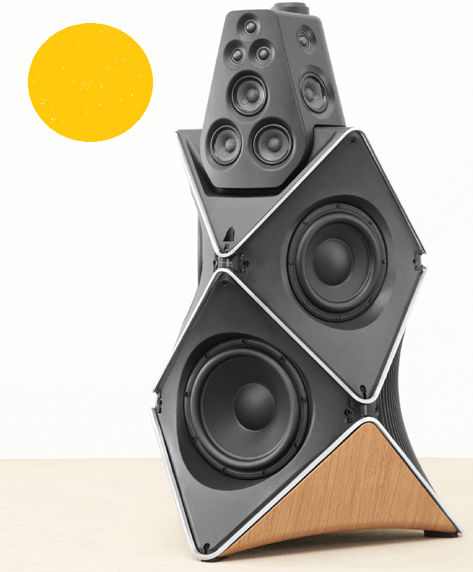

Even the Beolab 90 uses 3 10" 'Discovery line' subs (26W) in their huge pile of drivers. It gave me a chuckle to read about them on the Parts Express forum where a member called them: The Discovery Disco trio.
The bigger one is the 13" Revelator (32W) subwoofer.

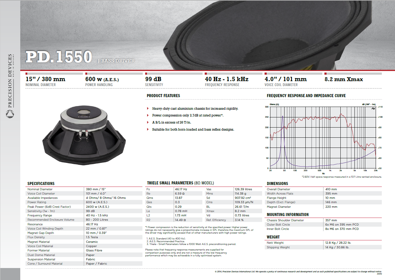

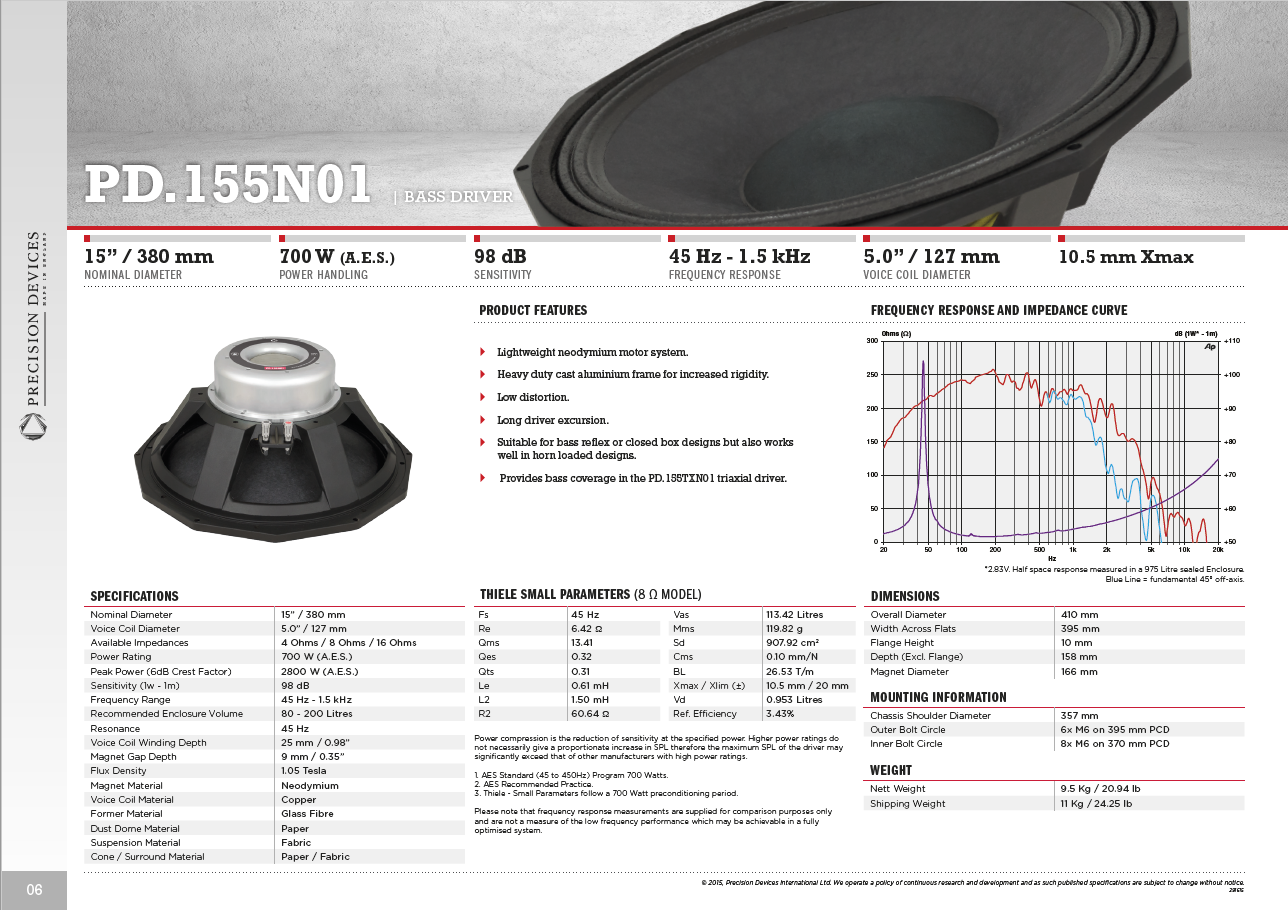

These two provided they can fit inside max allowed box volume will bring mms to Sd area down closer to TC9 numbers, UK £ is cheap these days so first is close to cost of XXL/SS and second bit more costly.
Precision Devices PD.1550 PD1550 600W 15" Driver 8 ohm from Precision Devices 199.99 IN STOCK (20 Dec 2016)
Precision Devices PD.155N01 - 15" 700W Bass Driver 8Ohm 295.00

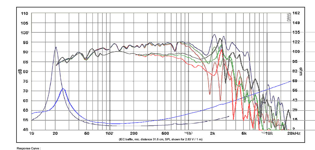

Ah.. those are 15", that's way too large. I was eyeing the SB 34NRXL75-8 as a viable candidate, lower mms, higher BL than the 30W/XXLS. Paper cone even.
This one from SB has a slightly larger cone, with 10mm x-max. The upper trace in the graph (obviously) is the SB driver.
This SB driver is already going to be a tight fit.
Mms of the Sb one is 93 gram with BL16.6 compared to 135 gram with 10.5 BL of the 30W.

The cones are made of paper but they are so hard that they behave much more like aluminium in that the breakup is more pronounced. That is not an issue for sub use with plenty of filtering but something to consider if the choice of material is important.
