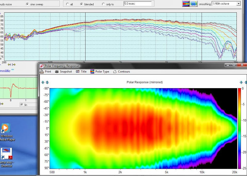

The roundover I used in front of the drivers will act as a (very short) waveguide. The first time I saw member koldby's arrays I seriously started to consider using an aluminium baffle. However I wanted to make sure the performance potential would not be compromised. I started on a search hunt to see if someone had done something similar, documented with measurements. I found a member on a German forum who had done just that. I have linked to the graphs posted on that thread many pages ago. Sadly those graphs vanished over time. The thread was located here: ViFAST - für 50Euronen (SDS 5 1/4 + Vifa 9 BN 119/8) **fertig! Weiche S.3** - DIY-HIFI-Forum
I did look at the wayback machine results of his thread later on and was able to retrieve the flush mounted graph, sadly not the better performing "mit radius" graph.
The German text still confirms what I saw though...
He had a 9 mm radius on a 9 mm front baffle. It made a difference in the off-axis plots, actually improving them compared to the flush mounted driver. There was less difference between on and off axis SPL in the back mounted (those with roundover) plots. That was enough proof for me to go ahead. I decided on a 6 mm baffle with 8 mm radius. It had the best flow when looked at in a cross section.
No regrets here 🙂, I wouldn't have done it if I thought it had a compromised performance.
bündig eingelassen:
und jetzt mit radius, beide 0°:
-> mit radius leicht zappeliger
-> kontinuierliche aufladung relativiert schalldruckanstieg des chassis
-> als netter nebeneffekt wird das peak um 8khz durch die geometrischen maßnahmen entschärft
hier nochmal beide winkelmessungen gegeneinander
bündig eingelassen:
mit radius:
-> der schallwandbedingte bündelungseffekt zwischen 2 und 4khz wird deutlich entschräft
-> die nun entstandene relative senke bei 10khz wird energetisch unter winkel aufgefüllt

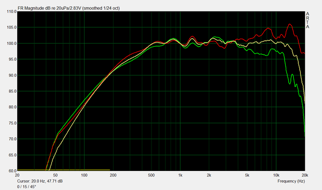

Impedance of driver on baffle, no damping and final damping scheme using wool and fiberglass insulation:
(tests of the test enclosure with a single driver)
Impedance of the 25 drivers in the enclosure (blue curve):
The reddish curve was a first shot at a correction network, I removed the correction for the top end raise in impedance later on.
Fun to see the final impedance peak of the 25 drivers is at least as low as a single driver in open air.
(final) Correction network added later on:
Upper trace is phase, lower is impedance...

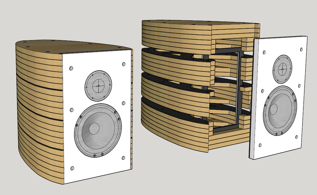

Okay, much tweaking to the design -credit to all the great feedback from you guys!
I took Ronald's advice and left the top and bottom of the baffle opened. I also added about 1/32" on both sides of the baffle for a little wiggle room. The cabinet is massive, about 21" deep by 14" wide. It should be incredibly rigid with nearly 2" thick sidewalls and 1.5" tops and bottoms. The bracing is very heavy throughout. I'm still trying to figure out how to hide the bolt holes on top, but I'll work it out. The front with the cabinet edges is slightly bigger than the kit specified, the internal dimensions are an exact match.
I think the baffle mount should be particularly effective. I'm going to make an aluminum internal frame with a neoprene gasket for the inside of the cabinet. The baffle will be bolted to the aluminum butted up against the wood frame. I'll be able to make the bolt holes in the wood slightly larger to allow for some flex. I think this should create a nice float for the baffle and provide a very solid structure overall.
Please feel free to share your thoughts. I'm itching to start cutting wood!
I don't really understand the value of the aluminium sub baffle as it will make construction much more difficult.
I would just use threaded insert nuts to mount the front baffle to the wood. Like these https://elraco.com.au/product_info.php/insert-nut-thread-8mm-overall-length-p-1120

I've got to agree with fluid here, The aluminium support doesn't seem to add to the construction, merely complicate it. In my baffle construction I wanted the baffle, holding the drivers to be separately floating and damped as to not excite the enclosure. The second layer of the baffle is a CLD construction. Here your aluminium support only supplies a rigid mounting point. It does not put pré-tension on the enclosure, like Magico did, you could put neoprene between the aluminium and the enclosure to have a damped structure holding the baffle though, was that the idea? Neoprene between baffle and enclosure, neoprene between aluminium and the enclosure and bolt that to each other... hmmm, that might make a floating, damped baffle construction.
Another thing that popped into my mind after seeing your sketch... complicating things further though... How about a shallow waveguide for that tweeter. Something the size of the cone of the woofer. It would provide time alignment between tweeter and woofer and support the bottom end performance of the tweeter. Preferably a bit oval to keep tweeter and woofer as close together as possible...
It would make it harder to construct though, and keep it beautiful.
But judging from the measurements Geddes did on the Behringers it might be worth the trouble, an older version of Behringers became quite famous (basically they are all cheap Genelec copies) in a certain listening test: http://www.diyaudio.com/forums/multi-way/177403-linkwitz-orions-beaten-behringer-what.html
Geddes had the results up on his website.
As to the bolts, I would use threaded rods and fix them on the top side, one layer beneath the top (the beauty layer) for instance by welding a rod or offset ring to it that can be fixed to that second layer of the stack.
Yes, that is exactly what I was thinking -neoprene on either side of the wood cabinet frame. So baffle; neoprene; wood frame; neoprene; aluminum support.
Perhaps fluid is right with the insert nuts, at least for my first project. This would be much easier to build.
I think the waveguides are a bit too ambitious for this project. I'll keep that concept saved for future projects.
For the bolts, I was figuring I would secure the heads to the second layer down. Perhaps I would screw the top layer to the second layer from underneath with the bolts in place then assemble the layers upside down from top to bottom. Yup, that should work.
Time to start laying out my cut sheets and ordering some materials!
