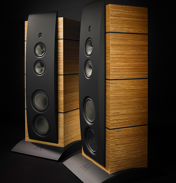

Back to the building questions. I believe we touched on this, but I'm still unsure about how to determine the wall thickness. Would thicker be better? Would that not create both increased rigidity and more glued surface for improved structural solidity? Am I missing something about making them too thick -rigidity seems to be in favor among the super speaker makers like Magico and YG.
And thank you again for all the terrific feedback!
Yes, Magico was definitely on that path of "thicker is better".
In my own endeavours I figured I had to count in the fact that my speaker enclosure was meant to withstand 20 to 20000 Hz. But every little speaker only had to do a little part of that.
There are trains of thought about thin walled speakers too, like the work of Harbeth for the BBC.
Personally I also liked the idea of some static weight in the enclosure itself opposing the moving mass of the drivers.
This is one of the questions that has been debated a lot. I believe in rigid enclosures, for a 2 or 3 way like you are planning I would opt for the Geddes type of bracing (rods with planned/build in damping). Personally I would use thicker walls on your proposed speaker plans in comparison to my own. One or two drivers do all the SPL while in my case each driver does next to nothing... Together though they can produce massive SPL levels.
My 'moving mass' of one complete speaker (25 drivers) is about 60 grams(!) The enclosure weight is more than 65 Kg. What do your proposed driver cones weigh?
The thin walled enclosure theory is cute, but didn't do it for me. I can't help but think it will colour the sound in the bass department. Well damped rigid enclosure walls did make more sense to me. I also have a damped baffle construction etc. It worked for me.
