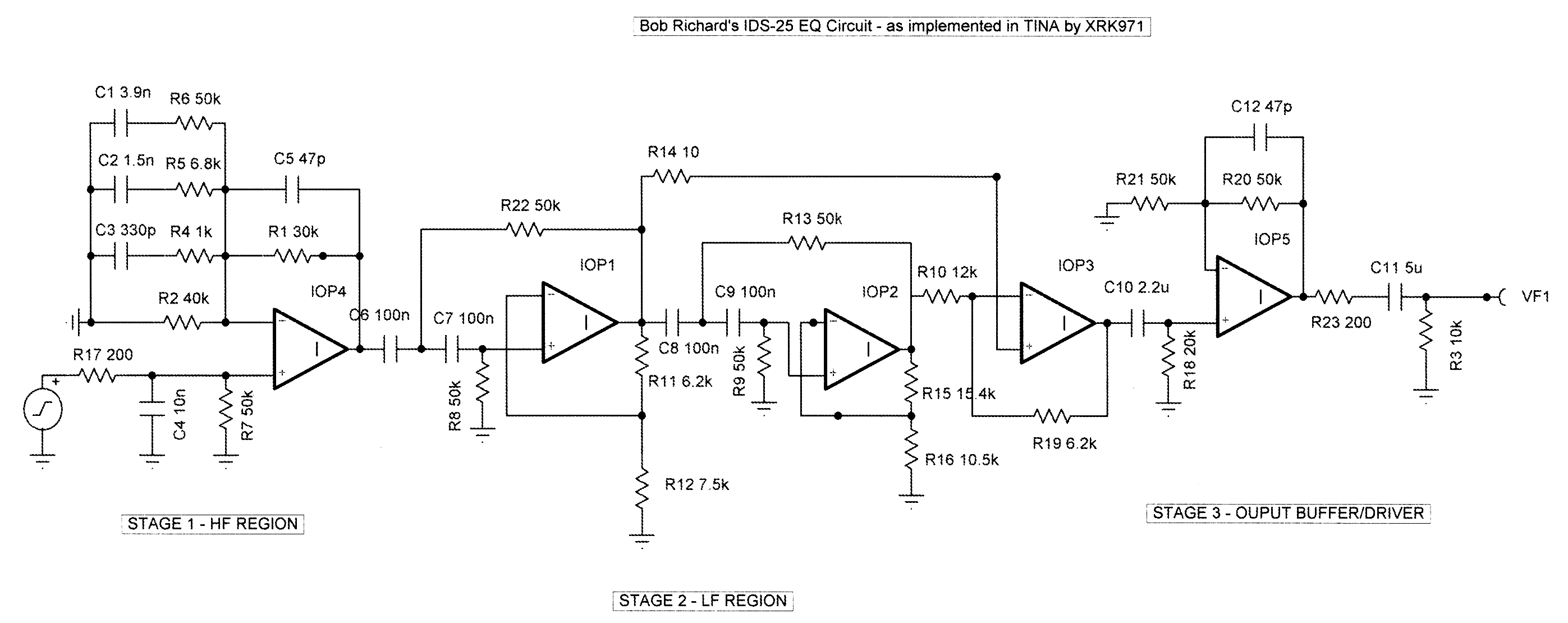

I remember when Bob and I were working on an analog EQ circuit for this array - it was 5 op amps if I recall. I guess with all the great stuff you do in Jriver and a sound card - no need for analog EQ or DEQX box. 🙂
Still, I wonder what an analog EQ circuit would sound like in your array - sort of like how Roger Russell did it?
Edit: found the circuit
http://www.diyaudio.com/forums/full-range/203356-cloning-ids-25s-22.html
I think I have a pretty good idea what it would sound like. Right after finishing the arrays I made an EQ curve exactly like that. I have listened to that curve for about a month. A fun filled month, though it's no comparison to what I did later on. 🙂
It had quite a bit of drama though, the bass was exaggerated and so were the highs. This EQ scheme made my son and girlfriend yell at me from time to time, They heard something in the highs that I missed completely 😱.
Wesayso,
Would it be worth it to build an EQ circuit like this for those times when you want a "live" capability without CPU latency imposed in the sound? Or for those occasions where you want a simple source-preamp-EQ-amp-speaker chain that's all analog? I have been building a lot of amps lately and this circuit would certainly be simple to implement on a 2 layer PCB and not cost hardly anything to make.
Yes, it would do quite nicely for casual listening. But based on my processing chain I'd probably would benefit from some small changes overall as I could easily read out an average EQ of what I'm doing now.
It would most certainly be useful!
