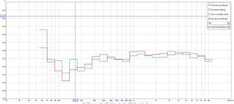

wesayso, I was wondering if your kicker and/or added ambience energy was causing bumps in your GD plot?
I can't say I've looked at GD plots in a joint measurement of ambience and mains.
I usually look at the 2 separately, as I can isolate them.
The only data I collect needing the both of them together is to determine or check the delay set for the ambient channels. So I don't have that many measurements with the both of them.
For the group delay I'm still looking at both REW and APL_TDA. It made it easier to see the ambience channel's time spread too. I should redo some of the measurements sometime soon, but I'm kinda busy with other things at the moment and am enjoying the sound I've got in the mean time.

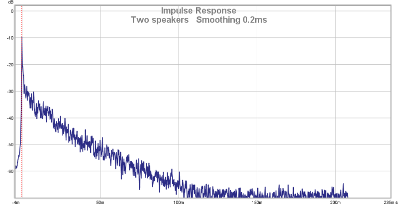

With my ambient speakers going, my Rt60 is in the .25 - .30 range (>300hz). Hardly dead.
If you want to talk about my room specifically in detail, it would be better over at Gearslutz (see thread link below my post).
Did you guys catch Pano's cave? http://www.diyaudio.com/forums/multi-way/269864-caveman-speakers-troglodytes.html
If you look at his ETC:
http://www.diyaudio.com/forums/multi-way/269864-caveman-speakers-troglodytes-6.html#post4519064
Maybe we should all have a cave like that to play with... 🙂
Thats about what my ETC would look like without a kicker or ambient speakers.
