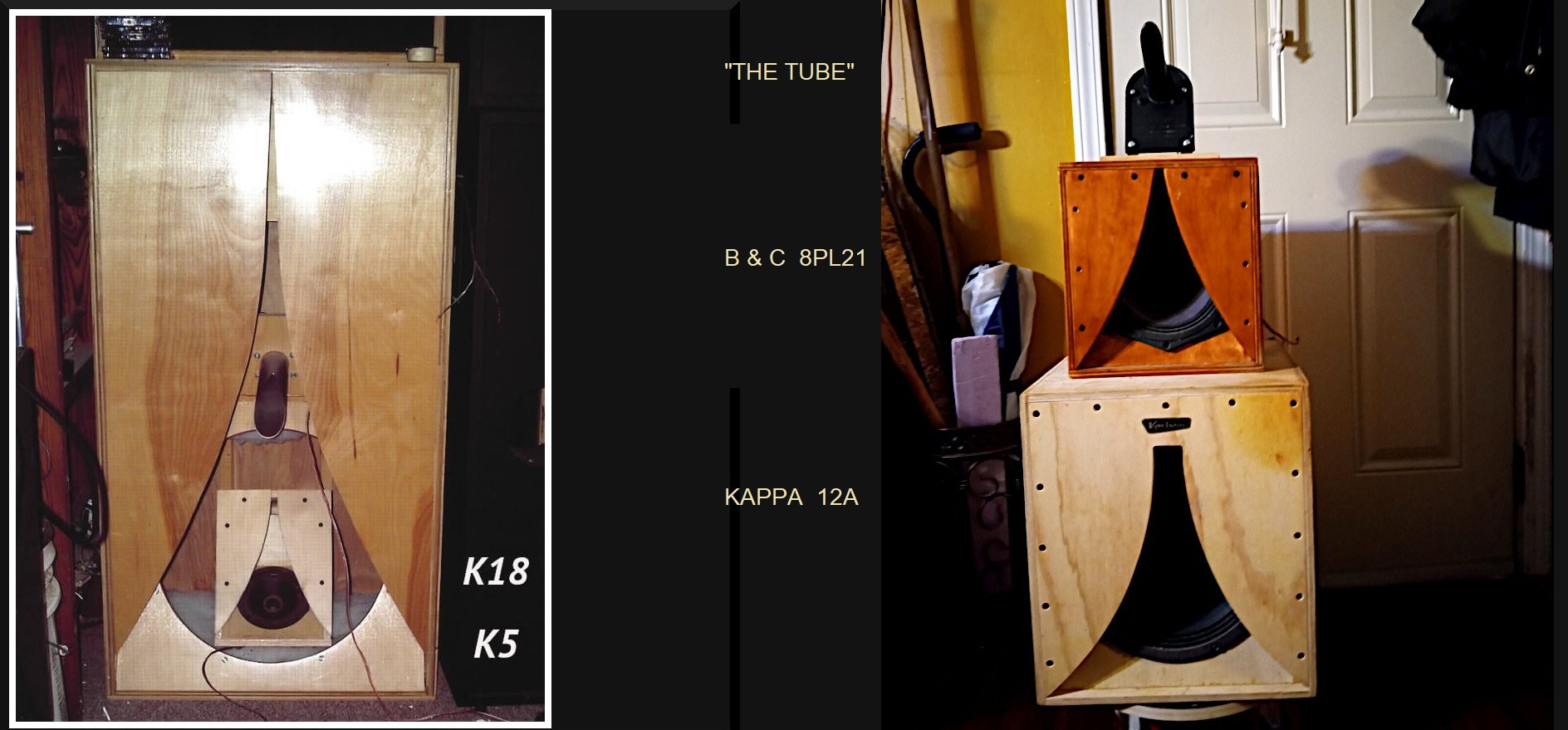

I really like the idea of apply driver ports to flat baffled speakers for an acoustic low-pass. Like what Danley does with synergies, but why can't it work for flat baffles too, huh?

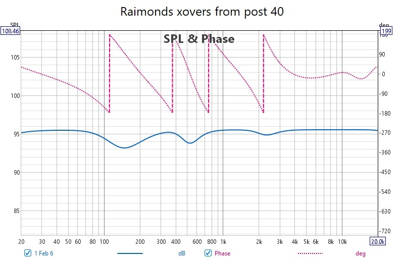

I built a quick processor schematic in q-sys shown at bottom, for the above xovers frequencies and orders, using your Option2 (ala Linkwitz style)

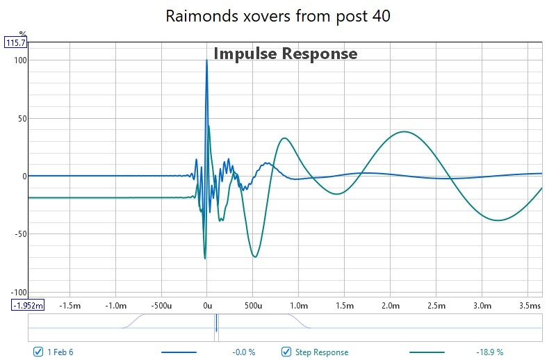

Here's the measured summed mag and phase, and then impulse and step.
I did not do the all-pass addition Linkwitz recommends, hence the degree of ripple.
I'm curious how you plan to implement steep IIR xovers, as we know how much they are going to muck up phase, impulse and step.
Are you eventually planning on some phase linearization of the IIR's, or maybe just using linear phase xovers???

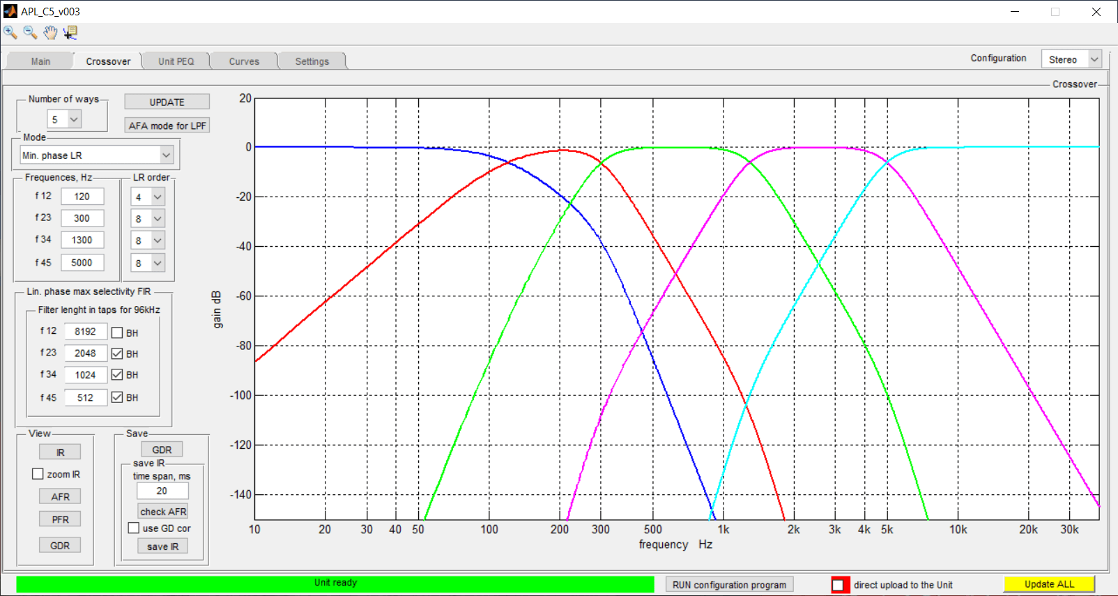

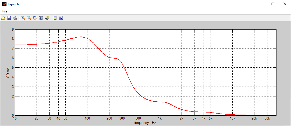

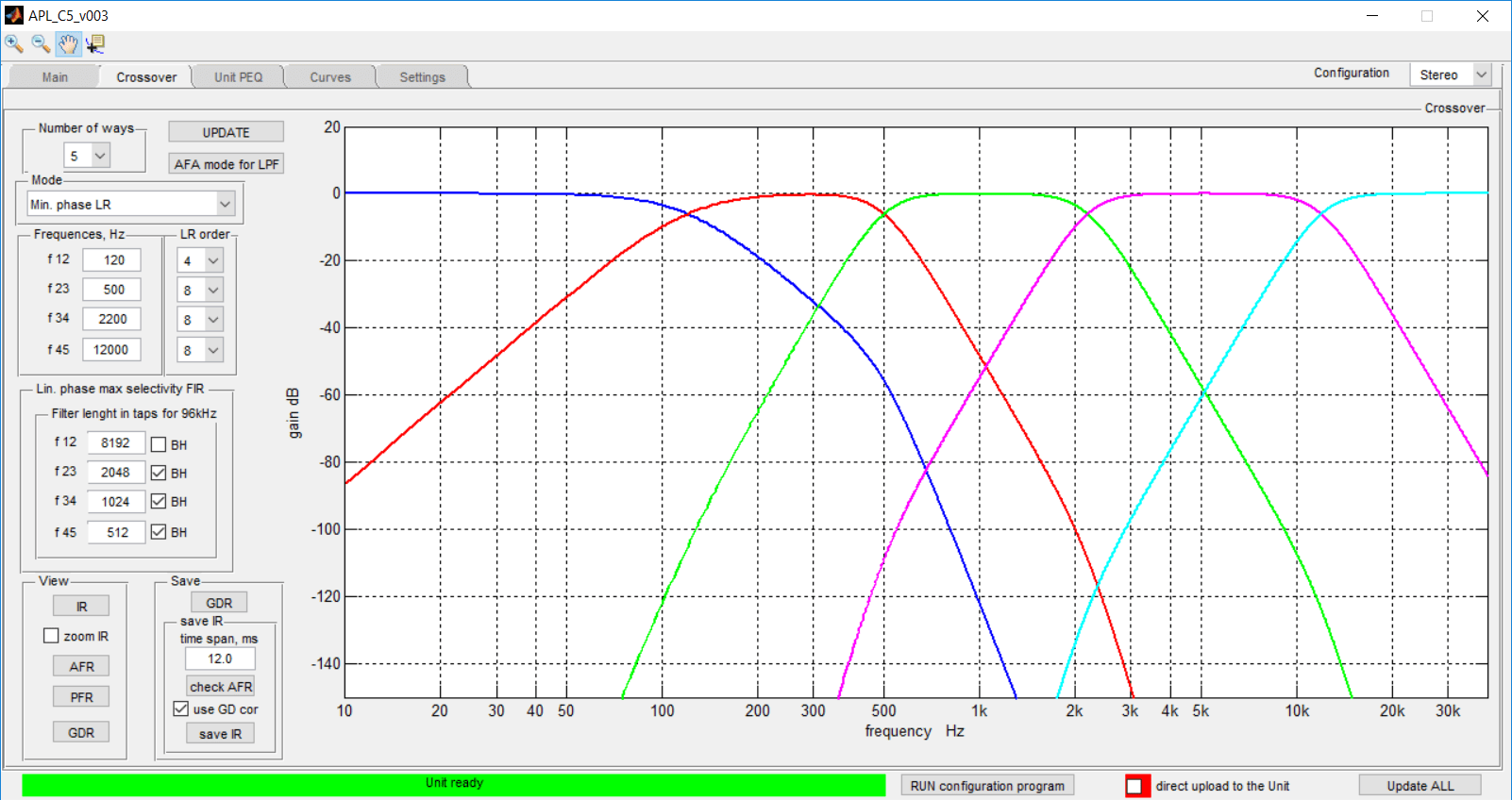

And the example of post 40 - how it looks like in the C5
The approach "All filters for all ways" is in use and results are such:
Summed magnitude:

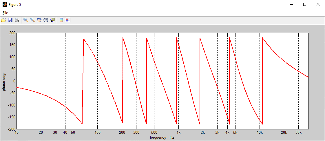

Summed Phase:
Summed Group Delay
Summed Impulse Response:
Summed magnitude:
Summed Phase:
Summed Group Delay
Individual IRs of all way one by one will follow.

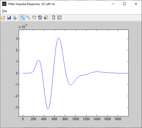

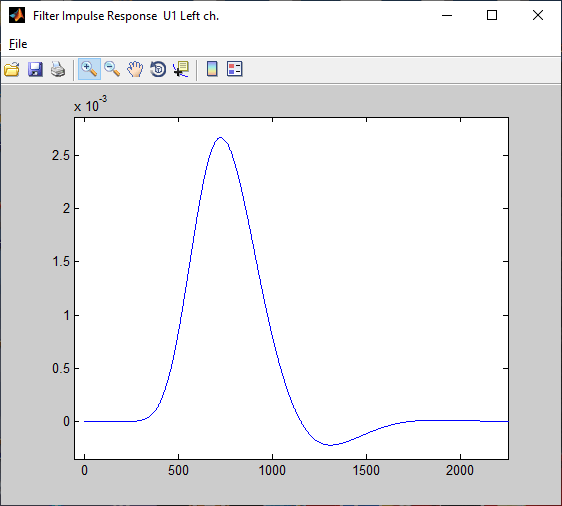

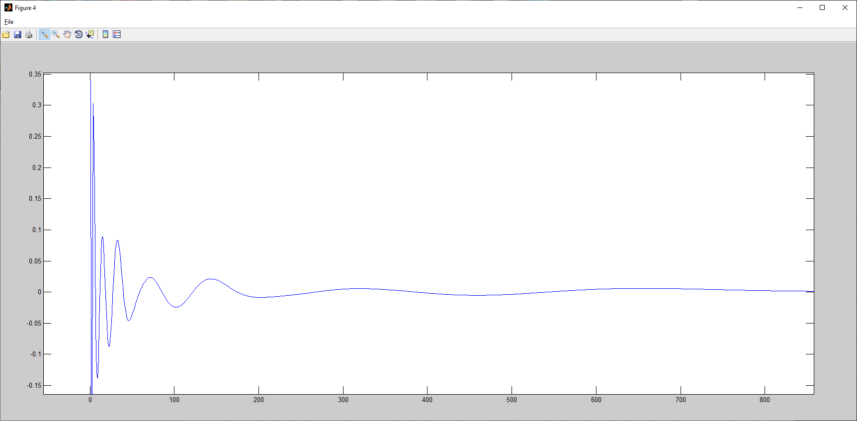

Individual IRs of all ways one by one:

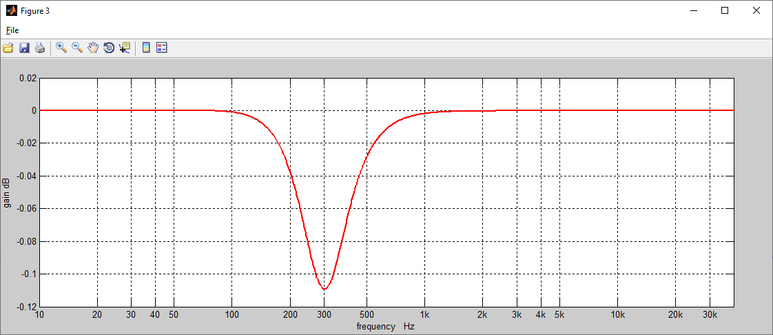

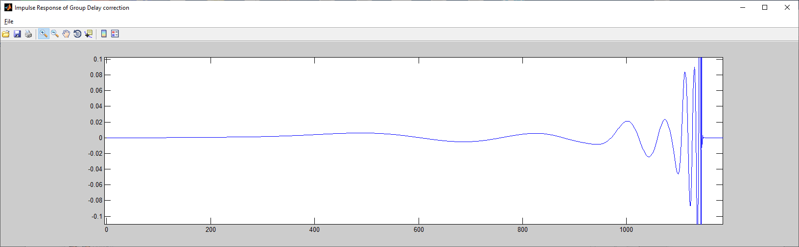

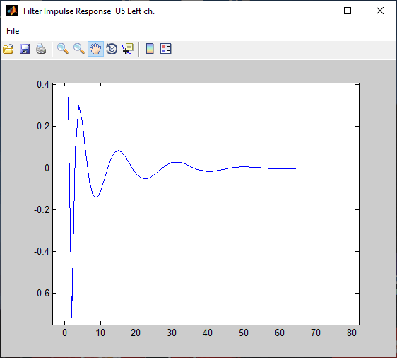

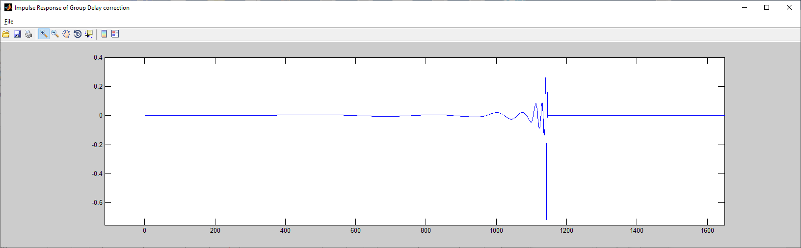

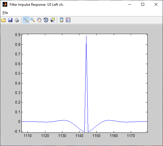

If we have summed IR of crossover, we can use it as all pass filter to lineariz the overall phase of the crossover by sacrificing a minimal latency possible.
That should be found by a trial. Let`s take some latency number that is about 1.5 times bigger max value of GD curve,
cut such part of inverted summed IR and check its magnitude`s response

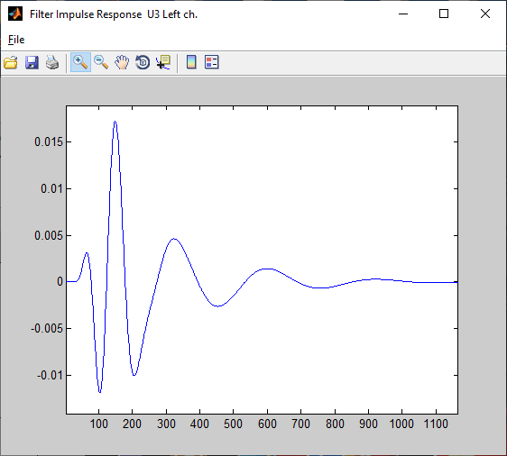

Here is inverted IR with latensy "cut" of 12 ms in use.
and slightly zoomed
It has magnitude error because of cut of 12 ms
If we are happy with a particular error`s value, we have result. If not, increase or decrease the latency value to meet requirements

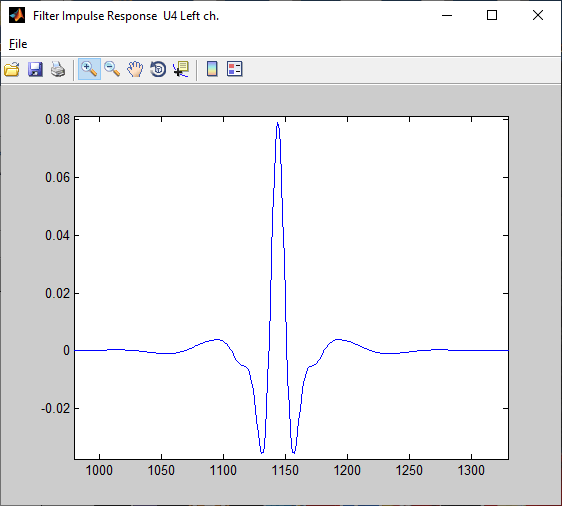

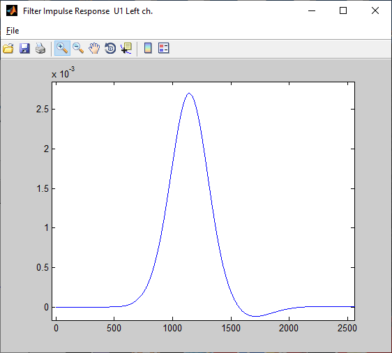

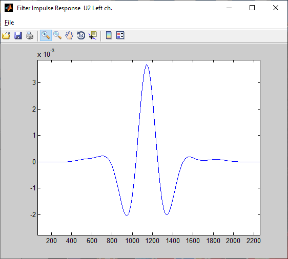

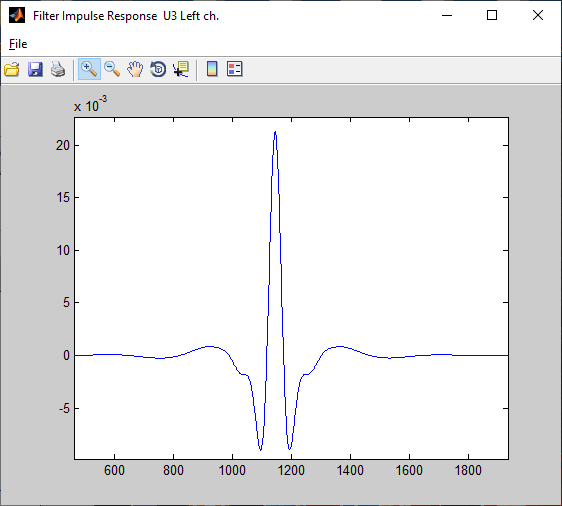

And all IRs after all pass filter from summary IR has been used:
As you see, they all are symmetrical which means a linear phase behavior.
And IR curves above is describing that.
It is done. The TDA curve in the post #8 is showing that.Are you eventually planning on some phase linearization of the IIR's, or maybe just using linear phase xovers???
and slightly zoomed
Yes, 8th order should be steep. But the beauty is to implement them not by use of IIR math but by creating virtual IIRs in FIR machine - by combining any number of IIRs necessary.I'm curious how you plan to implement steep IIR xovers, as we know how much they are going to muck up phase, impulse and step.
I still do not get what advantage that would bring over conventional HP filtering, other than having yet another radiating element in the baffle. Would anyone be so kind as to explain that?I really like the idea of apply driver ports to flat baffled speakers for an acoustic low-pass.
Potentially lower (driver) distorsion due to lp-filtering.what advantage that would bring
That does not make sense to me: conventional LP filtering does the same thing as the total transfer function is supposed to remain the same. Furthermore, excursion above say 150Hz is so low the filtering has hardly any impact on excursion induced distortion.
It doen't for distorsion induced by loudspeaker drivers.does the same thing
That is the reason some people say bandpass speaker drivers are more likely to be overdriven - you don't hear the alarming distorsion (at least not so much).
"People" say all sorts of things about audio. I am not yet convinced so far. Measurements or it did not happen.
Basically, the high frequency / high order distortion products will be acoustically filtered out.
Looks like a solution looking for a problem.
But now at least the line of thinking has become clear, but still I would like to see whether the claim that mechanical filtering offers improvement over electric filtering can be substantiated, especially since the pipes or slots may have their own issues.
It does not offer improvements beside the fact that filtering prior to the main distorting element (the driver) has no/less effect compared to filtering after the distorting driver.mechanical filtering offers improvement over electric filtering can be substantiated, especially since the pipes
while ports do have their flaws they behave incredibly well if done right, also considering their huge virtual "xmax". This I found out doing my helmholtz port investigations.
Yes, the individual impulses say it all, very nice.Individual IRs of all ways one by one:
And sorry i didn't catch the TDA summation in post #8 showing already done.

The idea as I understand it, is the level of harmonic distortion being generated by fundamental frequencies of the driver below the electrical lowpass, are reduced by the additional acoustic low-pass provided by the trapped air enclosure that using ports gives.I still do not get what advantage that would bring over conventional HP filtering, other than having yet another radiating element in the baffle. Would anyone be so kind as to explain that?
A transfer function shows frequency magnitude response and phase, but doesn't show harmonic distortion.
I think you could get near identical transfer functions from open cone and enclosed/ported cone.
I guess the best way to test the acoustic low pass harmonic distortion reduction would be to mount a driver in a box, and compare distortion with plates & ports put over the cone. See if the open cone has more harmonic distortion that the ported cone.
Danley has posted a bit on the acoustic low pass...you may want to search him for it..
