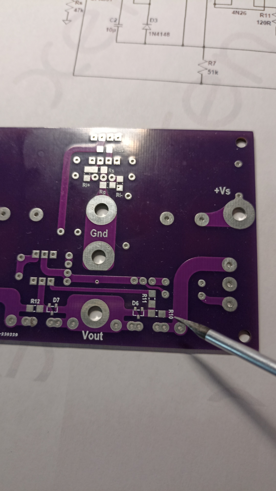

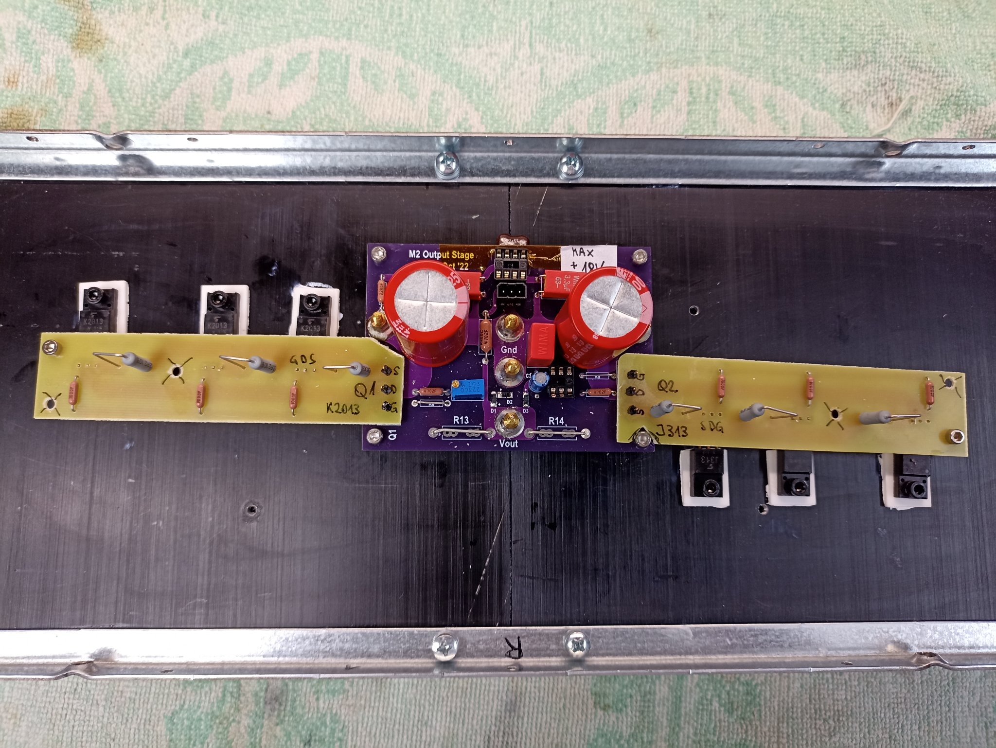

He shorted R13,14 on the main PCB.
Because you have multiple MOSFETs in parallel, they each have to have their own R13,14 to prevent current hogging.
But now you need to take one of those to allow the opto to sense.
And of course each new R13,14 should be 3x their previous values.

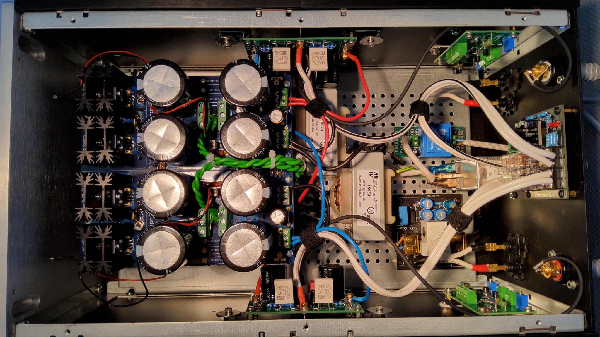

Opamp compare

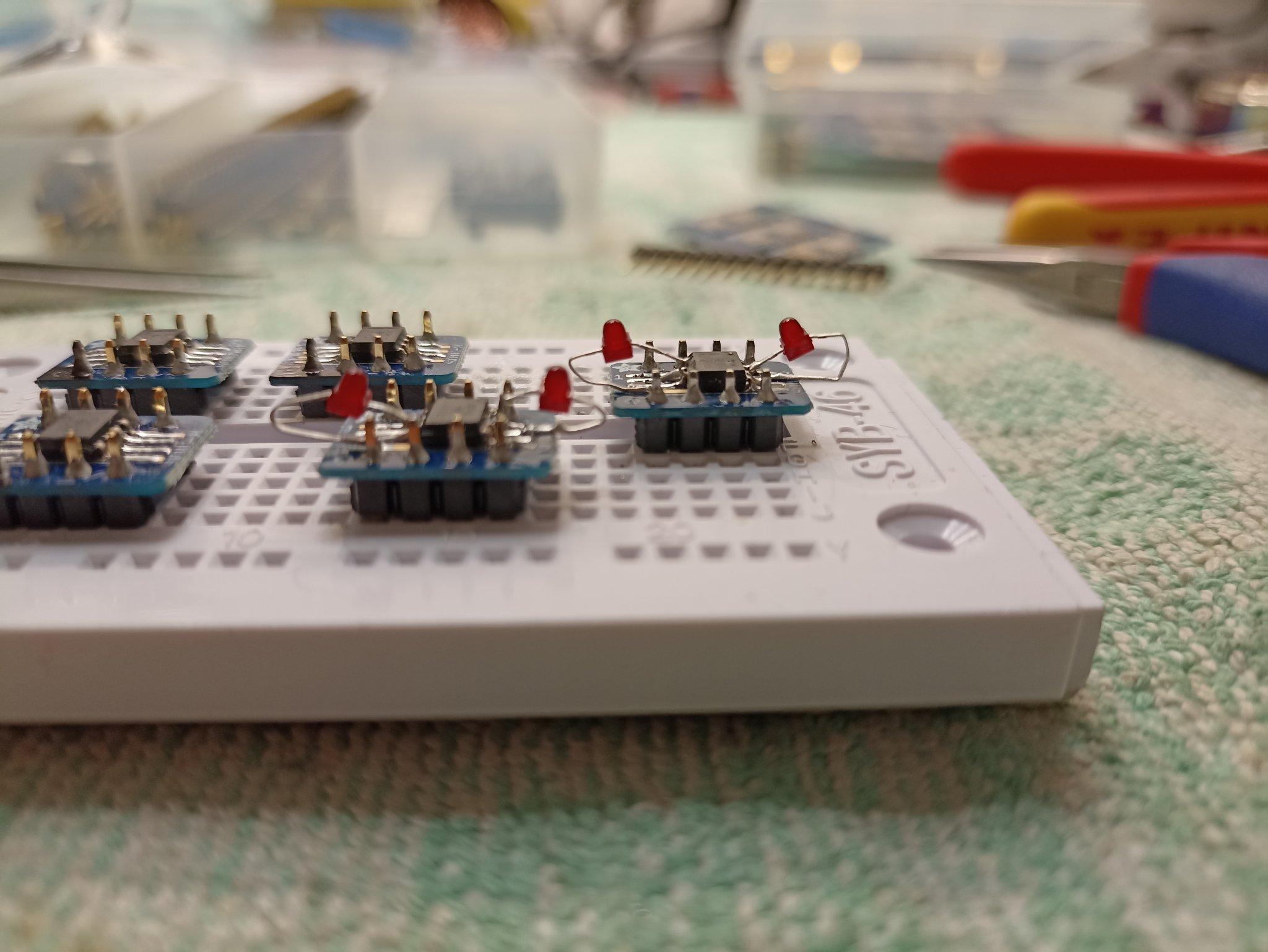

I finally close this year with experiences of mine with opamp rolling on different M2OPS with different output MOSFETS which I tried.
These findings are supjective and include no overall „truth“ ….
Pre amp is always Wayne with Toshiba´s as output BJT Transistors…….
M2OPS with curve traced Toshibas from EUVL(XEN audio-Patrick)​

The Toshiba K3497/J618 are high transconductance, but also somewhat high capacitance, compared to the Fairchild's.
So no surprise you find it darker.
They should go with fast frontend capable of driving some load.
If you want to compare apples to apples, use K1530/J201.
And you should give ADA4627 a go.
Supposed to be same as OPA627.
Can even try 637, since gain is high enough.

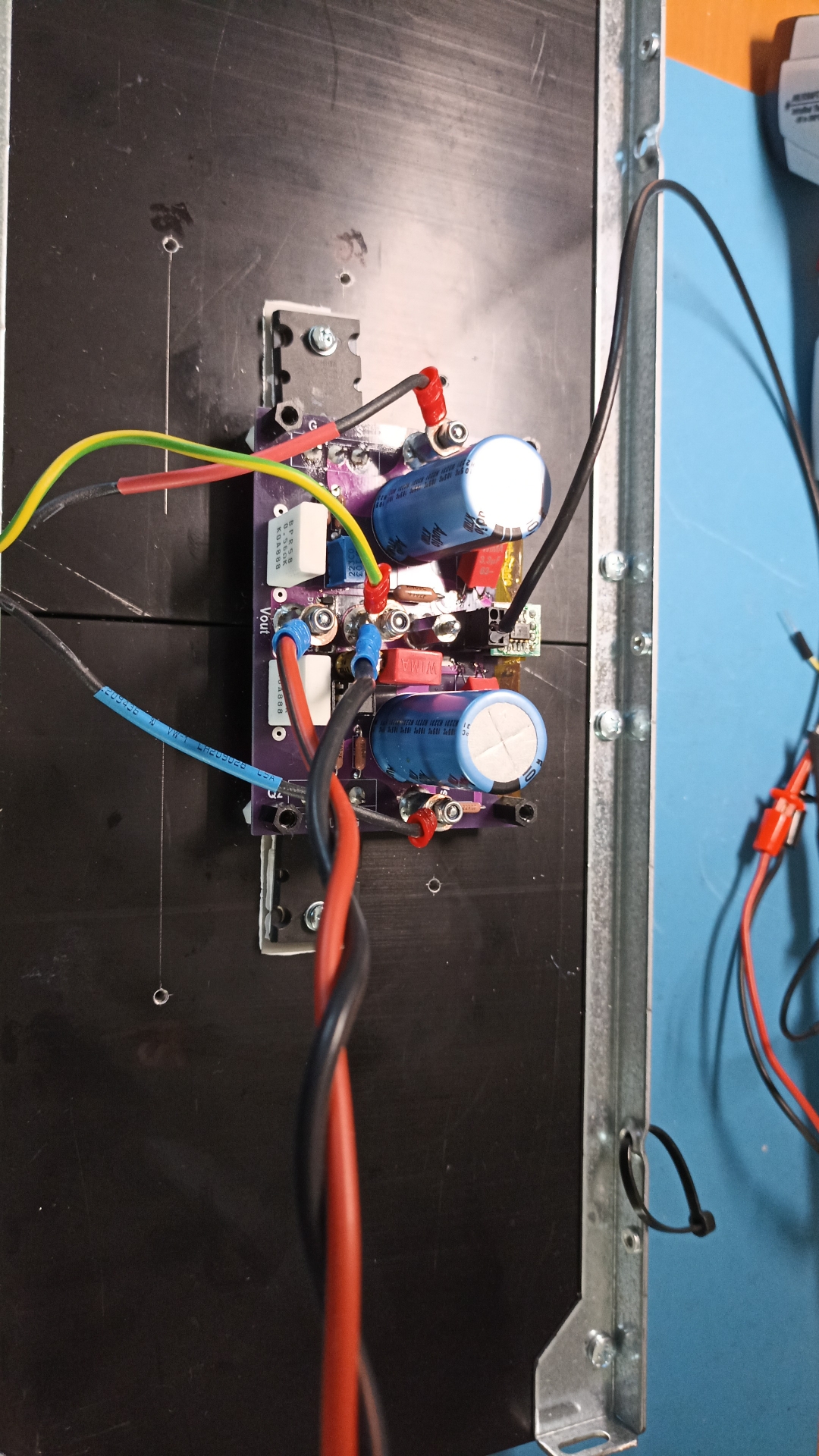

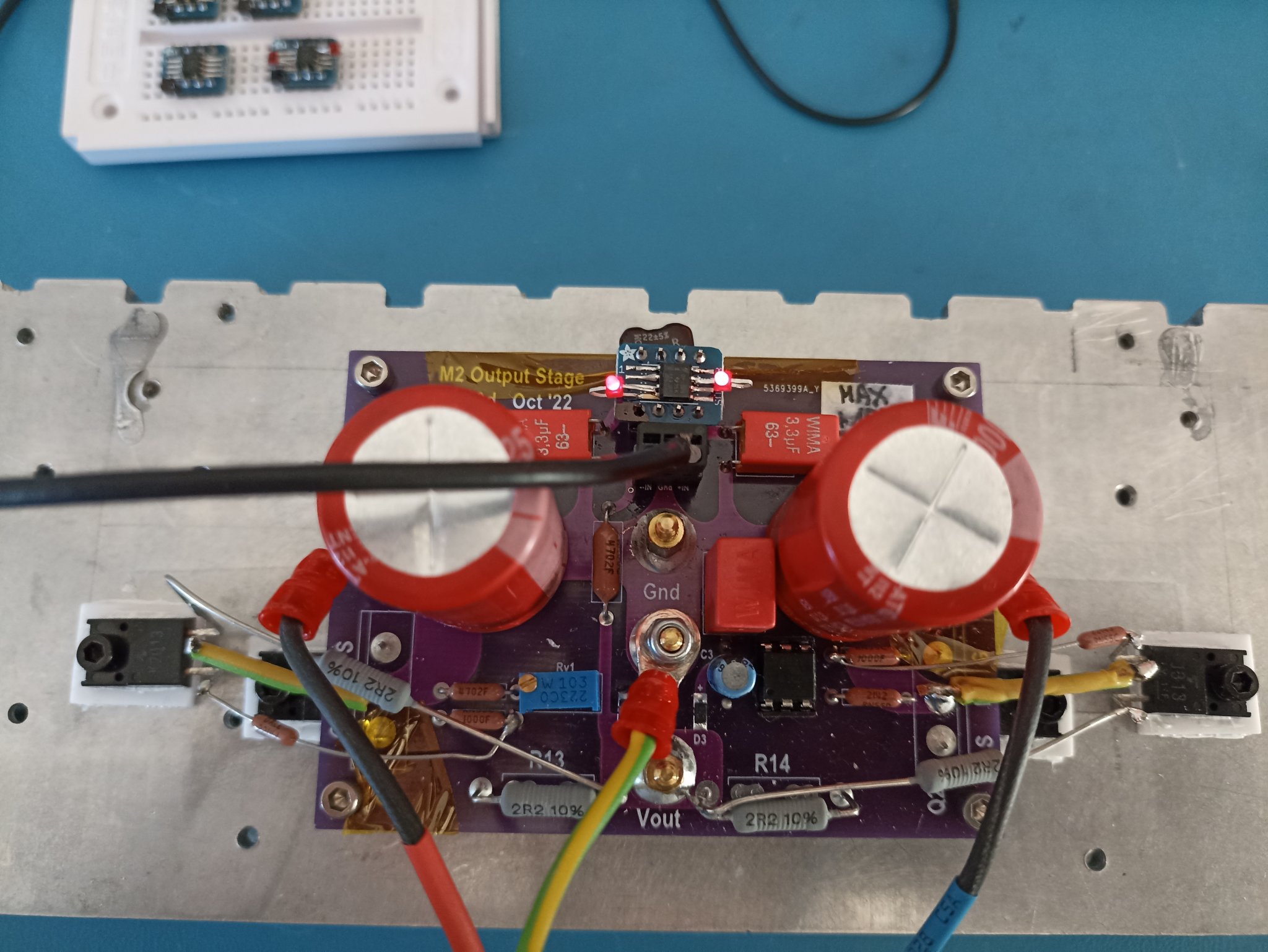

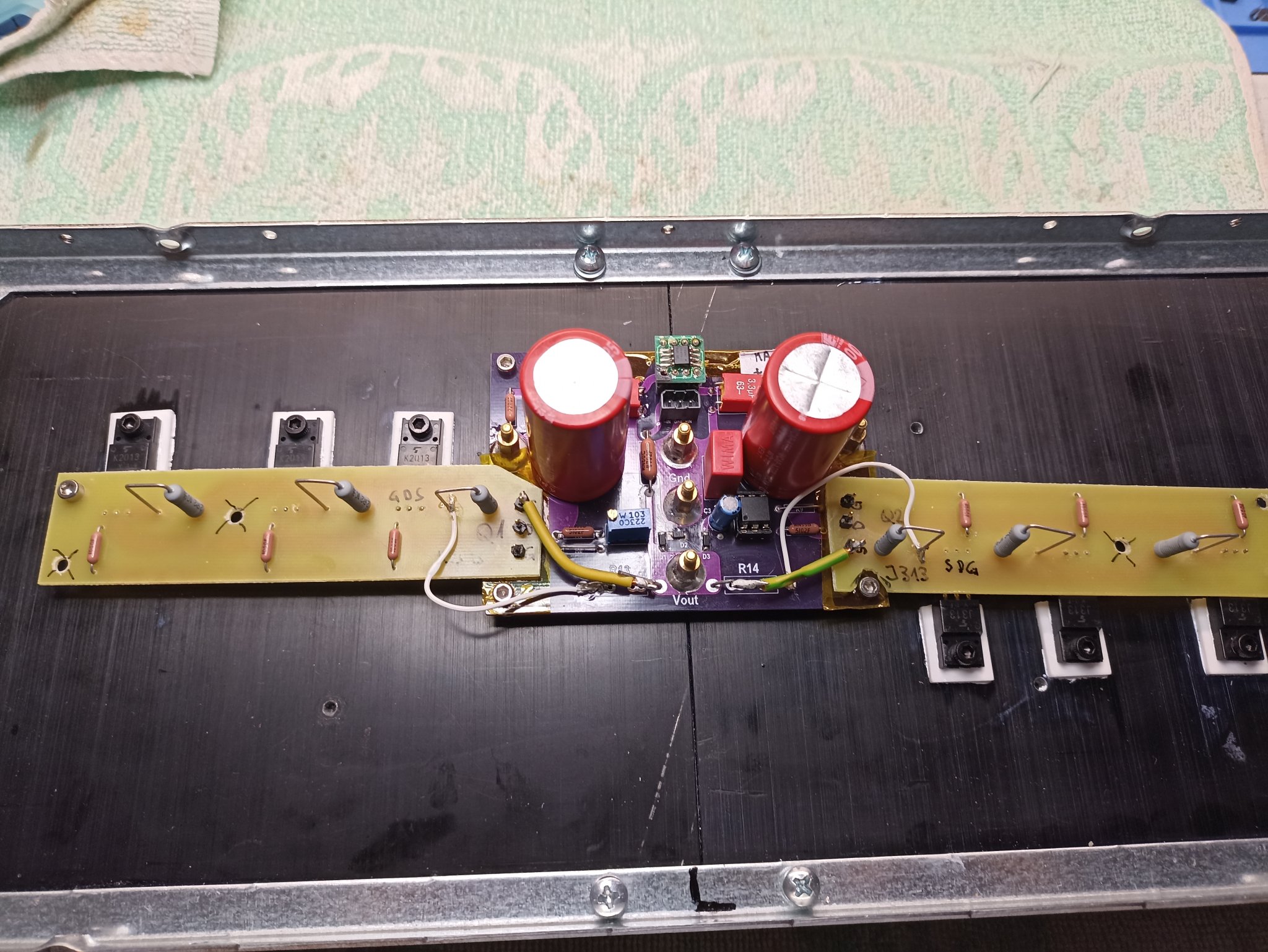

Hey everyone, I wanted to share my exciting journey with the M2OPS. You know, for the past year, I've been building, modifying, and testing the 'Holy Grail' with Fairchild's FQA28N15/FQA36P15 – many thanks to lhquam for this awesome project!
Now, it was finally time to try out the Toshiba 2SK3497/2SJ618, which were originally intended for the M2OPS and had been patiently waiting in my drawer for their turn. And guess what? Despite their high positive tempCo, they were working in this circuit. However, the measurement results were slightly worse than the Fairchilds, and the sound didn't quite convince me personally (https://www.diyaudio.com/community/...ower-output-stage.406850/page-38#post-7777396).
Also, I experimented with an OPA604, which unfortunately wasn't so successful. There was always a noticeable ringing that I just couldn't get rid of.

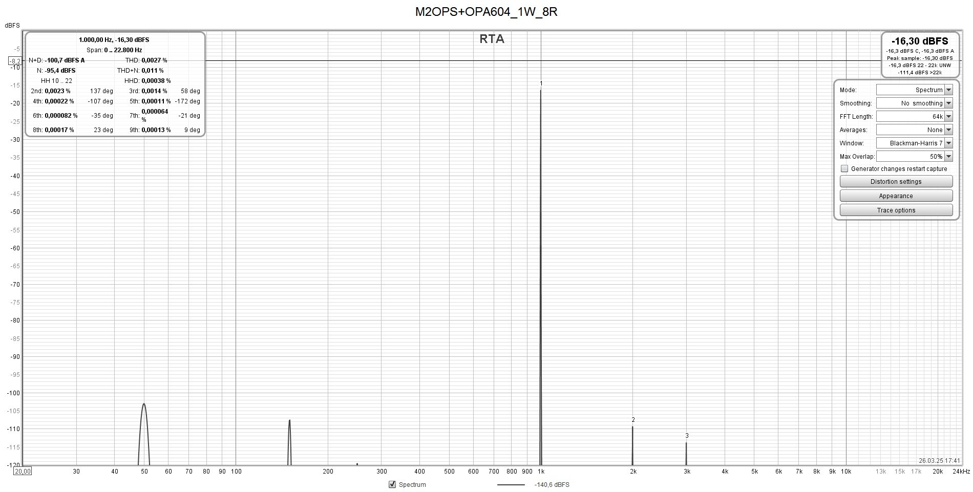

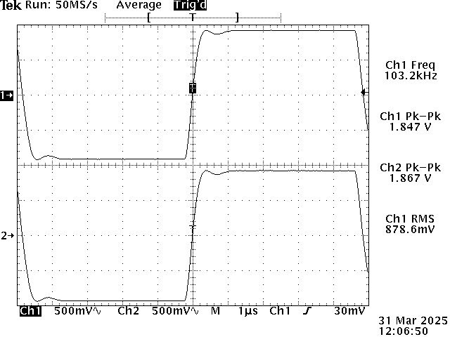

But here's the cool part: Two M2OPS boards have taken the place of the HGF in my monoblock chassis. The power supply remains the same at +/- 23.5 V. With a bias current of 1.48 A, the offset stabilized after 20 minutes from 22 mV at 20°C to +/- 1 mV at 45°C.
The measurement results are simply outstanding, and the OPA604 feels right at home in this environment! The test with a 100 kHz square wave is almost perfect. And the response to a complex load of 8R || 100 nF is no different from a purely resistive 8R. The small waving becomes invisible at 10 kHz test frequency 😉. The THD of 0.0027% at 1 W into 8R and the harmonic distribution match the predictions in Fran's test pattern perfectly.
Compared to the HGF, this means that the Toshiba MOSFETs perform better when source resistors are used. Why is that? Good question! But it's clear that the source resistors help to linearize the transfer characteristics of the MOSFETs.
At this point, I'd like to extend a huge thank you to Patrick (EUVL) and everyone else who made this project possible.
Yes, I really enjoyed this journey!
