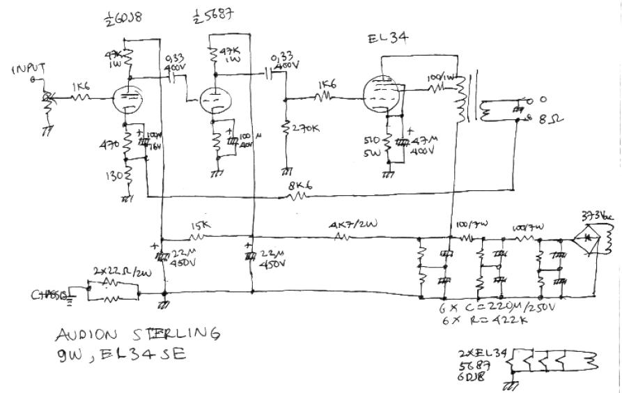

Tubelab Sir, attached is a schematic of Audion Sterling EL34. How often I wondered why on earth does it use the additional gain stage that your design does not have. And those 2 gain stages uses 47kohm plate resistor. Can it be simply be substituted with 10M45 using the same 1K on G and 330 ohms?
The extra stage is needed to provide more gain. And more gain is needed because this amplifier uses global negative feedback (sometimes referred as GNFb), to reduce distortions.
