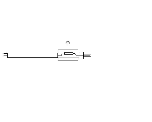

Hi to All!!!
My friend owns Ra-314 and the problem is at high gain of the amplifier.On 9 clock on potentiometer it's to loud for normal listening specially on quietly night lis.
My question is where to reduce the gain of amp?
Pot is 100kohm,input impedance of preamp is 220khom(R506,505).
Thanks for Help!!!

That must be one of the funniest questions I have read in a long time.
But, if you do want to be able to turn the amplifier up to 9 o'clock and for it to be a bit quieter you simply need to attenuate the input signal. The simplest way to do that is to wire a resistor in series with the input.
If you assume that the input resistance of the amplifier is 47K, then wiring a 47K resistor in series with the input will attenuate the signal by 3dB.

Maybe i was not so clear with my question,maybe is because i never learnd English language so i can't express my self in the way i want. 😀
My friend said that he never listen this amp more then 9 o'clock at normal daily listnening so we want to move this at least to 12 o'clock by reducing gain if you know what i mean.

I think the point Basi is making is that at the 9 o'clock point the output is at the max ever required, so it is difficult to set the volume for quiet listening because the volume control only works over a range of less than 1/4 turn.
Basi, I got round this on a 'vintage' preamp of mine by installing a voltage divider on the input of the amp to attenuate the signal a bit. While this isn't regarded as the best for sound quality, I couldn't notice a clear difference and it did extend the range of the volume pot to better enable fine adjustments at low listening levels.

I've just checked on the Service manual and the input impedance on the AUX input is near to 47K.
Fitting a 47K in series with the input lead will attenuate the signal by 3dB allowing you to turn the volume control up higher to achieve the same volume.
If 47K isn't enough you can try increasing it to say 100K. You will need one in each L&R lead.

I will try this.Thanks!!!
