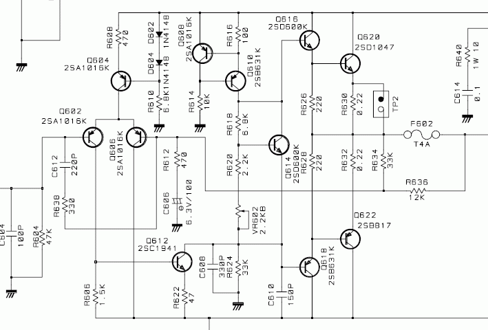

The schematic i have posted is wrong
Also the PNP driver has colector inverted related the emitter.

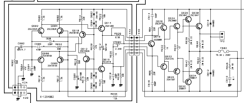

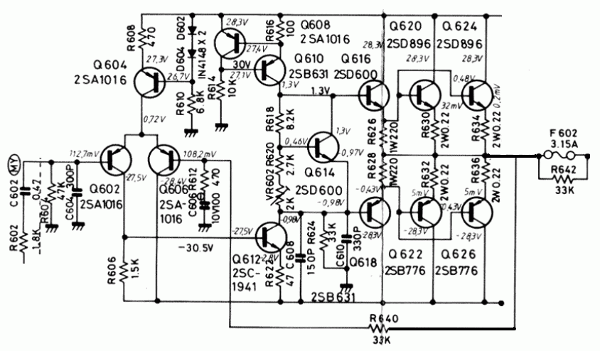

yo will notice that in the three schematics you published,
they use a shunt compensation on the vas collector ,
and no classic cdom..
regards,
wahab

right, and they tried to keep the same "sonic signature" , in
carlos s words...
the first two schematics are classical LIN topologies, i.e, simple differential,
and the third is a symetrical differential...
not only they use a shunted vas collector compensation,
they also reduce the open loop gain of the vas with 33k
resistors from collectors to ground, and this, in the
three schematics again..

I have simulated , and result was good
0.015% at 20 watts (THD)....fourier analisis fine too...standard and very common results....nothing extraordinary and nothing bad too.
0.03% at 30 watts.
About the sound....welll, only listening the unit or building.
Building always result better than the original, because you will not have pre amplifier, switches and tone controls.
I have downloaded several service manuals, different models, and the amplifier seems to be excellent.
regards,
Carlos
