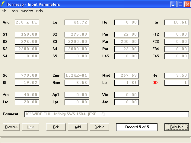

One thing that I'm exploring is whether front loaded horns have more 'impact' than THs and BLHs. I've read this on forums, so I'm building a FLH with a TC Sounds eight to find out. The Alpine 15" would make a great candidate for a big FLH. In fact, it's probably better suited for a FLH than a TH, unless you need ultra low LFE (which you might, depends on application.)
When I first started experimenting with Hornresp, I found it amusing to substitute different drivers in existing designs to see how well they worked. I had tried a lot of the Alpine and Infinity "auto sound" subwoofers, and got some funky response curves - which I now realize that the designs I substituted them into were really optimized for a higher Fs driver.
But your comment above that the Alpine 15" may be better suited for a FLH instead of a TH spurred me to try a new idea over the weekend. Go ahead and laugh, but here is my first attempt at a FLH. I didn't put a lot of thought into it, just played around with the "Loudspeaker Wizard" until I got something that didn't look too ugly. I would appreciate you thoughts on this. Thanks.

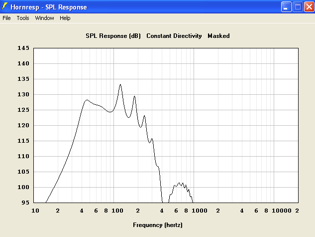

Fifteens need a big box; so using the same parameters there wasn't a whole lot I could do. But on the upside you can't do a lot better in this footprint!
Enlarging the back chamber extends the low bass a bit, reduces that low frequency peak, but at the expense of a bit higher displacement. But with a highpass at 30hz you won't hit it excursion limits. Without a highpass you'll exceed them by a single millimeter, which probably won't do anything to a driver with an xmech of 70mm.
Move the highpass to 40hz and you could probably double the power handling.
DHAA, you want the response shape of a FLH to slope the other direction generally, because FLHs exhibit a unique trait, when you add more cabs to the stack (or wall/corner load) the low frequency droop is "filled in".

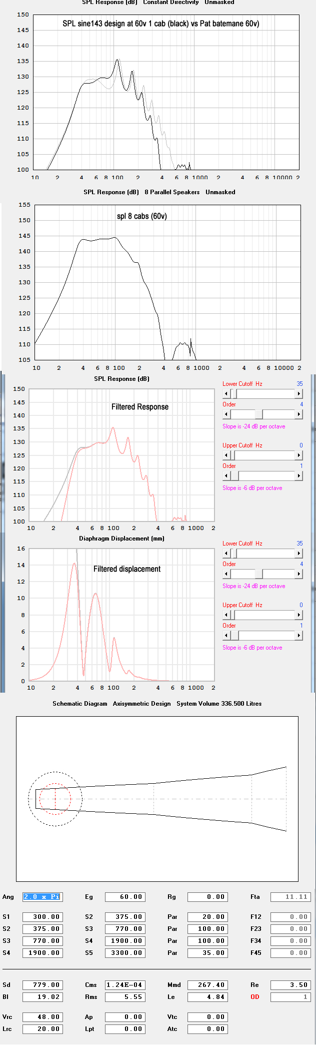

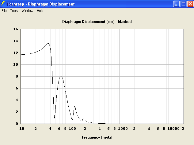

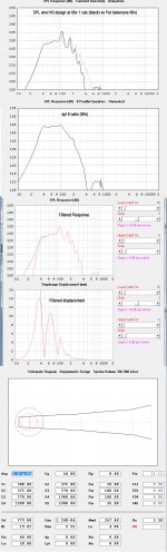

Heres my take on the driver keeping with the 340 liter parameter. as you can see in the picture, it will take about 60v before exceeding xmax (35hz filter for 1 cab, 30hz filter for 4 or more cabs). I've shown the response for 1 cab (standard FLH "rising response" as freq increases), and 8 cabs (pretty darn flat)
The Alpine seems to like a lower compression ratio (helps fill in the 70 to 100 range).
this is a quick 10 min sim.
however, givin 340 liters, you can get within a db of this sim with the lab12 driver with 300 watts per box (45volts) (vs the almost 1000 per box the alpine will take)

You can tell by comparison-sine143's sim using a lower compression ratio than Bateman's (or yours) has a smoother response in the 70-100 Hz range, but a slight reduction in the low frequency.How can you tell that - is there a particular TS spec. you are looking at?
Yeah, pretty much just trial and error. with a higher compression ratio it was basically impossible to fill in that gap in the 70 to 100 range, and as you saw, it required a slightly larger rear chamber (as per PBs sim). with a lower compression ratio and a slightly smaller rear chamber I was able to fill that section in (significantly I might add) and only sacrifice about a db of sensitivity down low (Which is compensated for as soon as you add multiple cabs, considering the mouth on my horn is larger than those on yours or patricks).

Throat area [St] is a compromise between the driver's motor strength [Qes] Vs a speaker's desired HF corner [Fhc] and the driver's compliance [Vas], which few folks adhere to except by coincidence, so in theory won't perform optimally no matter how closely its measurements mirror the sim.
In comparing folk's measurements to the sims though, it became obvious that a TH tends to 'bend' a driver's specs to its 'will' even more so than a FLH, so in its own way seems as 'forgiving' of a specs misalignment as a sealed one and much more so with increasing power.
From this I concluded that for HIFI/HT apps we probably should be designing based on desired mean applied power rather than max power [SPL], which can significantly reduce net cab Vb, allowing smaller/cheaper driver multiple subs for more optimal placement and/or better WAF for those afflicted.

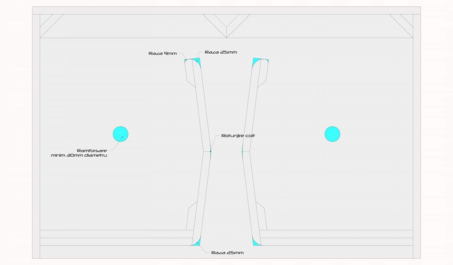

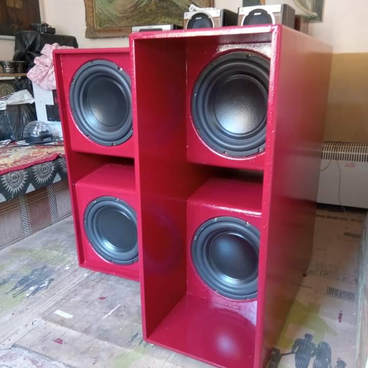

They Keystone Sub este un tip mare (45" înălțime x 26,5" lățime x 22,5" adâncime), dar încărcat cu două Lab12-uri merge joasă și tare. Aceasta este cursa gri din graficul de mai jos.

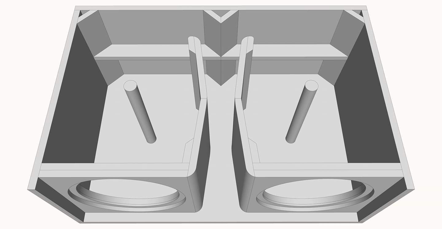

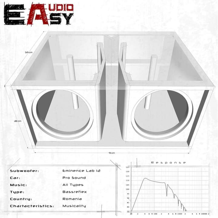

În celălalt colț avem designul bass reflex weltersys Dual Lab12 :
SUBPLAN GRATUIT: Dual Lab12 (încărcat frontal) de la Welter Systems

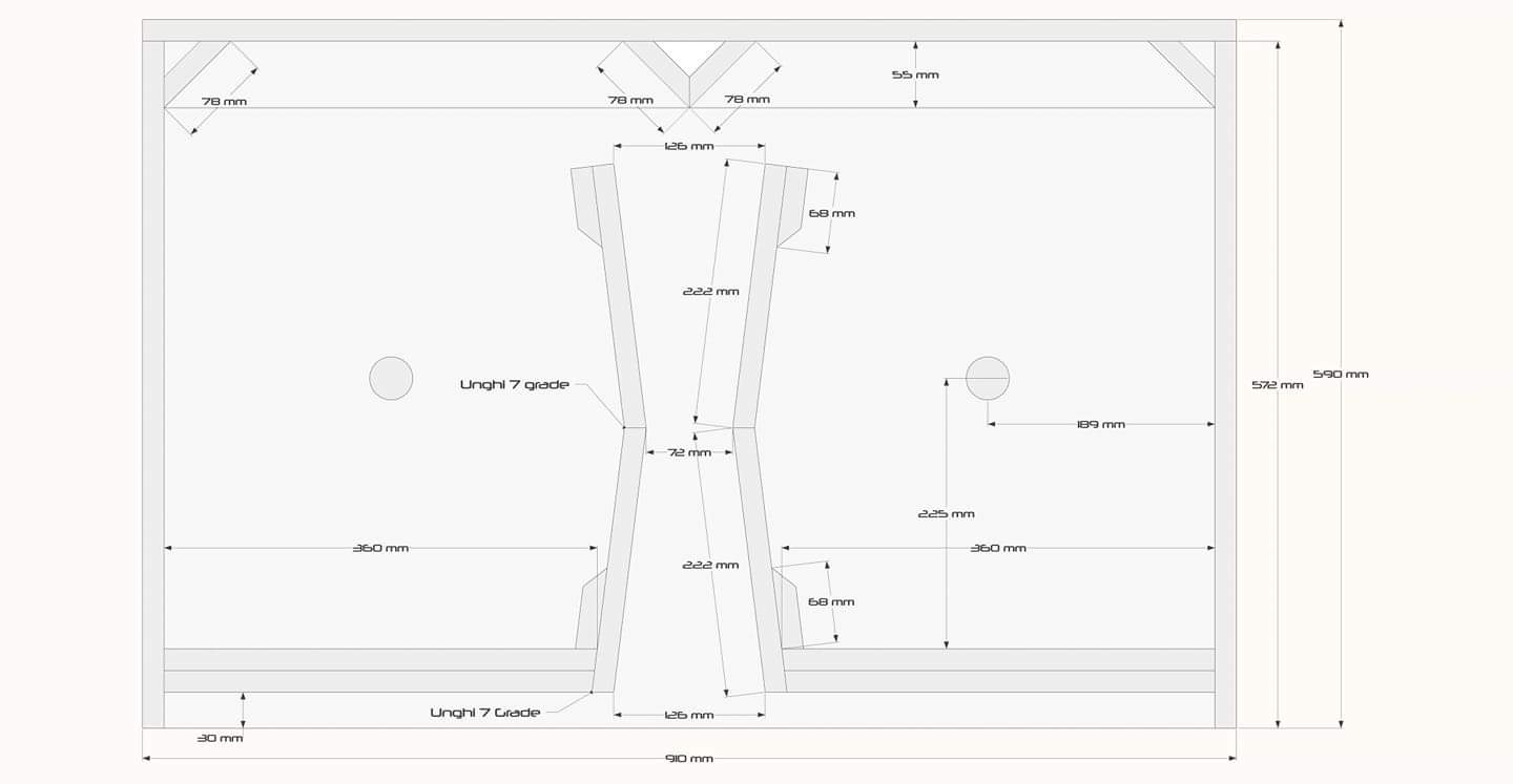

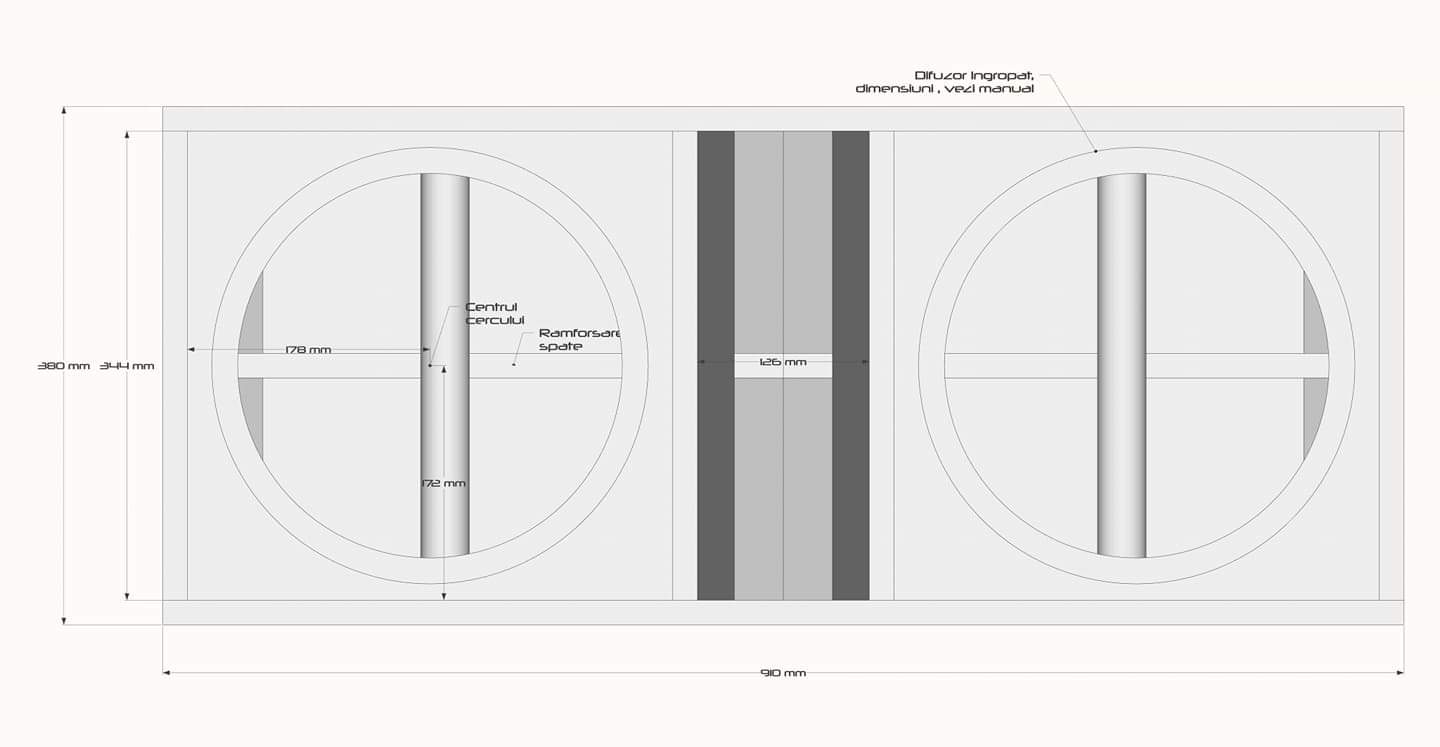

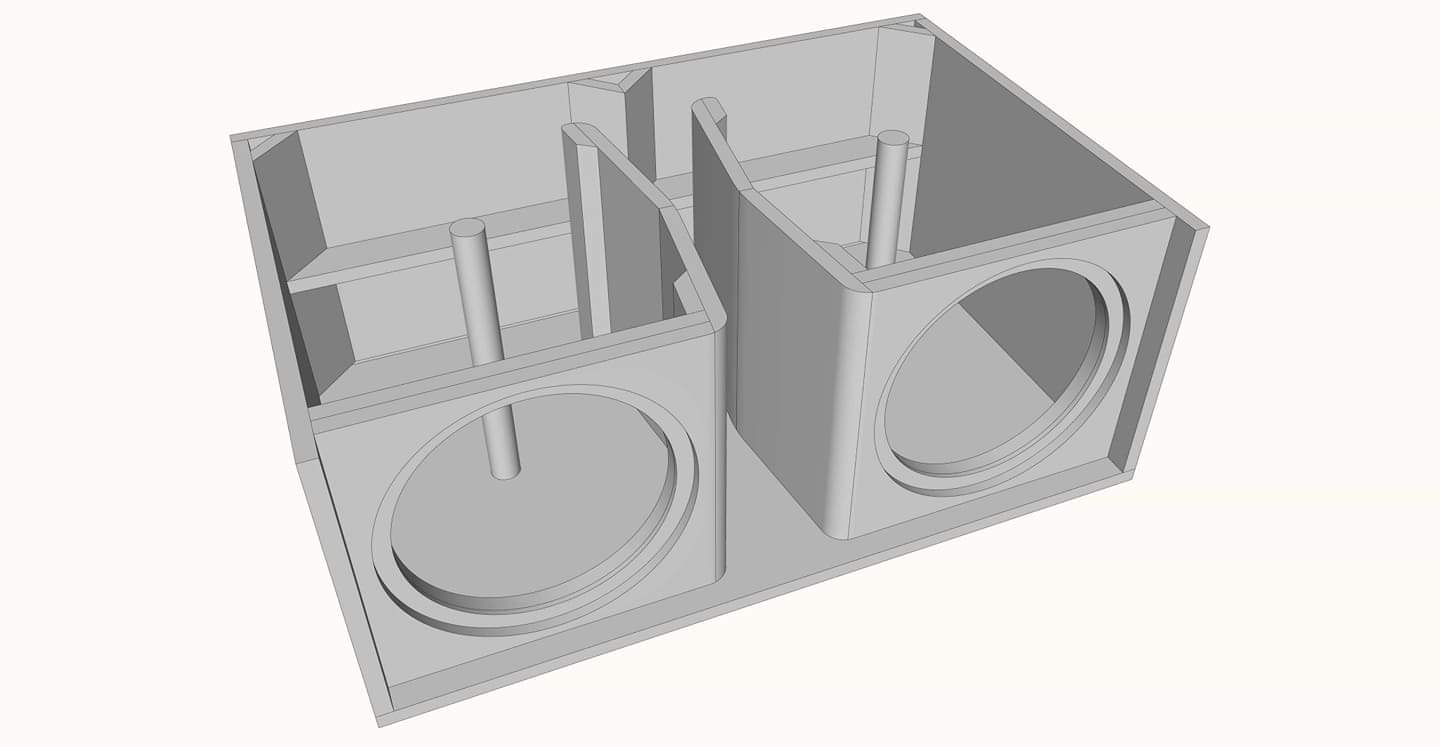

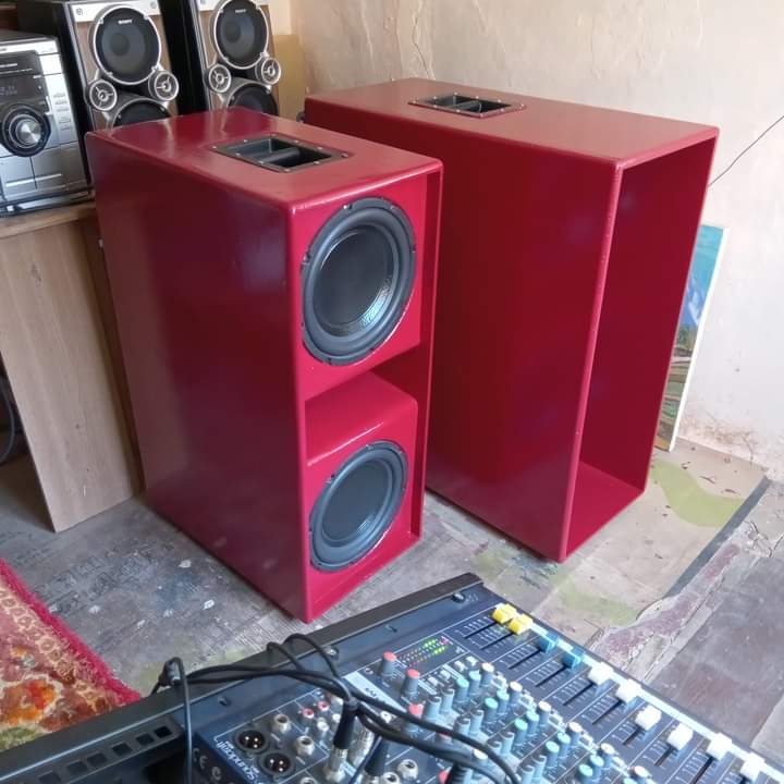

Dual Lab12 este un tip micuț (22,5" înălțime x 26,5" lățime x 22,5" adâncime) - jumătate din dimensiunea Keystone Sub. Merge la fel de jos ca Keystone, dar nu la fel de tare. Aceasta este urma albastră de pe graficul de mai jos.
It is a plan tuned to 35hz created for PRO AUDIO applications with GOOD EXTENSION, and a better load on the speakers in the peak impedance given by the enclosure, that is why the port is flared at the ends and narrowed in the middle. I recommend it with confidence because it sits very strong and deep with very good extension.

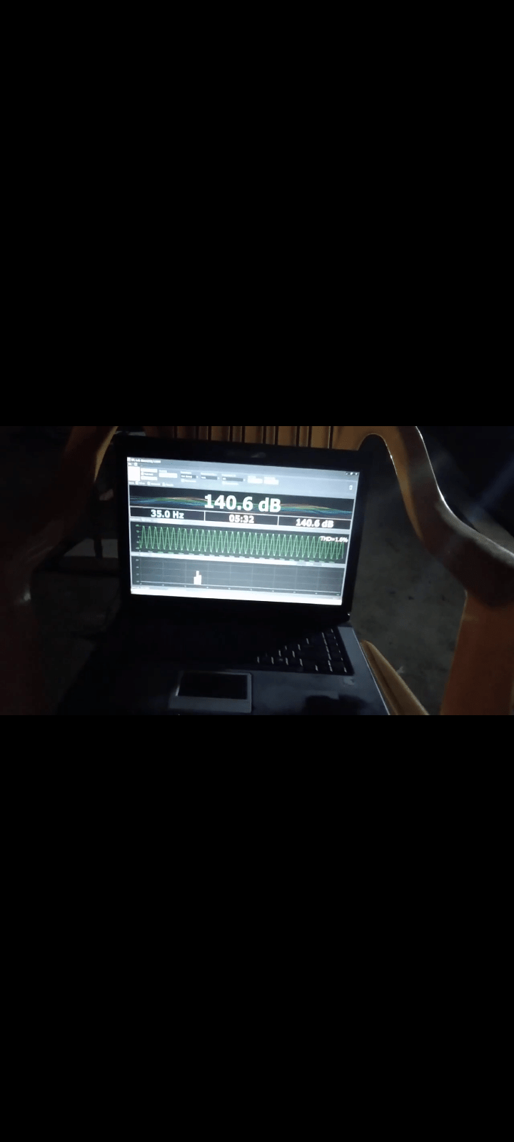

Aici atașez un clip cu niște măsurători.
Am măsurat cu un microfon RTA SPL LAB PRO.
Deci, dacă ai avea nevoie de un subwoofer care să fie foarte scăzut și să se încarce, pe care dintre aceste modele ai construi și DE CE? Care sunt avantajele/dezavantajele pe care le vedeți la fiecare design.
Să păstrăm lucrurile civile. Personal cred că acestea sunt ambele modele excelente - unul dintre cele mai mari argumente ale mele ar fi dimensiunea și portabilitatea.
Here you have a clip with measurements in the 35-60 hz band, the margin of error is 10 dB, because I measured with another sensor in the software, I don't know why it went like that, from the obtained value, subtract 10 and get the continuous spl.Thank you very much for accepting!

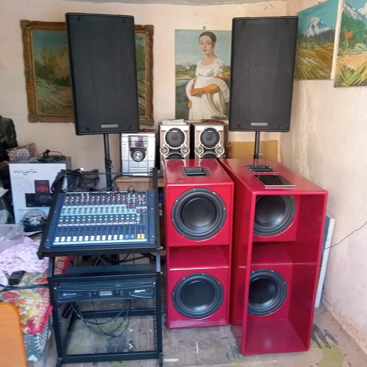

View attachment 1121118View attachment 1121119View attachment 1121120View attachment 1121121View attachment 1121122View attachment 1121123I'm opening this thread to introduce my double LAB 12.
Am măsurat cu un microfon RTA SPL LAB PRO.View attachment 1121124
Amplification was crown xls 1502:
2x775 w rms 2 ohms
2x525 w rms 4 ohms
2x300 w rms 8 ohms
I had about 517 w rms in 3 ohms. The signal on the crown was about -20 dB, giving the gain from the mixer until around 11 o'clock because of the usb mp3 player which has a very bad signal and I had to increase the gain from the mixer to get those values.
That's a pretty neat-looking design. I don't often see vented designs with butterfly / rocket ports here, even though that type of vent is supposed to produce great results at higher power levels. The frequency response curve - is that predicted or actual? Looks like it might have been generated in Hornresp...
Yes, in horn response, the sensitivity is in a quarter of the space at 2w/mThat's a pretty neat-looking design. I don't often see vented designs with butterfly / rocket ports here, even though that type of vent is supposed to produce great results at higher power levels. The frequency response curve - is that predicted or actual? Looks like it might have been generated in Hornresp...
