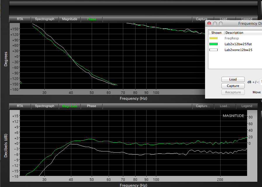

Here you have a clip with measurements in the 35-60 hz band, the margin of error is 10 dB, because I measured with another sensor in the software, I don't know why it went like that, from the obtained value, subtract 10 and get the continuous spl.Thank you very much for accepting!
View attachment 1121118 View attachment 1121119 View attachment 1121120 View attachment 1121121 View attachment 1121122 View attachment 1121123 I'm opening this thread to introduce my double LAB 12.
It is a plan tuned to 35hz created for PRO AUDIO applications with GOOD EXTENSION, and a better load on the speakers in the peak impedance given by the enclosure, that is why the port is flared at the ends and narrowed in the middle. I recommend it with confidence because it sits very strong and deep with very good extension.
Aici atașez un clip cu niște măsurători.
Am măsurat cu un microfon RTA SPL LAB PRO. View attachment 1121124
Amplification was crown xls 1502:
2x775 w rms 2 ohms
2x525 w rms 4 ohms
2x300 w rms 8 ohms
I had about 517 w rms in 3 ohms. The signal on the crown was about -20 dB, giving the gain from the mixer until around 11 o'clock because of the usb mp3 player which has a very bad signal and I had to increase the gain from the mixer to get those values.
