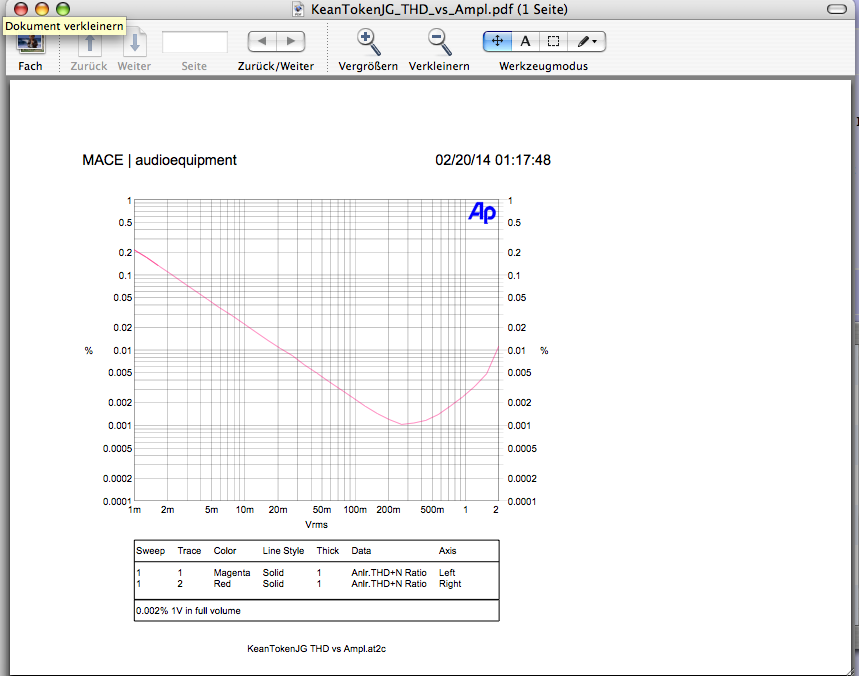

Ricardo, when you see the distortion measurements we made on the Kean buffer i build ( TKD pot, no distortion trim ) it has minimum distortion at 200mV. Advancing the volume the distortion rises.
Both channels show the same THD and spectrum, so it may have to do with the pot or the batch of transistors used. I used

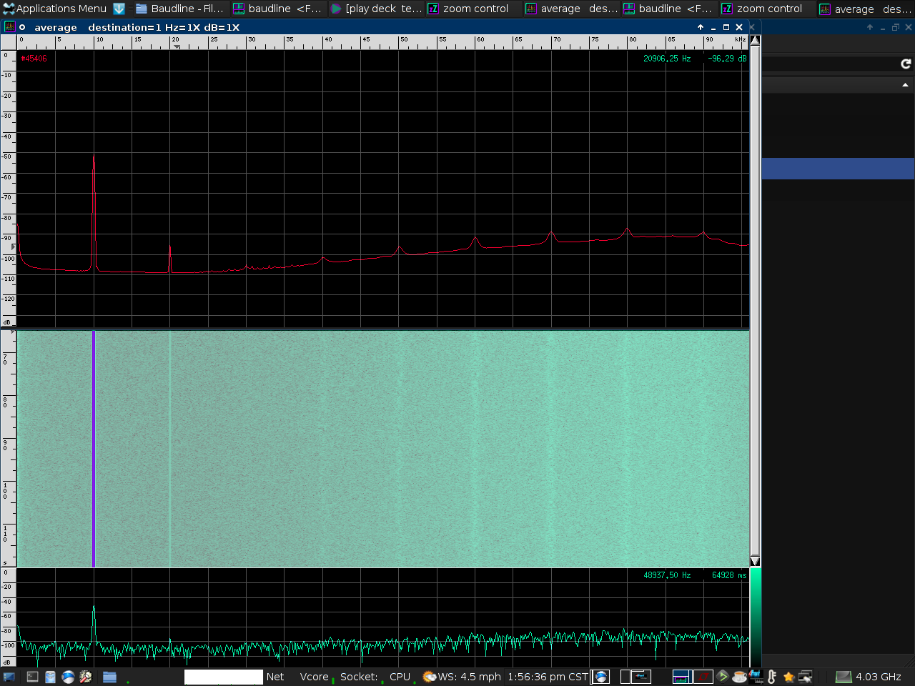

I have a 2-minute 10KHz sine wave measurement I could send by email, but it's a large file.
Here is an image of those 2 minutes averaged in an FFT. The 2nd harmonic can't be measured, and the 3rd harmonics could easily be spectral noise. The Kuartlotron input is subtracted from the output, which is why the fundamental is low.
I don't know what the impedance of my soundcard is, but I suspect it's not very high.

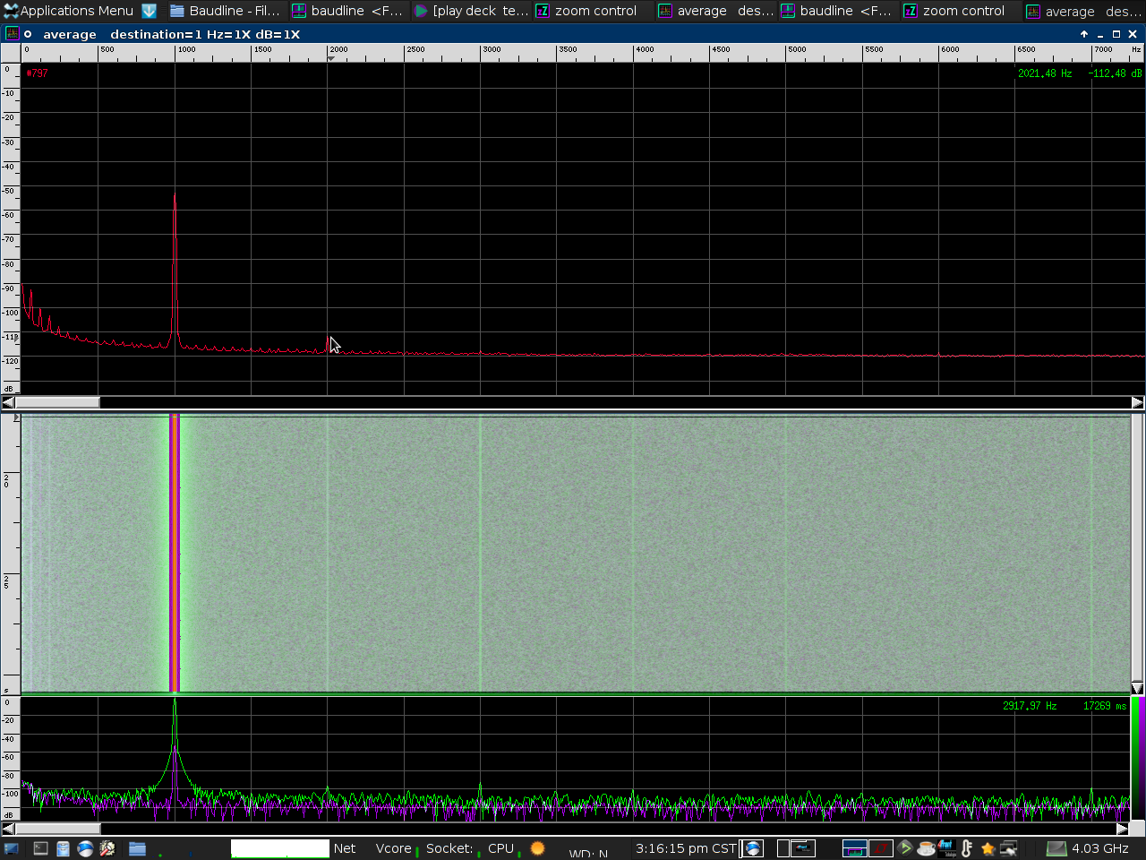

Okay, I figured out how to get the lowest noise floor on my soundcard. I also made a mistake in calculating THD. H2 is at -96db, so THD is about .0016%. This is at 1V pk-pk input.
While this measurement is more than I've gotten in the past, it's pretty good considering that my Kuartlotron as it's running right now is out of trim because I had to use a higher voltage supply. It may be able to lower it by trimming.

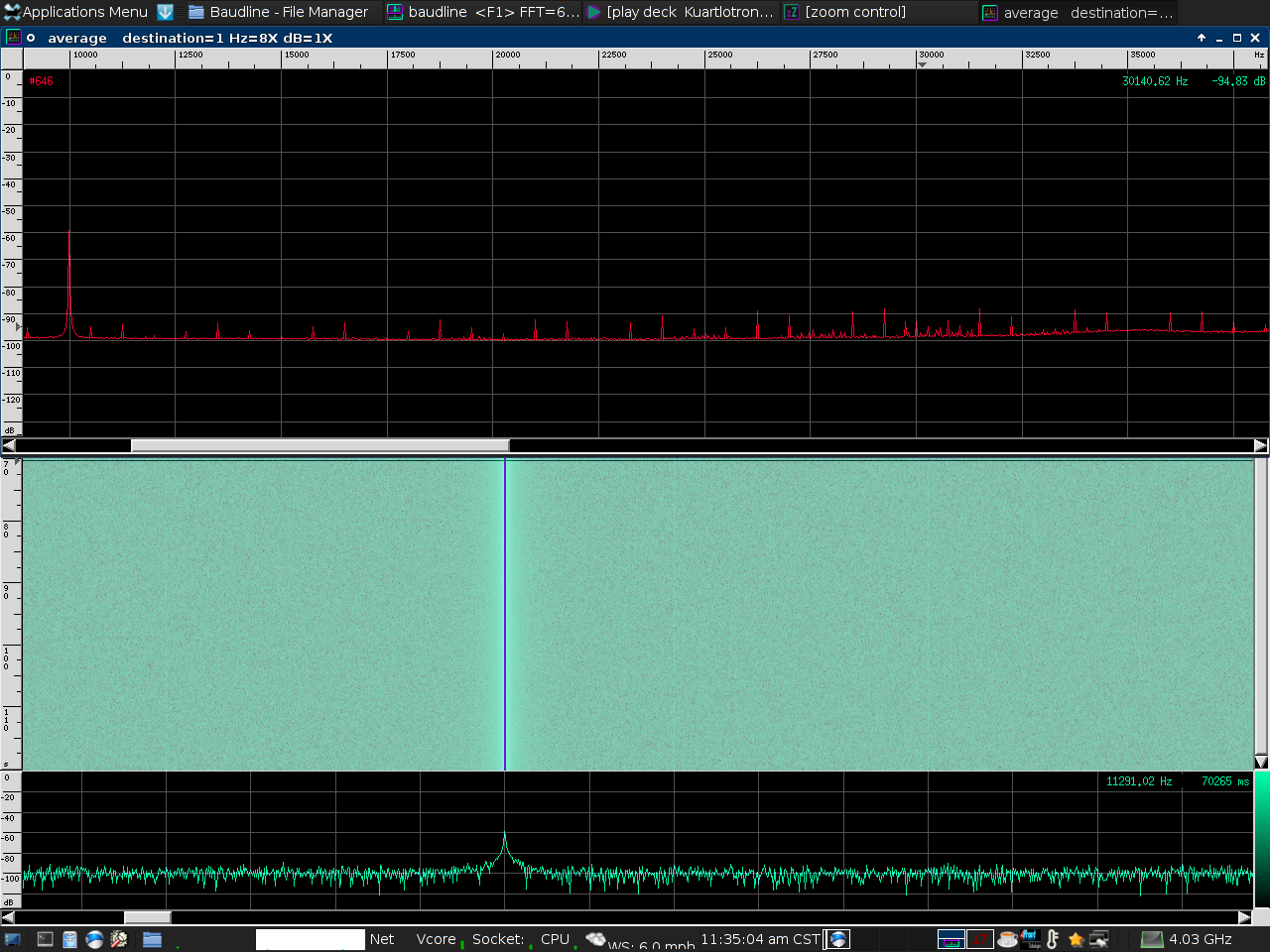

Still, for those who want to know, here is the FFT after trimming. H2 is at -112db. That is 0.0002%THD at 1V pk-pk input!
So, without trimming you can expect THD around .001-.003%, and after trimming you can expect THD down to .0002%. That matches the simulation very well. I think the path forwards from here is not necessarily to lower THD, but to design the circuit so that it gets lower non-trimmed distortion.
Here's what I did:
1: My power supply is +-12.18V.
2: Adjust R5 so that TP is at 5.9V.
3: Adjust R1 for best THD null, watchingt TP for reference.
4: TP ended up at 4.85V at the optimal trim point.
5: Your trimming results may vary.
