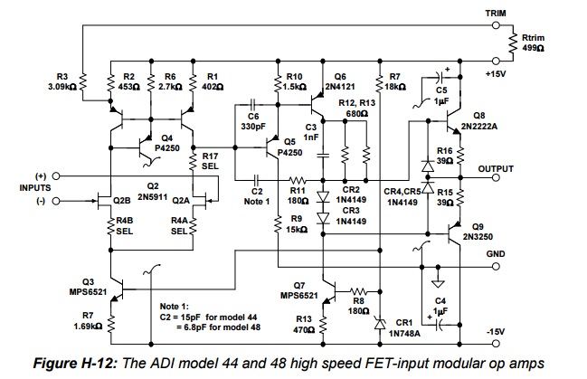

Doug, the guys in my dorm (~1970) were buying the "new" TIP power devices to build essentially the op-amp on steroids style power amp. The pic below (circa 1969 original design) was a modular one that did 100V/usec and if fed some steroids would make a decent PA I'll bet. I'll ask around but unfortunately many involved have passed on.

Might well, but as it stands it's just an opamp... R8 will give some of the slew-reducing effect described in APAD6- the current-source base needs to be firmly held at a low impedance to prevent transients feeding through its Cbc and reducing the current.

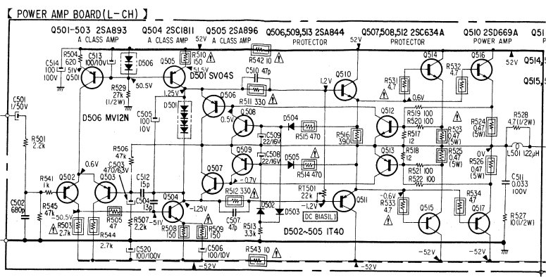

That's not a "blameless". That turned into your typical 1970's Japanese
amplifier. 75' Sansui (below 1).
They kept using the design into the 80's , digital receivers .... (Z5900)
Good design , the two I repaired still worked after 40 years.
Me and another member ported this to a forum design - 20ppm/-120db PSRR.
(below 2) is the classic Sony STR series.
Has the LTP in 69' , by the early 70's they added beta enhancement ....
pretty much a modern "blameless" by 73'.
The Japanese were way ahead of anybody in the late 60's - 70's !!
