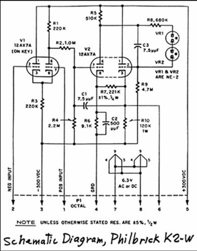

I actually have one. 😀 was at one time (may still be) in the original box!
Grey plastic base, two dual triodes, iirc. 😀
_-_-
I've got a box of them. The gray one is actually from a competitor. The original ones are beige/yellowish and cannot be opened. The gray ones have srews and can be opened.

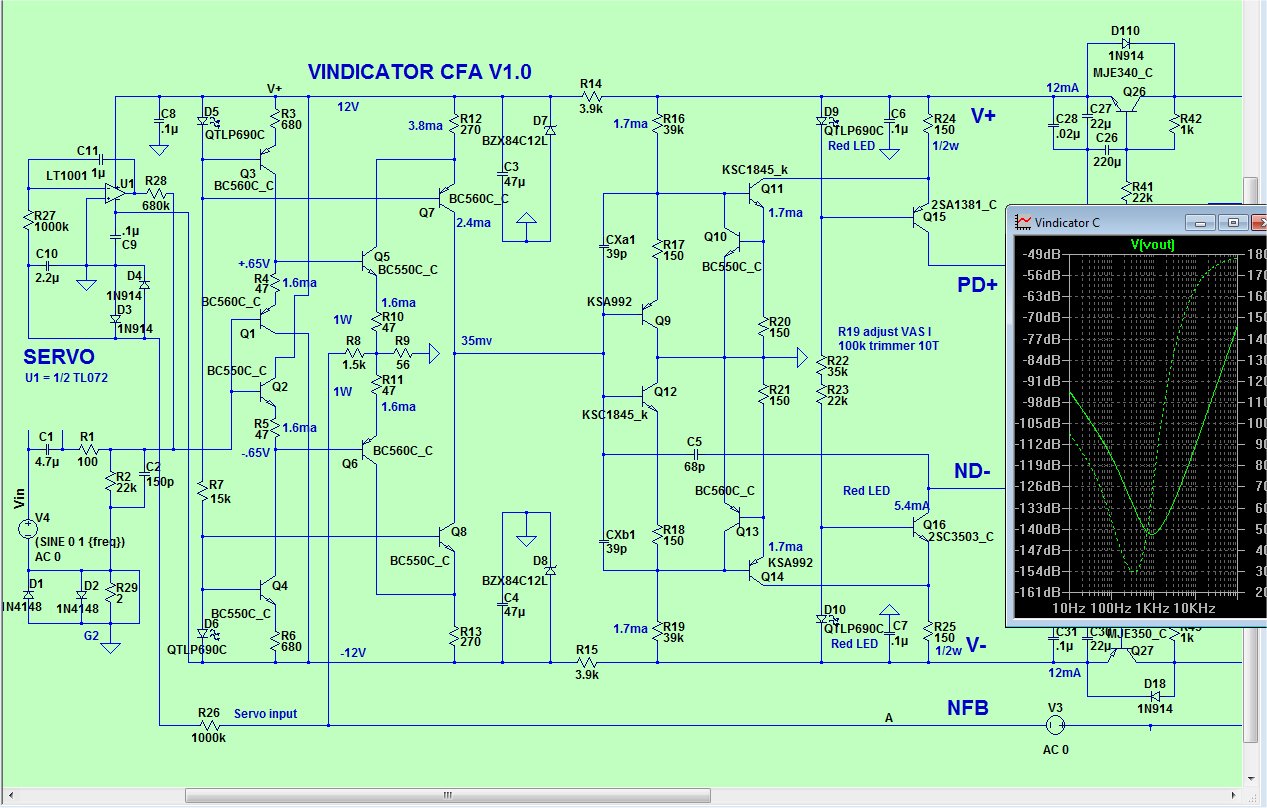

Nope , Member Vzaichenko uses the single ended folded cascode approach
with current sources.
Of course , I went with a fully symmetric design (I am sold on those).
I mixed a folded cascode CFA front end with Sam Groner's - TIS (folded transimpedance stage).
A new audio amplifier topology with push-pull transimpedance stage - Part 1: Introduction | EE Times
By Vzaichenko's success on the "simpler" input stage , the
CFA/symmetric should be pretty good (Below).

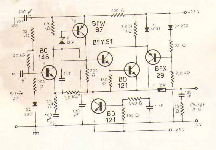

This is the first folded cascode used in audio I met :
[FONT=arial,helvetica]High-quality Tone ControlJ N EllisAug 1973 p378
[/FONT]

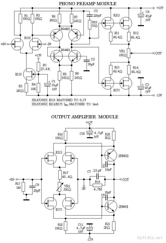

Do you refer to the "Output amplifier circuit" of the schematics below ?
The bipolar transistors do not work to make folded cascodes with the input stage.
no, I referred to John Curl's "original" phono headamp (iirc) design, not sure if the folded cascode was used in the line stage or not. Perhaps I am not understanding which reference was which or whose it is/was??
