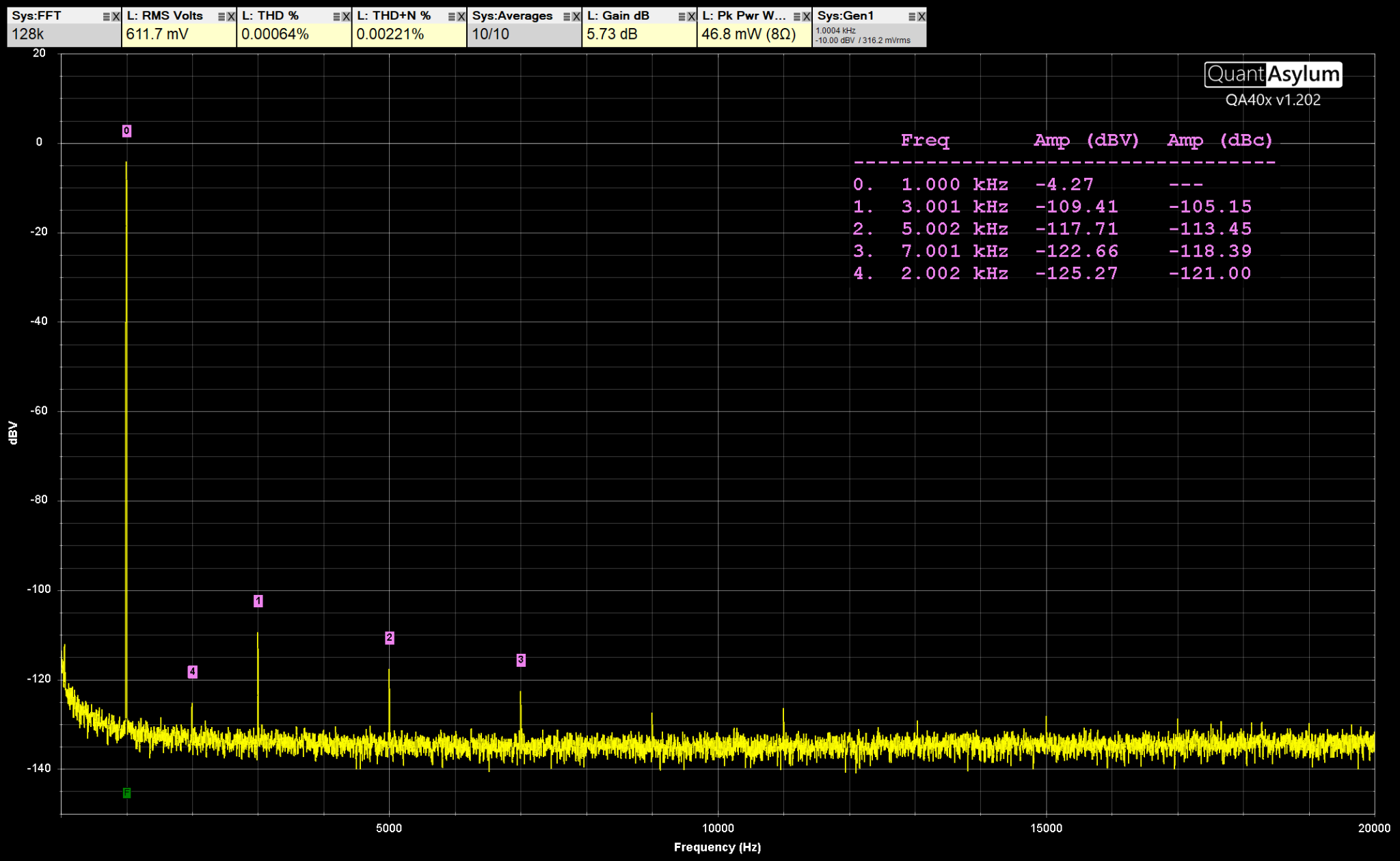

Seems to be an odd order dominant harmonic profile.
The full-bridge output stage design significantly reduces even-order distortion.
Theoretically, both fixed-frequency and self-oscillating Class D modulation methods are not inherently distortion-free (as demonstrated in my earlier simulation results). Without applying PFFB, increasing the operating frequency is a crucial approach to reducing distortion.
Another takeaway from the measurement is that the LC filter, particularly the inductor, does not introduce significant distortion if it is well-designed.

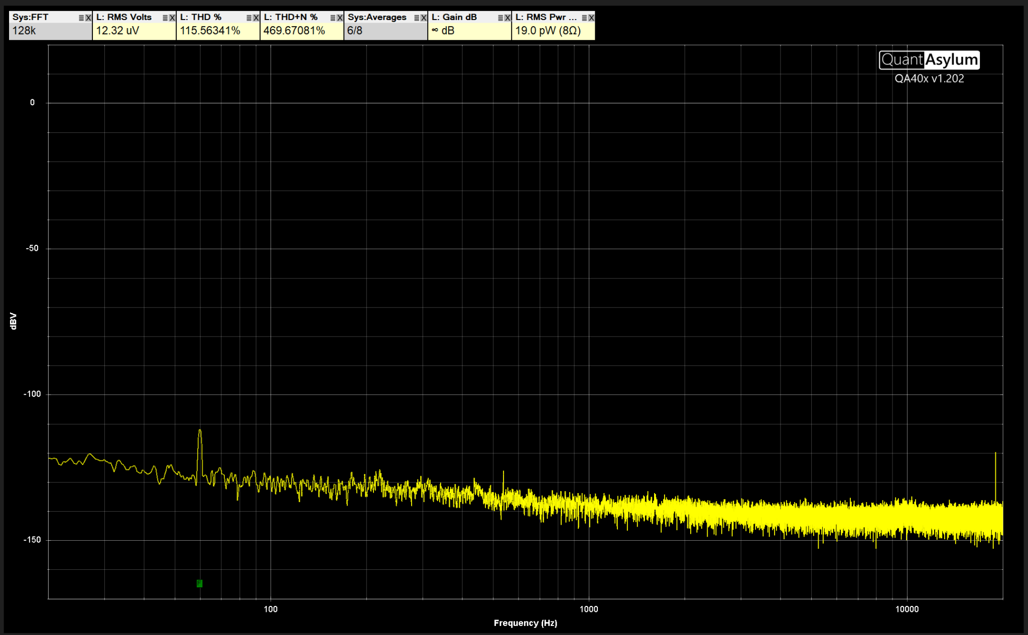

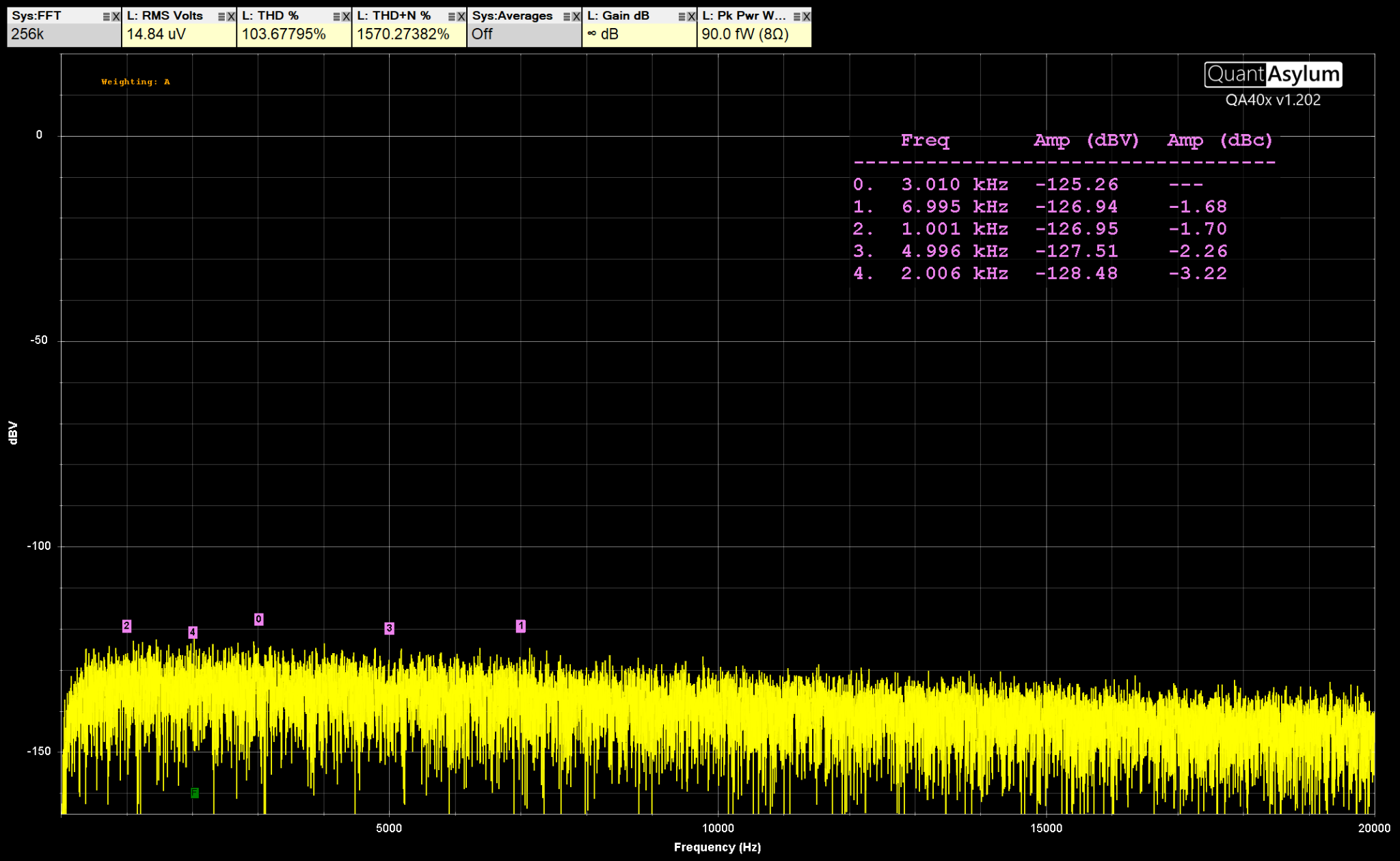

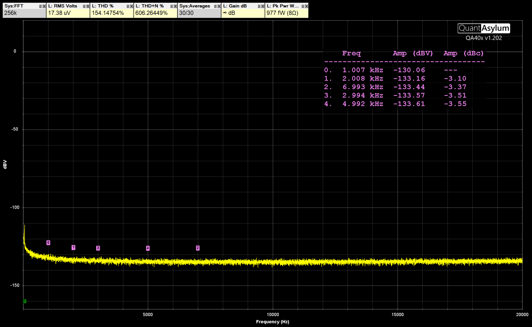

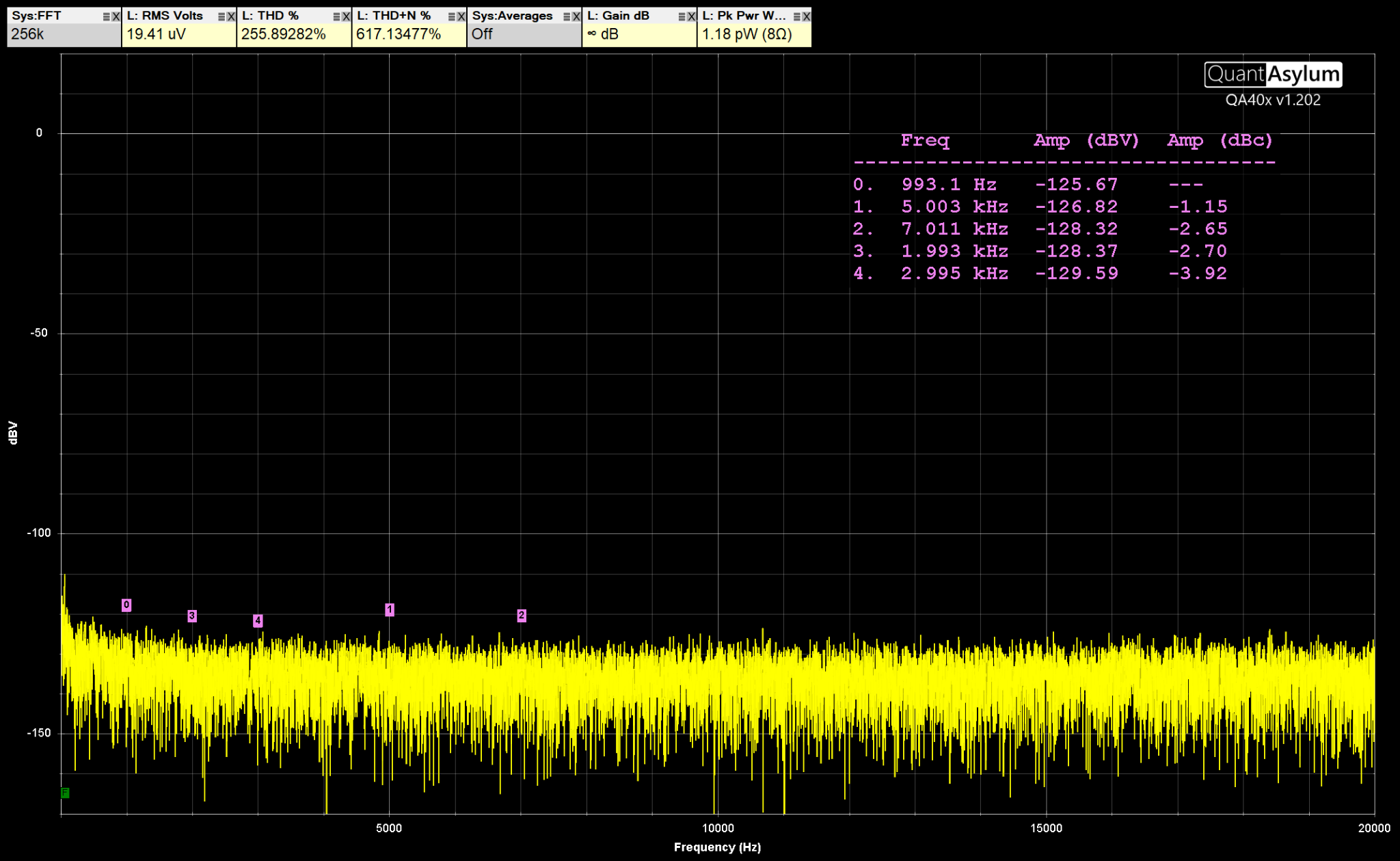

After adjusting the circuit component values, the background noise (A weighted) has been reduced from the original 17 µV to 14.8 µV, with a noise density of approximately -135 dBV. The distortion has also been reduced to some extent. I believe there is still room for further optimization, and I am looking forward to it.

You need a very high resolution FFT. Like maybe 4-million points, say, with maybe a 1kHz digital test signal. What does it look like plus or minus a few Hz from 1kHz, if expanded out and looking down near the noise floor? IOW, the skirts are part of one spectral line down near the noise floor. How wide is the base of one spectral line?
You should look at the FFT settings used in the examples at the link I posted above.
How about we just see what it looks like first, then if it doesn't look as good as you would like maybe we could figure out the contribution of each possible source? Otherwise how will you ever know how you are doing in that particular area of design quality? You might be able tell in listening tests, but first you would need a way to change the skirts enough to make the change audible. Then you can know what a change sounds like.

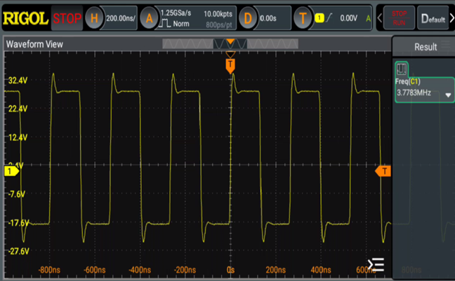

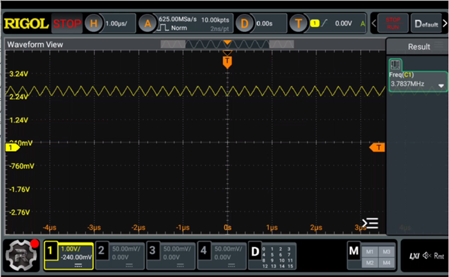

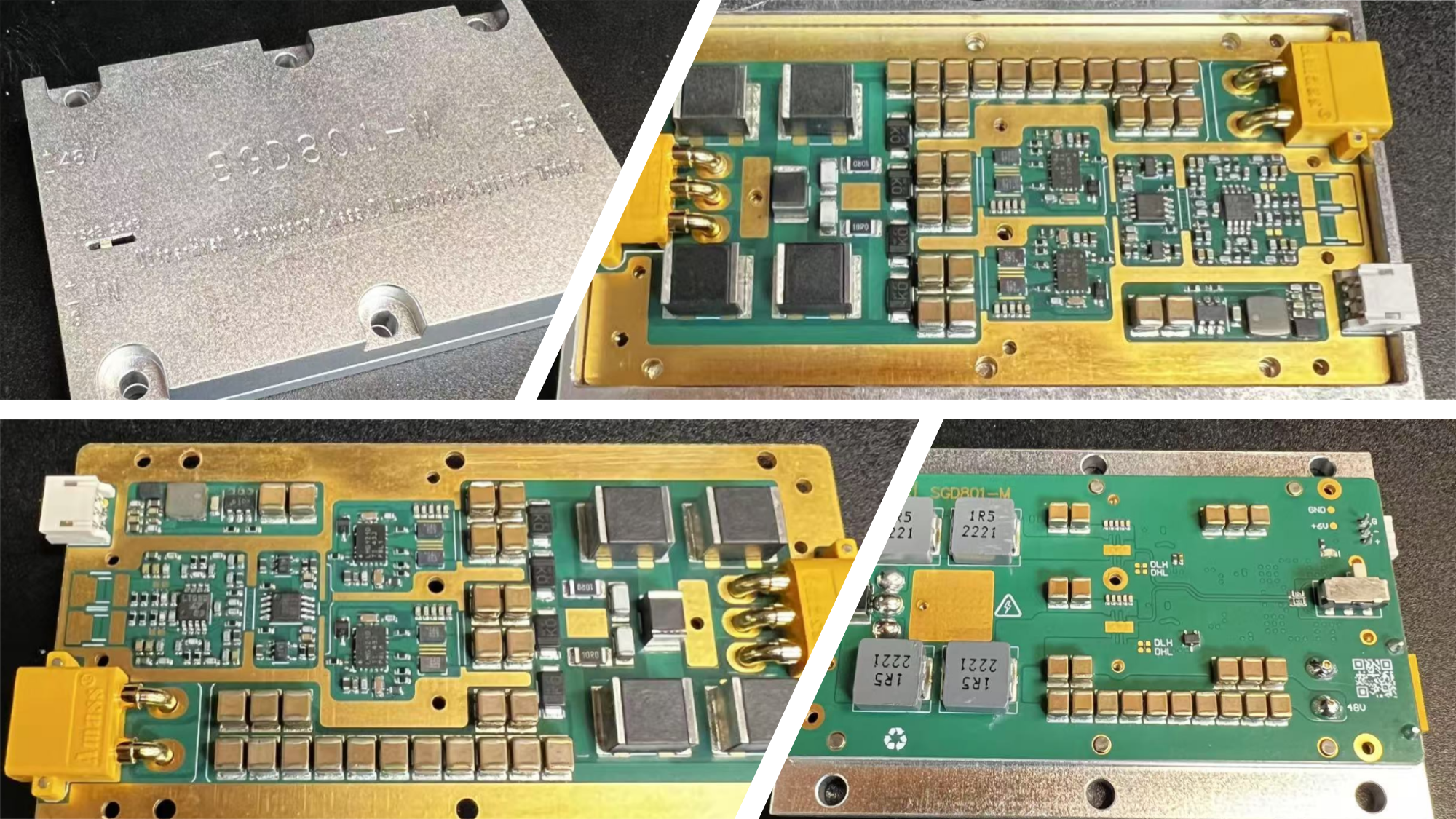

The first board is brought up, the operation frequency is 3.78MHz, the idle power is about 19W.
The oscillation wave is shown below.

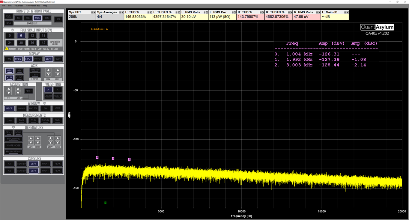

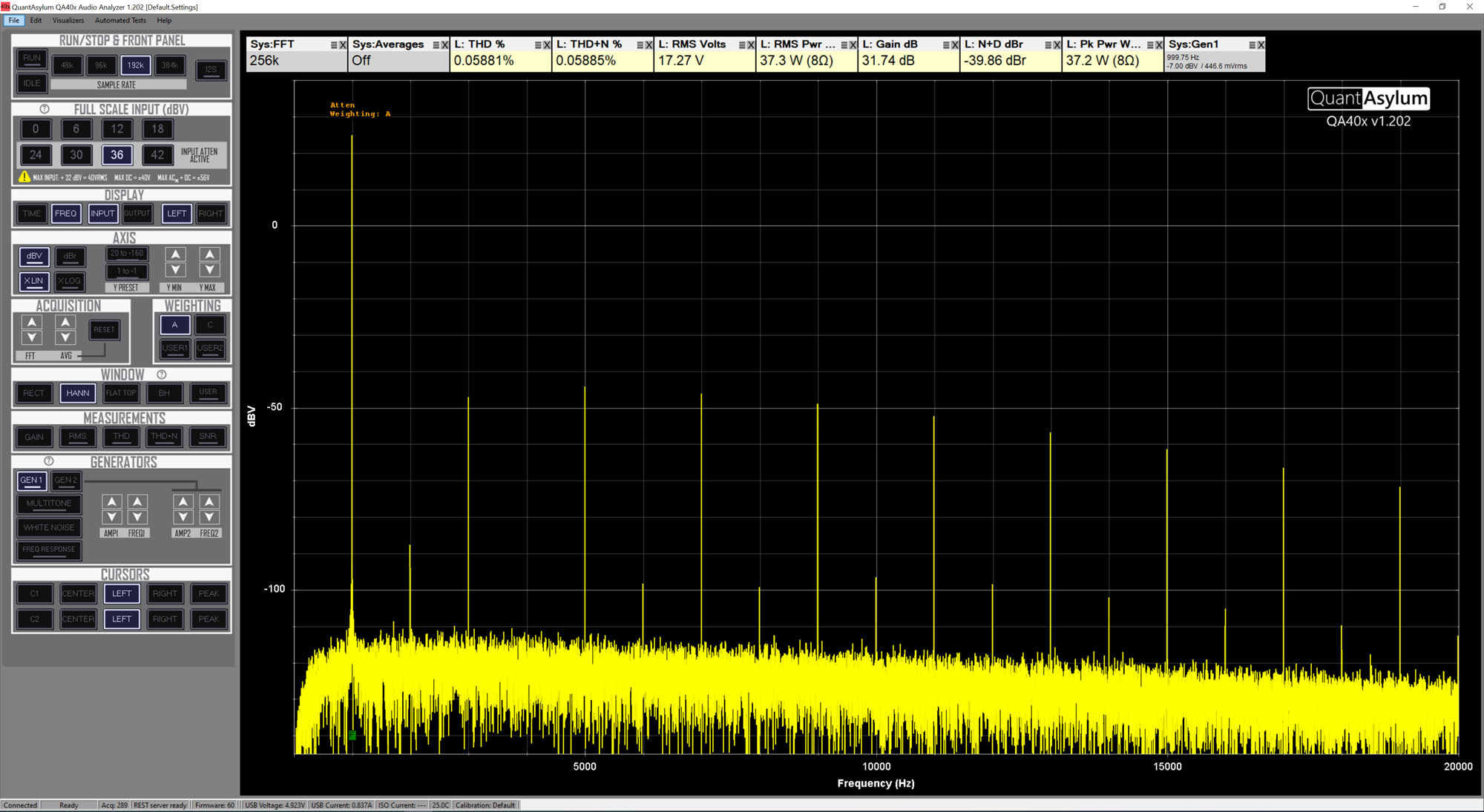

the background noise is 30uV (13dB), 50uV (26dB).

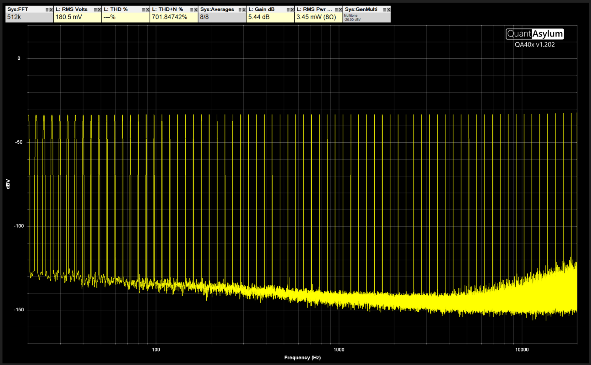

multitone test looks very good.

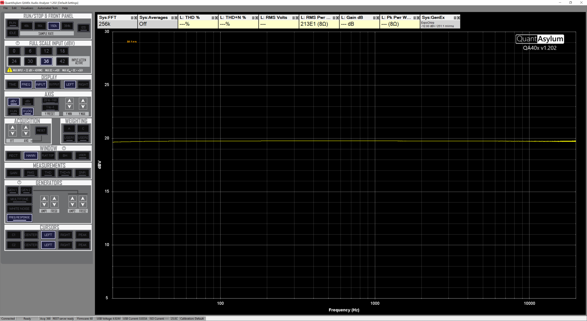

frequency respond is very flat.

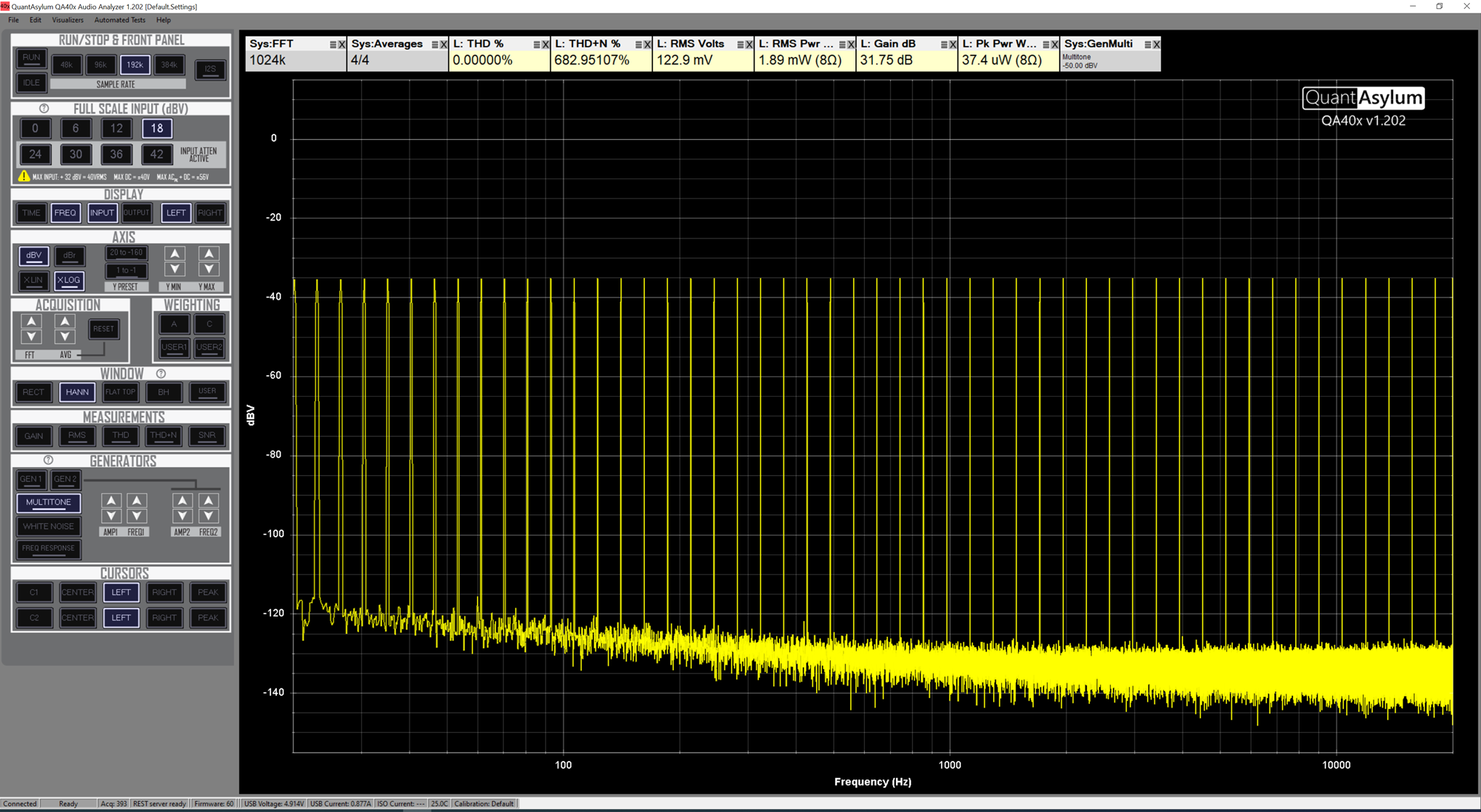

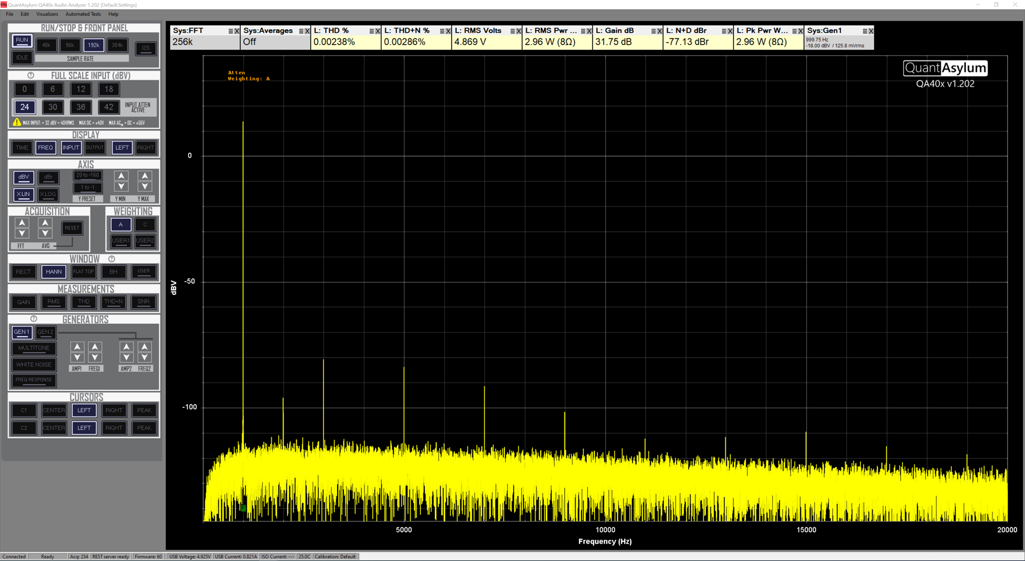

THD+N is about 0.0028% @ 3W 8Ohm.

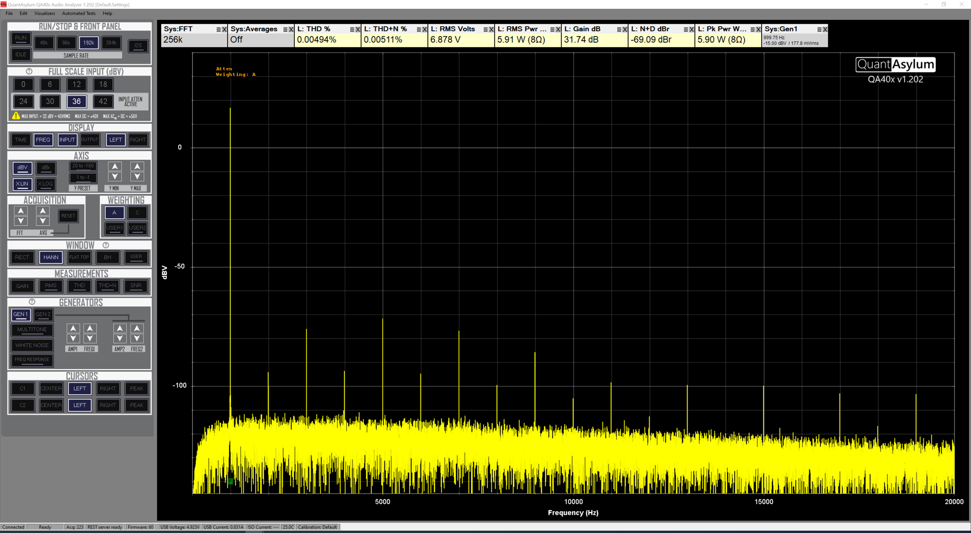

THD+N: 0.005% @6W 8Ohm

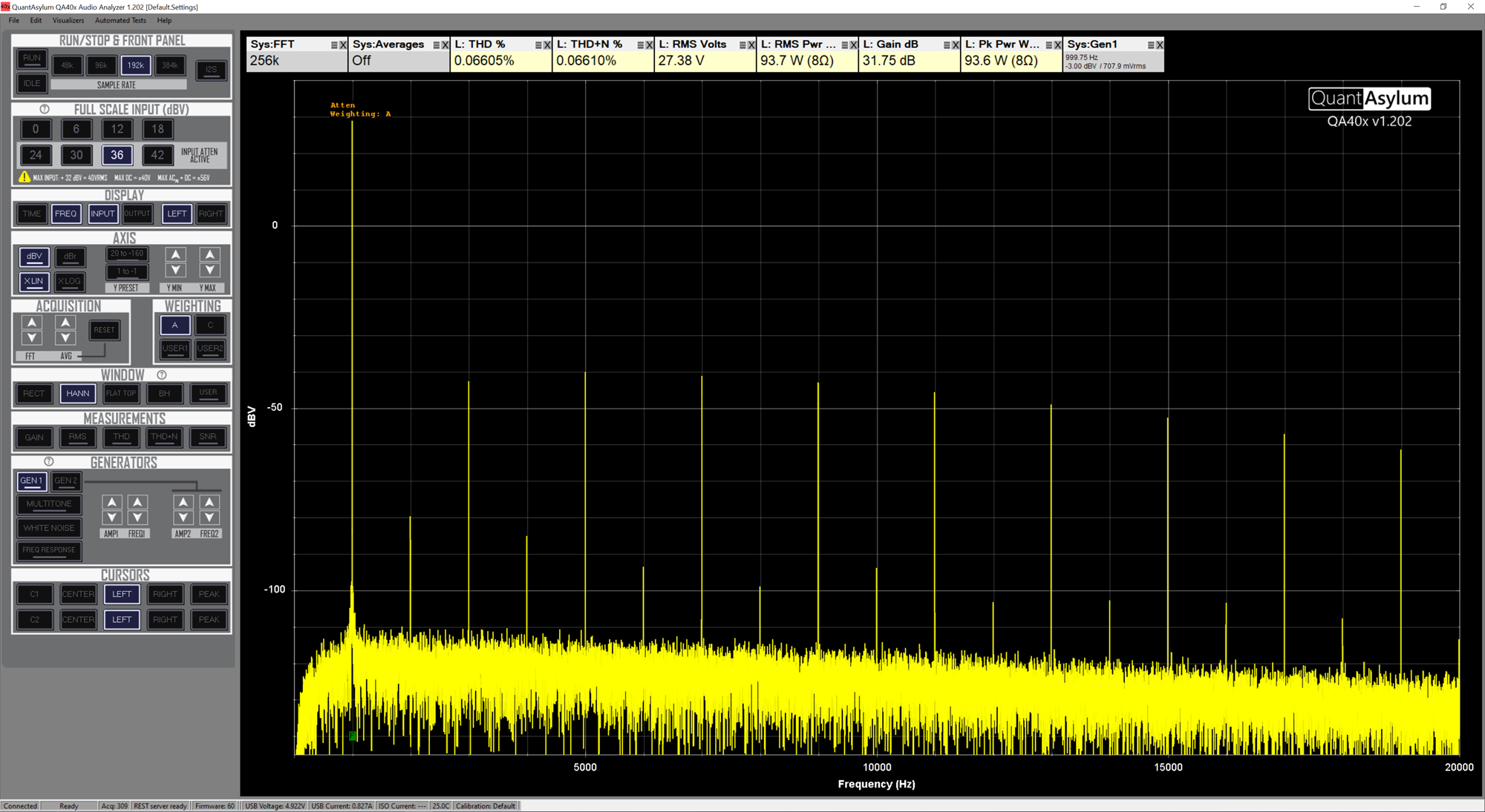

THD+N: 0.058% @37W 8Ohm
THD+N: 0.066% @93.7W 8Ohm
Do you know what causes the increased distortion at higher power levels?
I assume its from the power supply?
Maybe you could measure the ripple on the power at heavy load?
This is a preliminary test result. The test was conducted by measuring directly from the load. Generally, Class D amplifier testing should be performed through an additional anti-aliasing filter to further suppress out-of-band noise and effects, thereby reducing their mirror-image influence on the in-band signal. The power supply used for the test was a 600W switching power supply, which may have larger ripple compared to a typical linear power supply. If the transient response of the switching power supply is suboptimal, it can indeed increase harmonics during high-power output.
Overall, this test result should be considered the worst-case scenario. Objectively speaking, considering the absence of PFFB and front-end negative feedback like that used in the TPA3225, I am still quite satisfied with the result.
