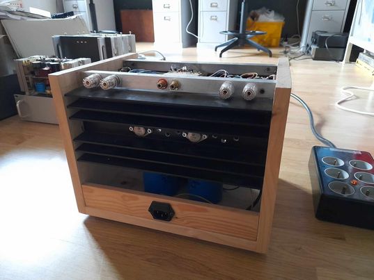

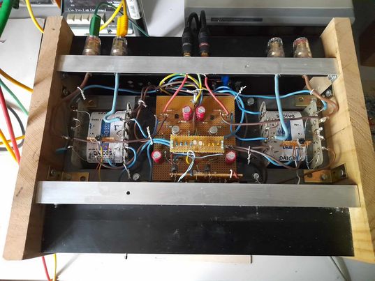

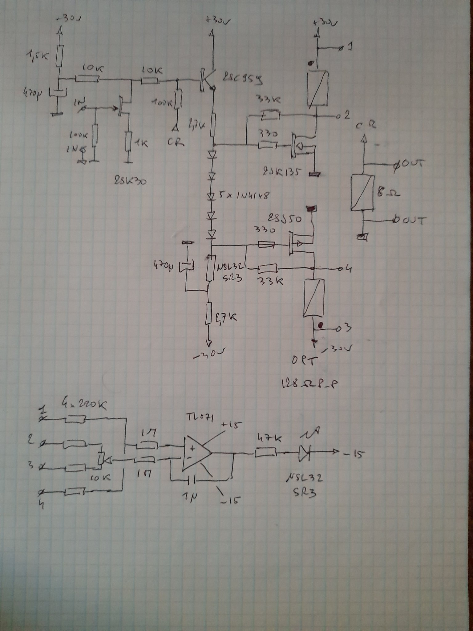

Hi everyone,
Some years ago, I built a different version of the NEMESIS amp. It's a 14W class A amp inspired by the "NEMESIS COMPENSE" version. Instead of using N channel MOSFETs, I use N and P MOSFETs (2SK135 / 2SJ50) in a single ended arrangement (no phase splitter or differential stage) with a split primaries push-pull output transformer and bipolar PSU. The transformer is much easier to built and far cheaper (no air gap nor saturation), bandwidth is extended at both ends, ripple is nulled (no need for a regulated PSU). The MOSFETS are triode connected (see my article in "LA REVUE DU SON - 240". The amp is very simple, it uses 4 transistors per channel and is fully DC coupled up to the output trans. Additionally, the bias is optically DC servo assisted.
I think that if bipolar tubes had existed, this sort of circuit would have been in use long ago.
For those interested in the NEMESIS family and don't mind poor English ...

Custom made.
You need to find a local manufacturer.
The details already described in the article.
Toroidal transformers cannot be used in the single FET circuit because of the high DC current.
You will then need to order custom EI transformer.
See Jan's article at Linear Audio.
Patrick

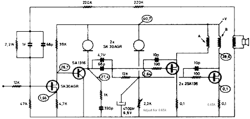

toroïdal trans may be used with the single MOSFET version provided the second primary is connected in the "NEMESIS COMPENSE" style (lower 2SK135 and bias circuitry in the picture attached).
For better efficiency, this nulling circuit may easilly be controlled by kind of a DC servo circuit.
I achieved good results with a 2 x 110 / 2 x 33 V - 330VA toroïdal trans. Complete article here (alas, in French) :
https://www.google.com/imgres?q=nem...d=2ahUKEwjBzsOh9b6GAxXWSKQEHUFHCUAQM3oECF0QAA
Yes, I had that in mind. Just wanted to show how to build the "compensation" (not able to find the proper English word) circuit, so I used this 3 trans schematic that shows it. Anyway, it's very easy to use the single MOSFET version with "compensation" in order to use toroidal or push-pull transformers : just make two single MOSFET circuits, connect them to the OPT with the primaries wired in opposite phase. Feed only one MOSFET with the source signal. The second MOSFET is then the current source needed to compensate for the DC current of the first one. This trick can also be used with tube push-pull amps to convert them in single ended mode. You can even imagine a push-pull OPT connected to a triode for signal and a pentode (almost an ideal current source) for DC compensation, say a 300B and a 6L6 for instance, etc. Back to the NEMESIS, as not using the current source circuit for modulation is sort of waste, I imagined the version I posted earlier, where a P channel MOSFET compensates for the DC current AND acts as a push-pull arrangement, without the need of any phase splitter or differential stage as in the QUADRIGE version. With this arrangement and as P and N MOSFETS have somewhat different caracteristics, the pattern of harmonic distorsion keeps very single ended- like.
