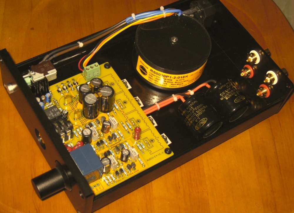

The kit:
My 1st kit comes with a main PCB, all parts including a ¼” jack, 4 heatsinks, metric standoffs & screws, but no potentiometer. The schematics are in the links
The transformer:
The box:
There’s a dedicated aluminum box, pre-drilled and silk-screened. It comes with a fused IEC connector, a power switch, a volume knob, stick on feet, and some metric screws:

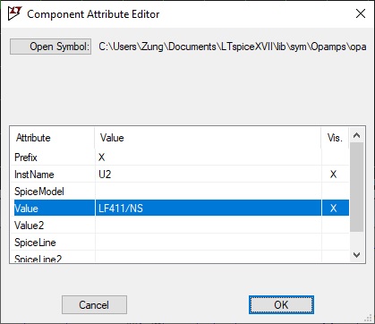

Also included here, the current version of my simulations, along with the supporting files; just put them in their respective folders:
C:\Program Files\LTC\LTspiceXVII\lib\sym for the .asy
C:\Program Files\LTC\LTspiceXVII\lib\sub for the .lib & .sub and you should be good.
This asc has most of the tweaks I’ll get into in a bit, including a DC servo that may or may not make it to the physical amp. I couldn’t find models for the 2SJ407/2SK2381, so I use the IRF710/9610 instead; these are also those which will probably find their way into the physical amp, at least in its V1, but I’m way ahead of myself.
Mind you, the frequency domain is not optimized yet, so the poles may need more tweaking.
If someone knows where the “.tran 0 {simtime} {dlytime} {timestep}” magic comes from, please let me know, I’d like to thank the guy.

OK, I never said there’s gonna be a step-by-step guide; just a bit more detail, because the various bags that come with the kit can be confusing.

Transformer
My preference is R-core: it has less stray magnetic field than the E-I core, and less coupling between primary and secondary than the toroidal. The Chinese ones are cheap and well made: I’ve yet to hear one buzz. I chose 30VA because it’s the biggest size that’ll fit comfortably inside the box.
Heatsink
The provided ones look wimpy. I think it’s better to bolt them to the chassis: more holes to drill, but better thermal resistance.
The box
Well made, perfect fit and good looking. You need to drill the holes for the main PCB, the transformer, and an optional pre-regulator. Also, the hole for the potentiometer is too small for most man-sized pots and needs to be enlarged.

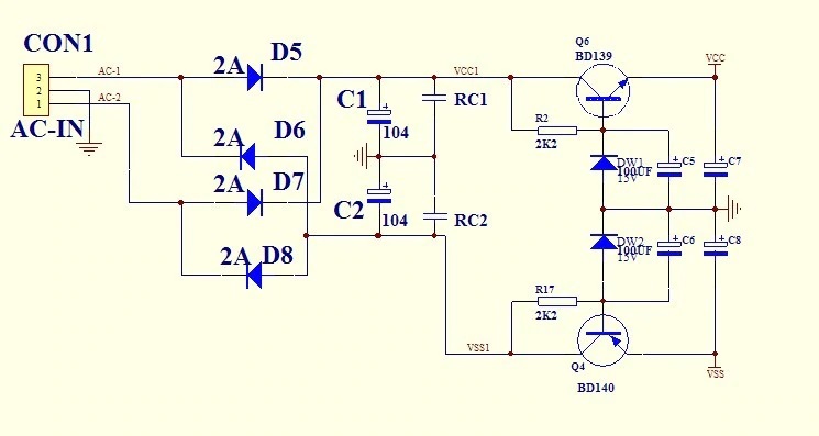

The original kit feeds the MOSFets directly from the smoothing caps, the rest goes through a BJT/Zener stabilizer. There’s a picture from the seller showing a couple of offboard big caps, which is a valid solution.
Because the operation of the circuit has some sensitivities, both static and dynamic, to the power supply, I want to play it differently and add an offboard regulator based on the ubiquitous LM317/337, replacing the ‘lytics and the ceramic’s that come with with known good stuff (I know, I could have wired it on a perf board, but hey, it’s only 5 bucks!). Then I remove the onboard Zener turning the stabilizer into a cap multiplier to buff out the nasties from the regulator. These are all in the attached asc's and the BOM, and the various pin spacings are accounted for.
There’s also an option to add Elvee’s D-Noizator, maybe someday.
Finally, I was kind of expecting a fight with the snubbing business, but a couple of caps deals with it nicely, see the attached sim, but don’t worry about the DC, I know the turn ratio is off.

The E19 I have is almost identical to Weiliang's E5. It has the Marantz HDAM input. The jFET are marked as K170, but I doubt that it is genuine stock.
My E5 Class A hifi headphone amp
I chosen the T-2205 enclosure because of the size of my E19 headphone amp board and the use of a regulated PSU.Thank you for the links! Those predrilled chassis appear to be a good bargain. I wonder whether I can shoehorn a Noir or an ACP+ into that box; it won't cost much money to find out.
T-2205 headphone Enclosure Full Aluminum amp chassis DAC box Premplifier Case | eBay
It cost a little more, but the extra internal volume is very good for running the amp in class A. Otherwise, you will have to use the case as heatsink. You do have to drill out the front and back panel with relatively large holes. A hand drill will be difficult to use. I have a 8" tabletop drill press, $54 from Harbor Freight. We usually do not have drill bit large enough in our drill bit set. I use a Titanium High Speed Steel Step Bit which works up to 3/4" diameter holes and good enough for most headamp project. Aluminum panel is relatively easy to drill.

None of the libs you posted includes a 2SK246 model.
It's in z.lib.
Are you familiar with LTspice?
