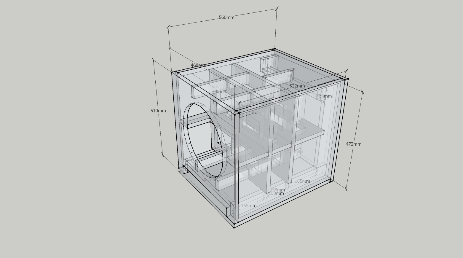

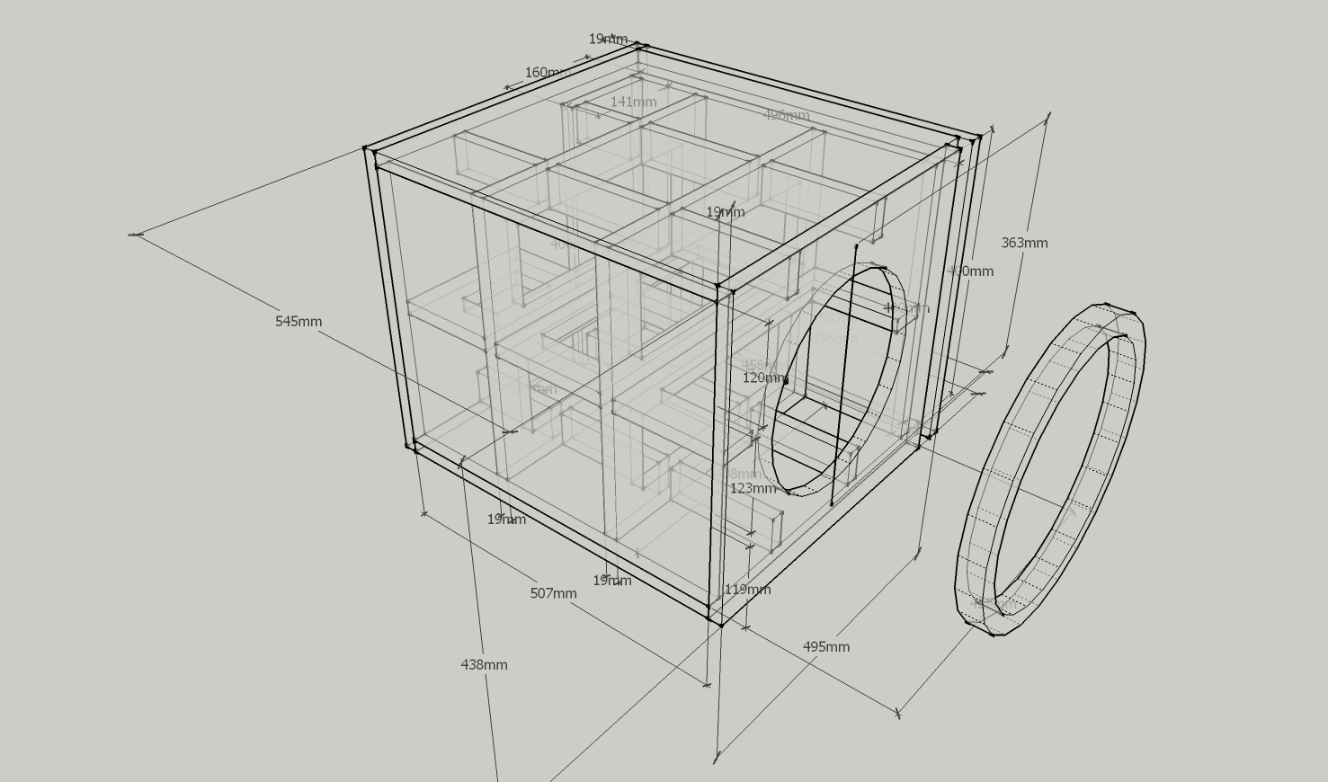

im finishing the final design of the isobaric subwoofers. instead of one big sub im building 2 half the size.
final design.
the ring is for separating the 2 woofers.
sorry for the random numbers in the sketch, i forgot to clean out some old measures that arent relevant.

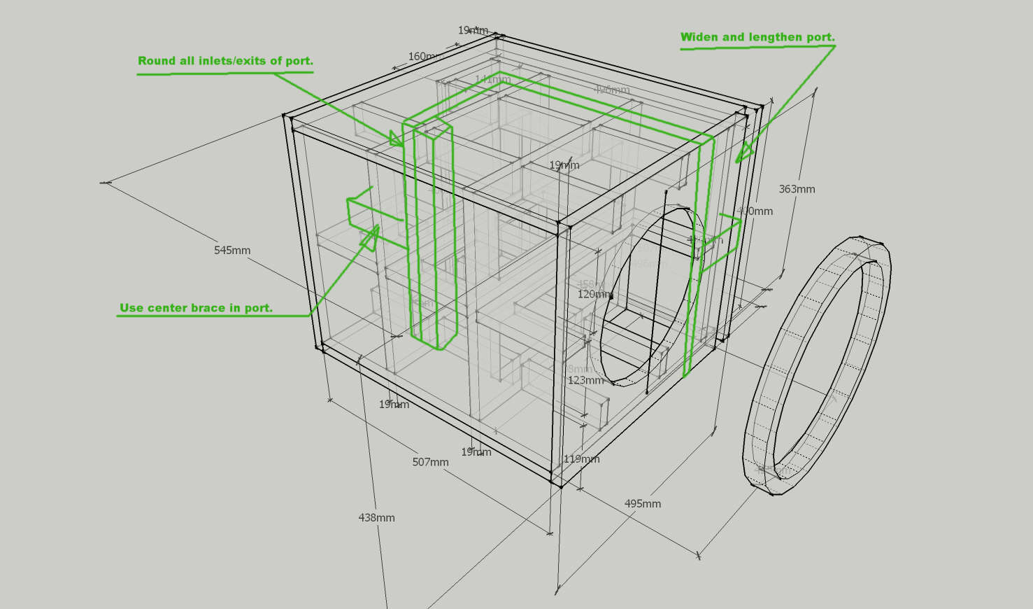

Hi butterwitz,
Your Sketchup skills are remarkable.
Just my 2 cents on this design: I guess, that the narrow slot on the right hand side of the enclosure front is the port. That's a very flat, high aspect ratio opening. I'll attach two general analysis done by bjorno on this subject, the 1st one is on port correction, and the 2nd one is on port flares/nozzle ports.
Also, here is a link to Flare-it, a port/flare calculator:
Port Flares - Evaluation of noise
You are going to put a lot of work into this box, so it may be a good idea to take another look at the port design. I feel that the port as currently drawn might choke off at high SPL levels.

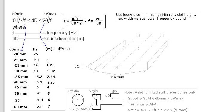

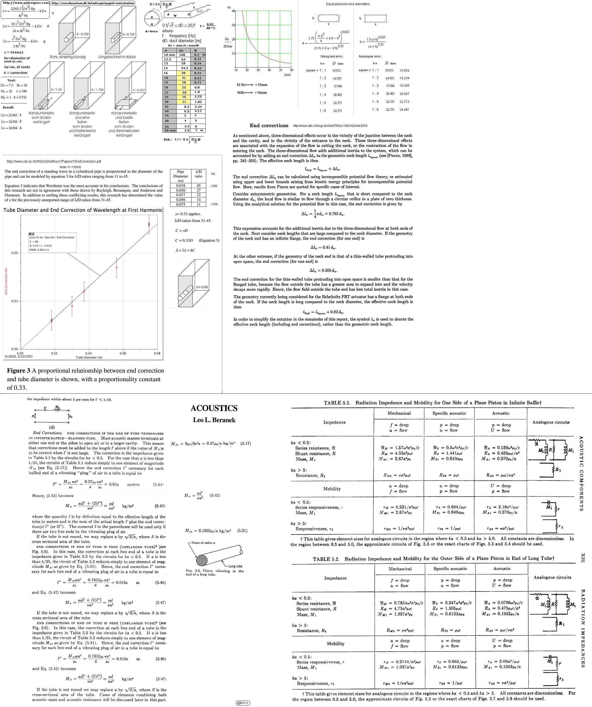

yeah man, im VERY thankful for your input 🙂 because you adresed this exactly in the last moment 😀 i think you are rigth but i lack the skill and knowledge to make the design much better i think 🙁 - BUT i WILL give it a try 😀
i did see those papers by bjorno before - but i do admit i could not make sense out of them. i guess my main problem is i am not an engineer 🙁 i will have a deeper look into the papers today.
the slot vent in this design i calculated to get 0.05 mach airspeed using win-isd.
i have a rounding off router bit i thought of using later one on the slot outlet and part of the inlet. but first i want to make sure i get this design better 🙂
the slot in this design is 3 x 40 cm - which i realize is a 1 to 13 ratio or something..
if im rigth this the information relevant to my build 🙂 the diagram shows same values as in the other paper relating to port height (H in mm) and port width (W in m) - but this to me makes little sense - i read it as the maximum width for 30 mm (3cm) is 1.82m - thats like 6 foot wide 🙂
i must read this wrong! 😀
on the other paper it clearly states its M like in meters for the width - so i have to say i honestly do not get this - since a 1.82m is 182 cm (6 foot!) - and that just cant be? hehe it sounds too wide!
if so - it means my ratio of the heigth to width should be ok - but then again if i do not understand this correctly i will fail miserably 🙁
i someone could confirm this it would be awesome. 🙂
Hi butterwitz,
I think you are reading it correctly. I was more thinking about the length correction, same page, upper left hand corner, and I'm like you: some of that data does not quite compute with me (like the table you quoted). I think this table applies more to the general flow characteristics of a duct then to the inlet/exit conditions.
I did not catch, that your port is actually 30mm high, when looking at it it looked more like 19mm, but now I see that's just an intermediate design stage front baffle overlapping the port (?). Anyway, the basic answer is to increase the height of the port, which will mean you'll have to increase the length, and maybe the size of the box to make up for the volume losses. I would also recommend to support the center of the port with a brace, as otherwise the unsupported outside boards are a bit on the wide side. I would add an edge support at the inlet, and round off all corners of the port inlet/exit.
Anyway, good luck with your build.

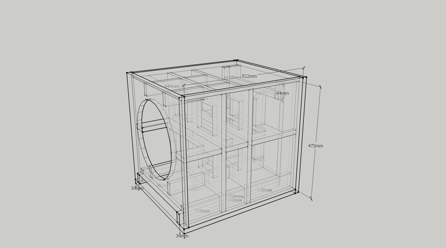

wow thats awesome! 🙂 well i finally drifted away from the double sub enclousre to 2 separate enclosures. it will be easier to handle 😀
ok this is the new sketch.. 1:8 ratio on vent. vent is 90cm long!
tomorrow i will adjust the volume to fit with the bracing etc, i will probably do a few smaller changes.
had to turn the subs around and put the vent on the floor as in the original plans i had.
im not entirelly sure i like this design, maybe tomorrow i will find a final thought. i have more or less decided to wait with ordering the material until next week.. so i will have time to get a decision.
the dividers/braces inside the vent arent showing too well. they are more or less aerodynamically shaped, like looking at a canoe from above 🙂 also as before all edges of the vent inlet and exit will get rounded off.
vent dimensions are 4,5cm height x 36,2 cm width and 90,7cm length
the separating ring for the clam mounted woofers is still part of the design, but not in the pic
