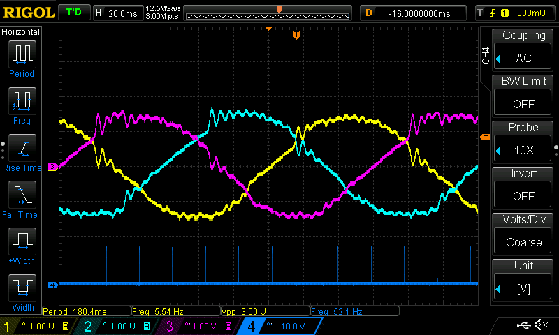

I have questions, if I may. What happens if there's an increase in load on the platter, such as a stylus in a groove, or something larger such as a light finger touch on the rim? (I'm thinking a small paint brush might make a decent "drag standard")Mr. Cawley et al,
In an earlier post you said to look for approximately 2Vpp on the motor drive. I'm getting 3Vpp on 33. Any concerns?
Does the voltage go up? Does the phase or frequency change at all (and can you see that with the sync based on something that also changes)? The electronics clearly "does something" to compensate for an increased load, and I wonder exactly what it is.
3V is OK, but have you changed the three 10uF on the output of the motor drivers ?
Ben, yes the voltage will increase but the frequency does not. The phase may delay but will recover when the load is removed. This is one of the reasons why Technics MKII turntables have such wonderful timing.
Yes, all electrolytics have been replaced and the PLL readjusted.
Ben - In this video, the fist four amplitude increases are me dragging my finger on the platter, and the latter are me applying pressure far beyond what would easily stop a belt or idler drive. This video is me tapping the table while suspended.
That's fascinating, guys. thanks for the responses. The operation appears to be pretty much what I described in this post a few years back:
http://www.diyaudio.com/forums/analogue-source/71356-why-dd-bad-4.html#post2219981
Rewriting a little bit to what I "really meant," the drive coil SIGNAL CURRENTS should be some fixed phase ahead of the permanent magnet poles, so the coils are always "pulling" the platter. A good, quick detection of speed decrease (caused by an increased load) allows for a virtually instant increase in drive force to correct it without any change in drive frequency or phase.
The three sense coils go to a three-phase rectifier circuit (it looks just like the diodes in a car alternator!) to generate a voltage proportional to the platter speed. I somewhat recall discussion earlier in the thread on this, and that the (needed) filtering of this rectified voltage gives a delay that is, of course, undesirable inside the speed control loop. I'm frankly amazed this analog speed detection circuit works as well as it does using the relatively low frequency signal (is the sense frequency 5 Hz at 33rpm, just like the drive frquency appears to be in #606?).
