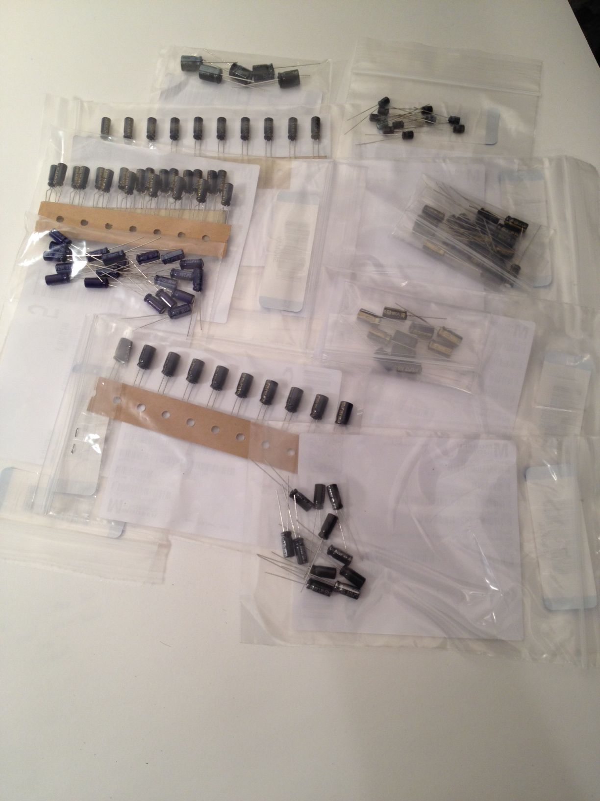

I started the re-cap procedure, it's all very straightforward. There are some things that need repair on the PCB, I.E., the fixing of poor repairs... But nothing major.
More photos as I progress.
I've completed the re-cap on one of the boards (save for one cap I didn't realize was a bi-polar electrolytic, so I need to order a few of those...)
When I get into the remainder of the 2nd board I'll grab some photos.
It's a straightforward process, and although the PCB are thin with thin copper, it's made up for by there being silkscreen on both sides of a single-layer board. 🙂

The board with beautiful new caps.
Dead soldiers
