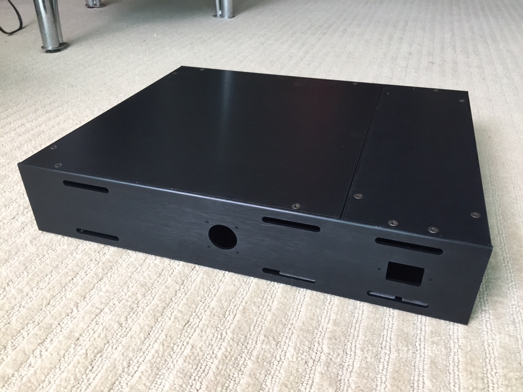

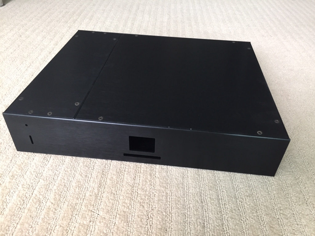

In my quest to outboard the electronics from my SP-10 MK2 I enlisted the help of David at Landfall Systems.com to build the chassis.
To make the transition somewhat easier and to not reinvent the wheel so to speak, the chassis David is making for me is one chassis, two sections, via a front to back divider. Also the top and bottom covers are split along this line. The chassis measures 17" w x 3 1/4" t x 14" d. The center divider is 4 3/8" over, measured from left to right. The chassis will be brushed anodized black.
The left side will receive the original power supply, basically intact, less the original chassis. The power switch and light will carry over as well. The right side will take the under table electronics basically as a whole. I will mount the boards intact to the bottom of the chassis lid, as they are under the table. I am mounting the stop/start switch and speed selector whole to the front panel of the chassis. In my system this new power supply will sit on the next shelf below the TT to allow as short of an umbilical as possible. By having the covers split I can easily access the trim pots on both the power supply and turntable electronics easily with only having minimal covers removed.
The strobe and platter brake will not be a part of the new build.

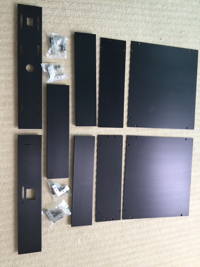

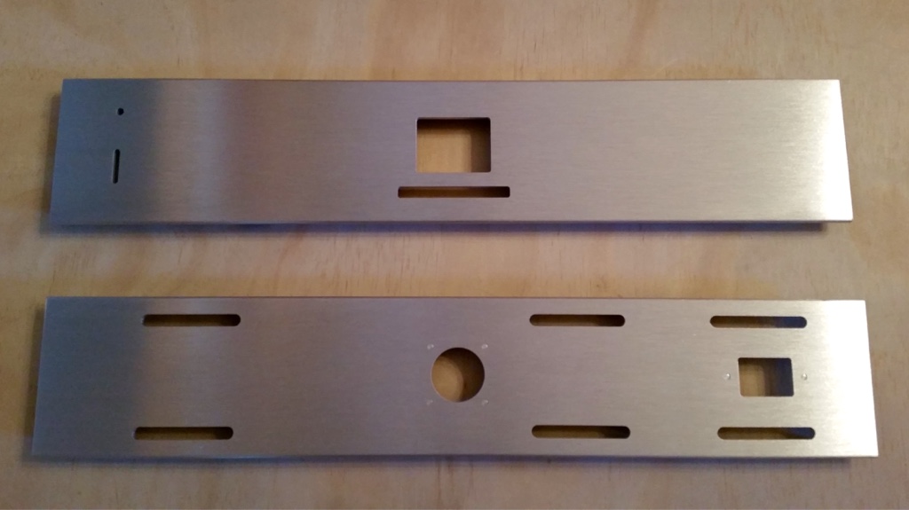

Besides the cutouts on the front for the switch, light, speed selector and start/stop, the back has cutouts for the IEC receptacle, and umbilical receptacle, along with 6 ventilation slots. I'm hoping the chassis will retain a little SP10'ish look and feel.
Dave CNC'd the cut outs this morning and sent me this pic.

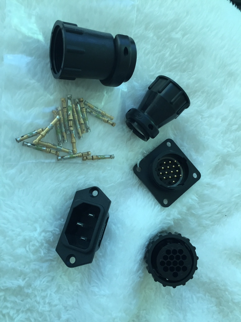

This is what I ordered from Mouser, and what the parts look like. The contacts are gold plated, rated for 3 amps, up to 20ga wire and solder connection. BTW, I ordered two different size collars as I'm not sure what the final diameter of the cable will be.

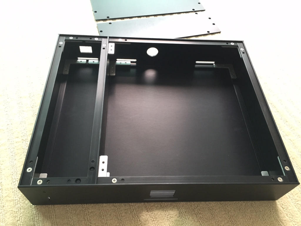

The chassis should be anodized and be ready to ship Friday. Really excited the have all the openings in the chassis done and anodized after. Should look really nice.

I don't think omitting the platter brake is a good idea - the TT conrtoller sends a momentary reverse signal to the motor and engages the brake when the stop button is engaged.
Ask Dave Cawley if that can be disabled or the amplitude turned way down... If not, you might want to consider keeping it.
Also, is there enough room on the faceplate to mount the start/stop button assembly? It's significantly taller inside than out.

I have read posts on each side of the idea of removing the brake. When I put mine back together after the recap, I omitted the brake to check for myself. On an operational basis I do not notice any issues. With the brake removed the platter makes 2 1/3 rotations before stopping. It looks like both OMA and Artisan Fidelity both remove the brake in some of their builds. Open to ideas on modifying or adjusting electronics related to removing the brake though, as the brake is gone!
And yes, as built the board and supporting bracketry is actually about 3 1/4" tall, same as the chassis faceplate. A little modification on the bracket (other) is in my future! I didn't want to go to the next size up on the chassis which is 4 1/4". I positioned the cutouts with the button assembly fitting, but tight, to the bottom.
David's chassis(s) are perfect! Usually when you assemble anything that has multiple pieces/screws you have to start all the screws first then start adjusting and tightening as you get everything to line up. With the Landfall enclosures you can tighten every screw as you put together and when you get to the last screw it will still be exactly lined up and panels perfect. This will be my 4th from him. Glad he started being able to make the cut outs via CNC too!

Everything as you see it, including custom CNC work, anodizing, and 3 day shipping to Hawaii was only $301.It certainly looks sturdy...nice divider for a transformer section.
How much if i may?
Hard to see in pics but the top and bottom covers are divided also.
