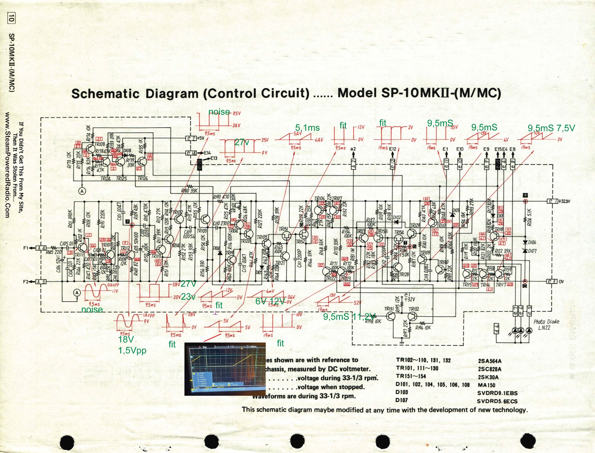

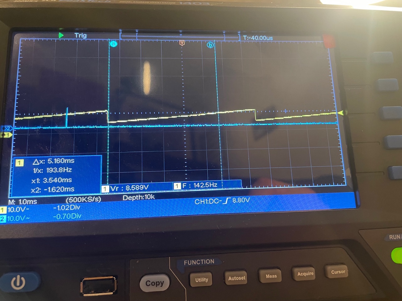

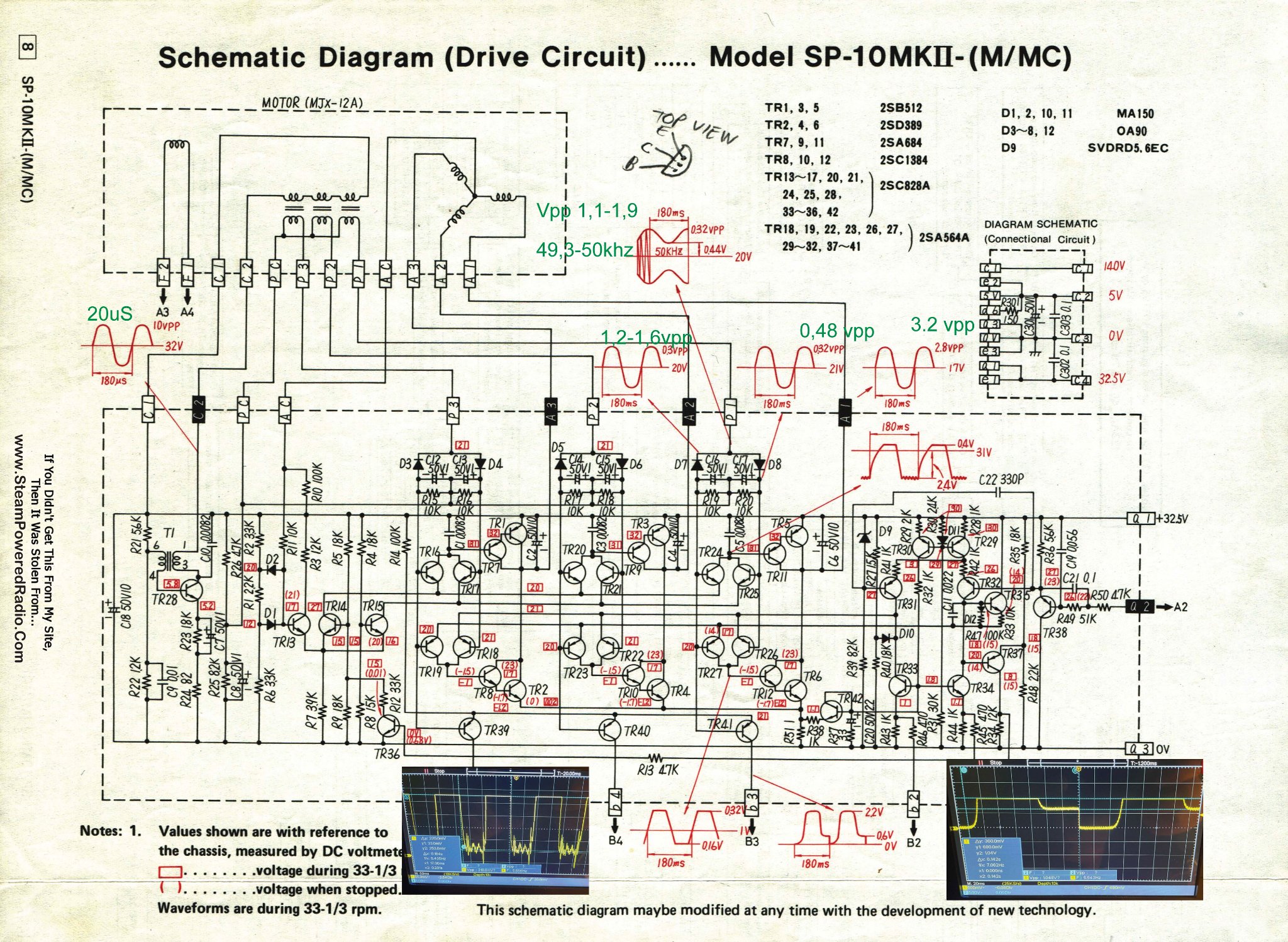

Thank you so much for your help; I truly appreciate it! I've never had the opportunity to formally study anything in this field, so achieving progress here genuinely makes me happy.
I’ve checked all the TR components—101, 111, and 112—and they are functioning perfectly, along with the remaining TRs on the control board. However, I noticed that all the orange polyester capacitors seem to be leaking slightly. Is this normal? I have some WIMA MKP, MKT, and FKP capacitors available—would these be suitable replacements?
Today, I also rewound the FG coil with 500 turns, which resulted in a resistance of 210 ohms. It’s now working noticeably better than before.
After reassembling everything, I tried adjusting the 50 kHz frequency on T1 via C2, but it fluctuates by approximately ±0.1 kHz. I also attempted to fine-tune the timing with VR101 and VR102, but the timing still varies slightly, by about ±0.2 ms.

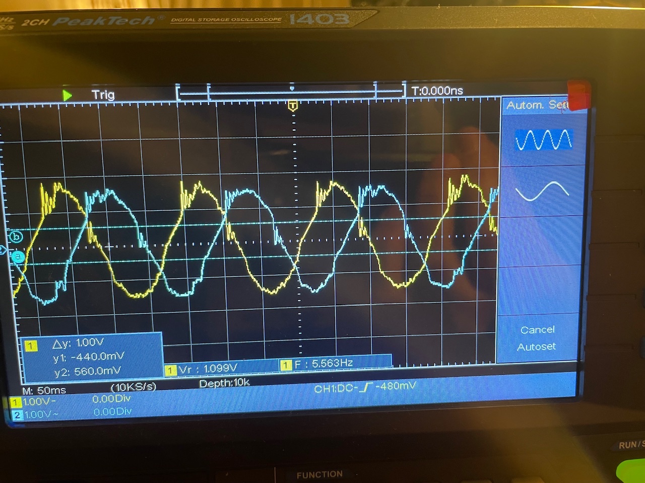

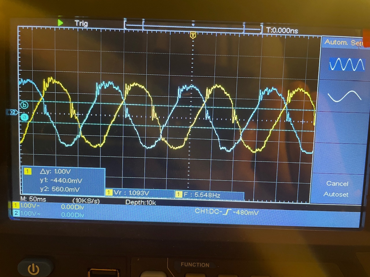

Additionally, I measured the waveforms for A1, A2, and A3 (two seperate screenshots) as well as the frequency F at P10 at 33.3 rpm. Here, the frequency fluctuates between 105.4 Hz and 105.9 Hz.
Overall, the system is running much quieter and better now. However, I’d like to achieve the best possible performance since this will be used in my cutting lathe.
Do you have any suggestions on how to proceed from here?
Thank you so much!
Best
Jo
Edit: As I never mentioned it, it's a SP10 MK2

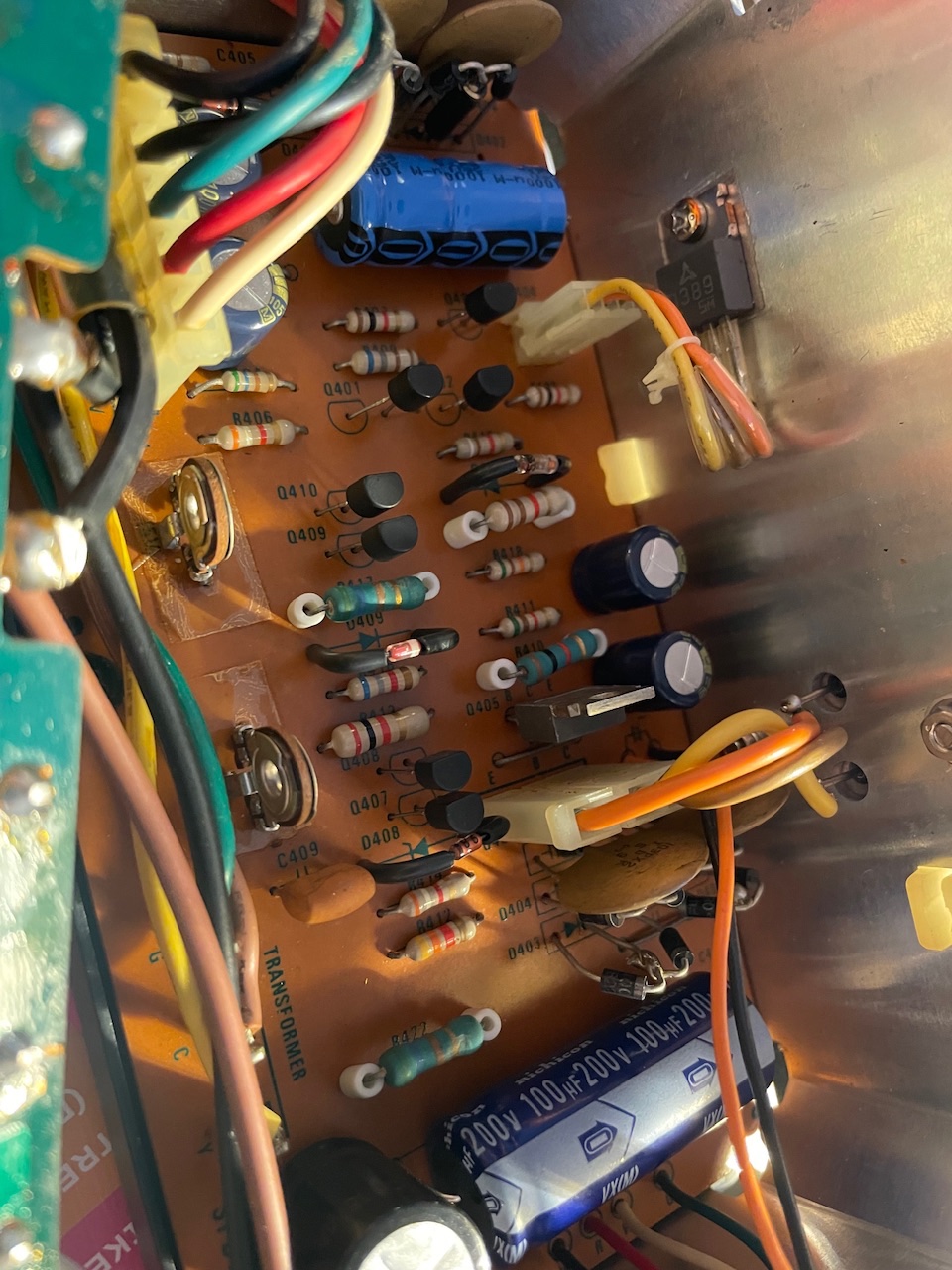

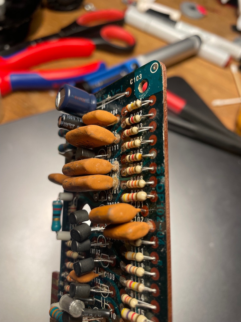

The 50kHz is the excitation signal for the variable reluctance resolver to drive the motor, as Dave said it's not critical for speed.
The noise on the zero crossing of the motor drive signal is an issue. The corrosion on that PCB is also of concern. I would fix the PCB if the caps have leaked then replace them. WIMA, MKP will be fine just make sure they are at least 50V. Clean that PCB well and make sure all the corrosion is gone.
If you haven't replace the caps near the drive transistor (C2 C4 & C6) do so. I use either Rubicon 191-8053 or Nichicon 519-4526 (RS part numbers) I prefer the Rubicon if available because they have higher ripple current and longer life.
Also check the 32V and 5V for ripple it should be no more than a few mv AC.
Definitely C2 C4 & C6 I use Panasonic FC 100V 12uF part EEUFC2A120 The ones suggested by warrjon are fine too. Buy from a proper authorised dealer, not Amazon or eBay.
The motor coil drive waveform is never going to be great, but whatever you do need to change those 3 capacitors.
I would clean that PCB with a stiff brush and "MG Chemicals 99.9% Isopropyl Alcohol Electronics Cleaner, 475 mL Liquid Spray Bottle"
Then reassemble, sit back and live happily ever after.

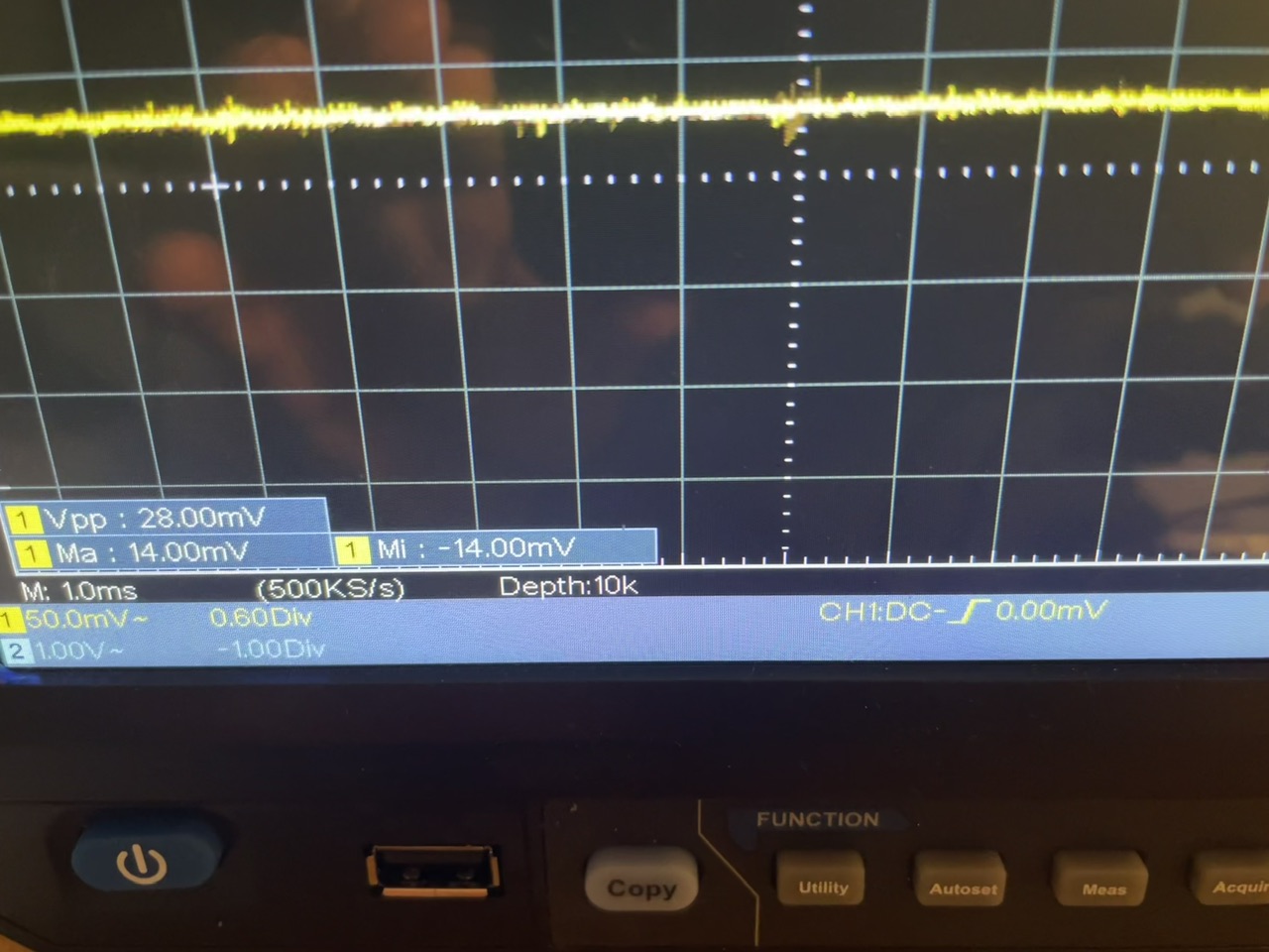

I've already replaced the C2, C4, and C6 capacitors with Panasonic FC series. Today, I'll be replacing the leaking polyester capacitor as well.
I just checked the AC ripple using an oscilloscope. Previously, I had only measured it with a multimeter. This might be where the issue lies. I'm not entirely sure if my budget oscilloscope provides accurate values, but it shows an AC ripple of 28 mVpp at 32.5V and 22 mVpp at 5V. That seems excessively high to me.
In the power supply, I’ve already replaced all electrolytic capacitors with Panasonic FP, Nichicon, and EPCOS components. Additionally, I swapped out diodes D401-406 for UF4007.
Could it really be that the AC ripple is responsible for it still not running stably?

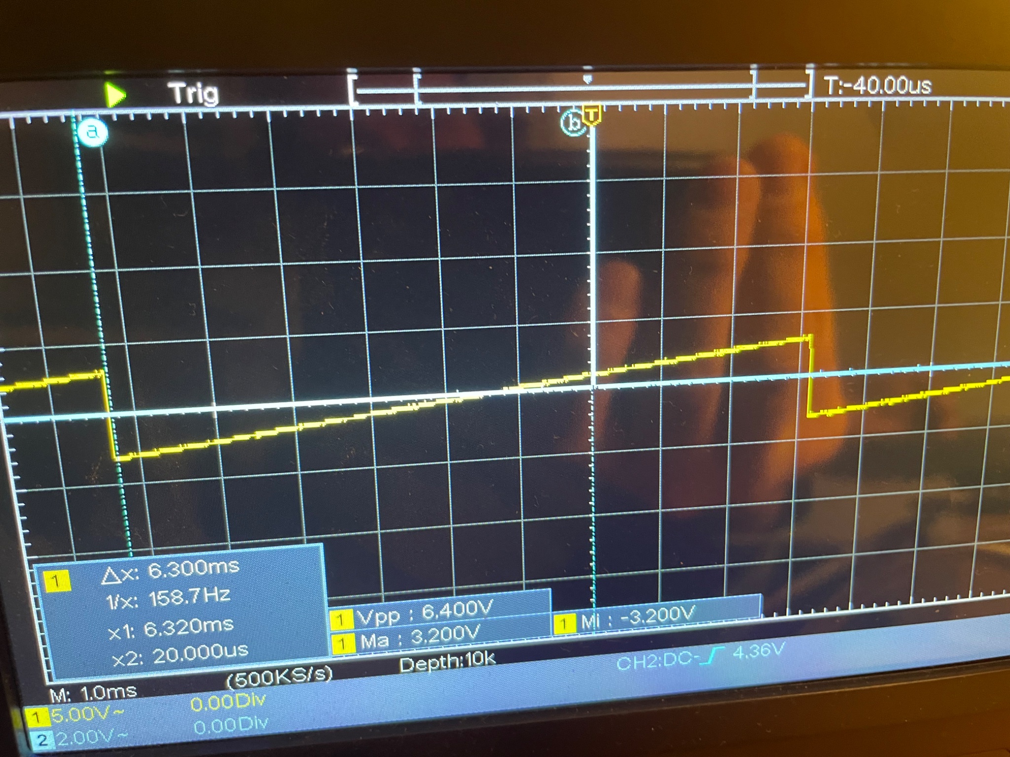

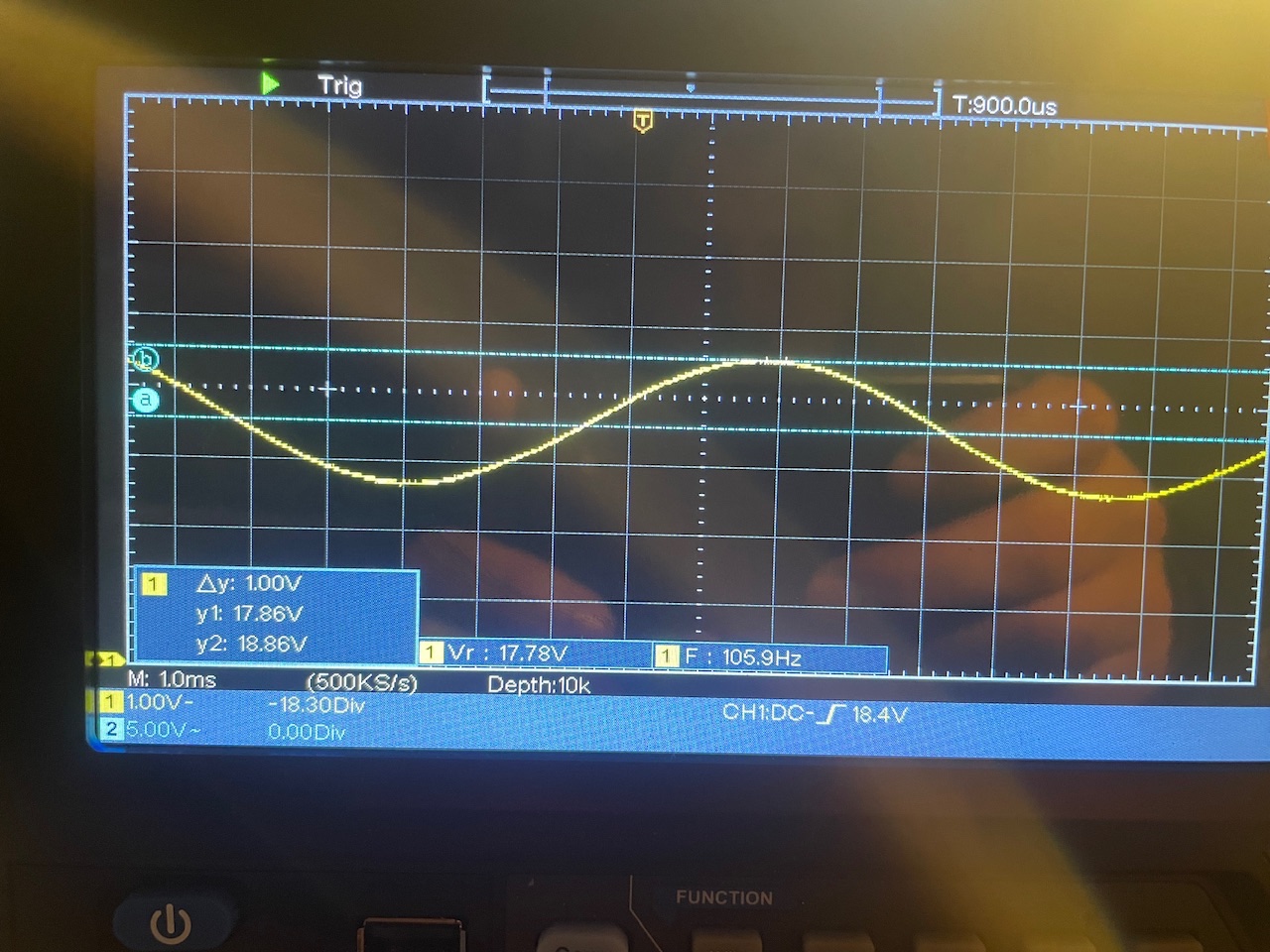

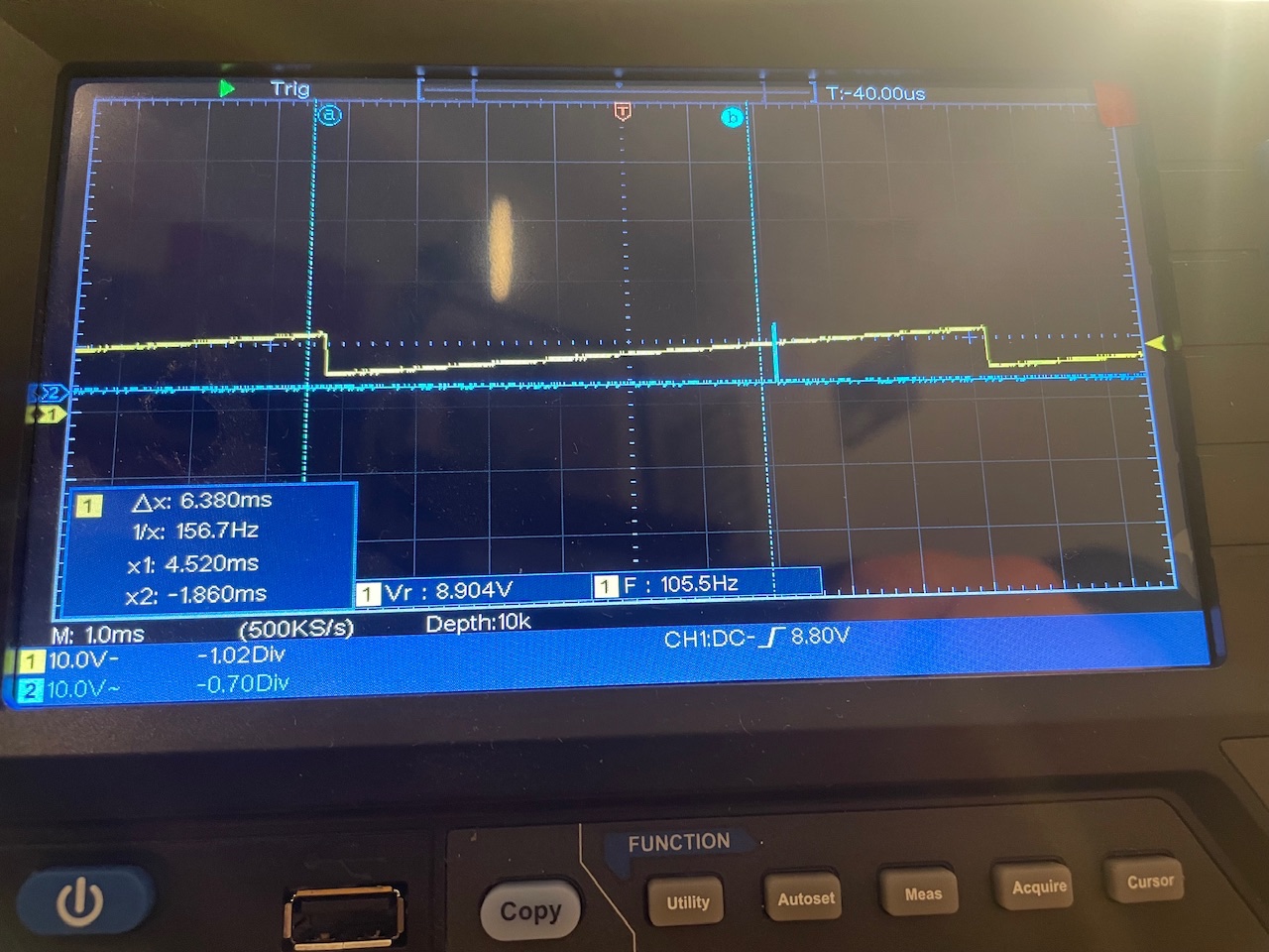

I believe it's not running stably, as the frequency on P10 F fluctuates between 105.4 Hz and 105.9 Hz. If I've read correctly, it should be 105.55 Hz.
Additionally, while performing the period adjustment, I noticed that Wave S is not stable; it appears to be wobbling from left to right.
I do have the Ortofon Test Record, but my plinth and tonearm are not properly aligned. My strobe although does not work at the moment. So, I think it makes more sense to stick to using the scope and multimeter for now.

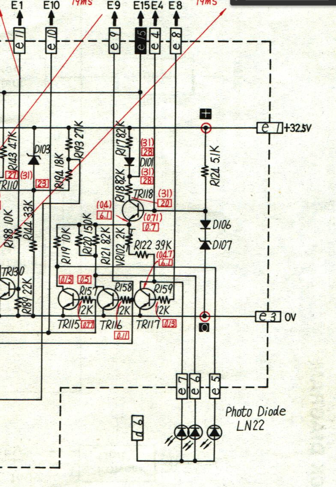

I decided to measure some transistors to check for any potential issues. They all tested fine when using the multimeter's diode check. However, I then tested them while the system was running at 33.3 rpm. I randomly checked a few transistors on the control circuit, and all of them deviated from the values given in the service manual.
I started with TR118, the "first" transistor on the board, and found it to be completely off. Here's what I measured:
  • During STOP:
    • B: 0.12V (should be 0.71V)
    • C: 29.6V (should be 31V)
    • E: 2.6V (should be 0.41V)
  • During START at 33.3 rpm:
    • B: 6.66V (should be 0.7V)
    • C: 22.9V (should be 20V)
    • E: 6.0V (should be 6.1V)
The values from the service manual are in brackets.
Before the voltages reach this transistor, there is only one resistor and two diodes in the circuit. The resistor measurements are fine. Could it be that the diodes are causing the issue?

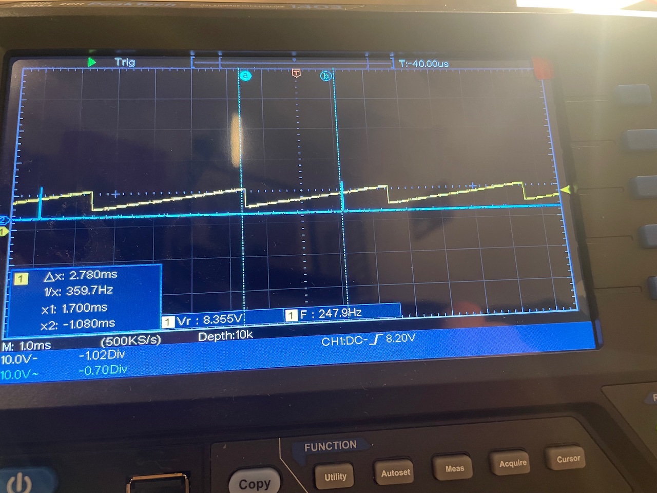

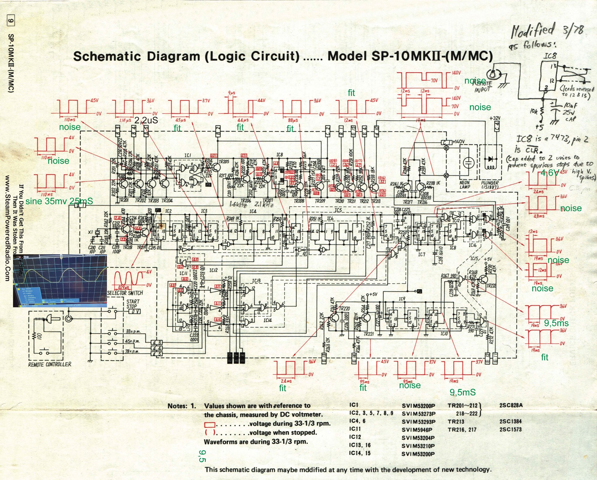

I believe I am getting closer to identifying the issue after spending half the day taking measurements.
First, I noticed that while 5V are coming out of the power supply, only 4.85V are reaching the logic board, which indicates that there is definitely an issue somewhere in the system.
One problem I’ve identified is that the timing at measurement point P10 S should be 19ms, but I’m only measuring 9.5ms. This issue appears at several points in the circuit. Could this problem be related to the area between IC9 and IC10?
Additionally, I noticed that the sine wave at P1 has an unusual dent at the bottom, which shouldn't be there.
Another issue I found is that the signals at A1/2/3 and P1/2/3 are not stable — both the peak-to-peak voltage and the frequency are constantly fluctuating. I even swapped the motor with a different one, but that didn’t change anything. I’m still unsure about this issue and would appreciate any advice.
I plan to review the entire circuit again to try to understand where these problems could be originating from.
I've attached photos of my measurement results. Hopefully, someone will be able to make more sense of them than I can.
