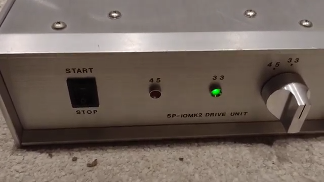

I have very recently seen a Video sent by a friend of my Donor TT in a New Plinth, where the OEM design is stripped of its Metal Chassis and PCB Electronics.
The off board electronics for this design is functioning and producing both 33 and 45 rpm for the TT to run at.
Hopefully by early in the New Year this will have been demo'd to myself and a few others, using the same Tonearm and Cartridge, as an A/B comparison to a SP10 Mk II mounted in a P'holz Plinth.

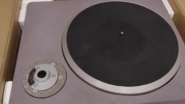

I tried a different method to extract frames from the video, Voila.
The Armboard is CNC produced from Corian.

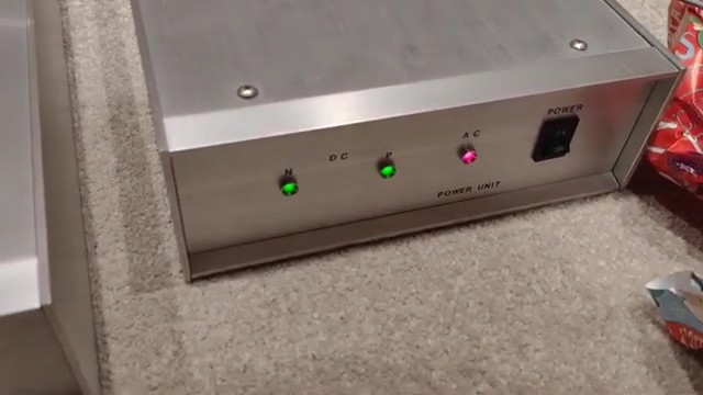

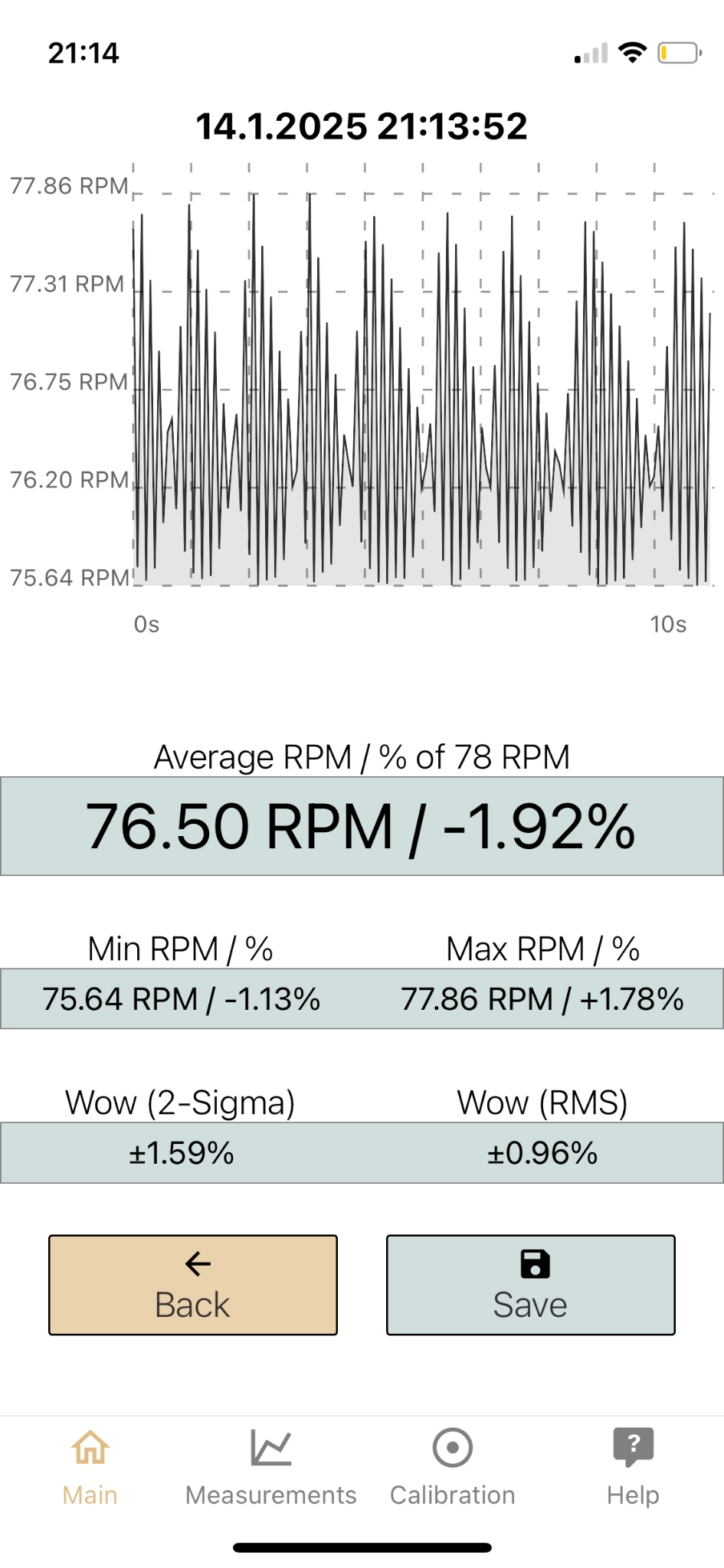

Hi everyone,

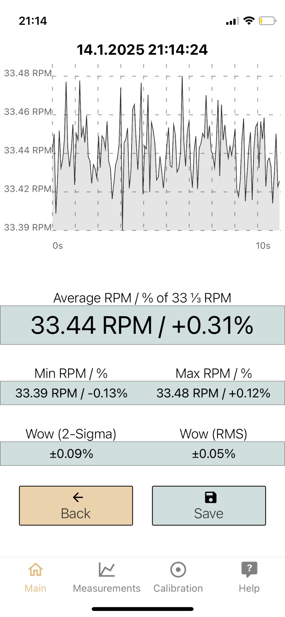

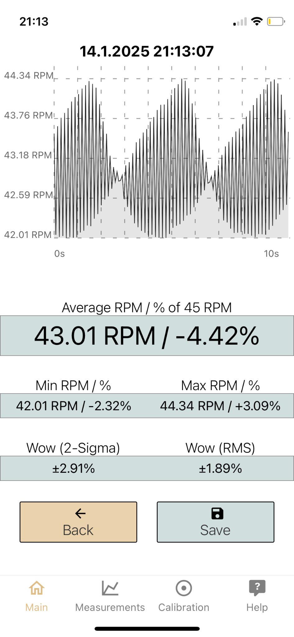

I'm facing an issue with the speed of my turntable. Initially, the speed began to run away, going faster than 78rpm, and the speed selector stopped functioning altogether.
I've replaced all the capacitors and rectifiers in the power supply and calibrated it using a second (working) SP10. I also replaced C2, C4, C6, and all the capacitors on the logic board, as some of them were leaking. However, this did not resolve the issue.
I later discovered that one of the FG coils had infinite resistance. The defective coil had 510 windings, so I rewound it using 0.1mm enameled copper wire. Since I don't have specialized tools, I used my cordless screwdriver to do this – and it was certainly not an easy task.
In the end, I managed to get 310 windings on the coil before it was full. I measured the resistance on the original, working coil (200 ohms) and the rewound coil (100 ohms). I decided to test it anyway, and although it didn’t fully fix the issue, it improved the situation. The speed selector is now functional, and the speed is more stable, though still not perfect.
I'm not sure how to proceed from here. Should I try using a thinner wire to match the resistance of the original coil, or should I rewind the original coil to ensure both have the same 100-ohm resistance? Or could the problem lie elsewhere?
Thanks for any advice!
Cheers
Jo

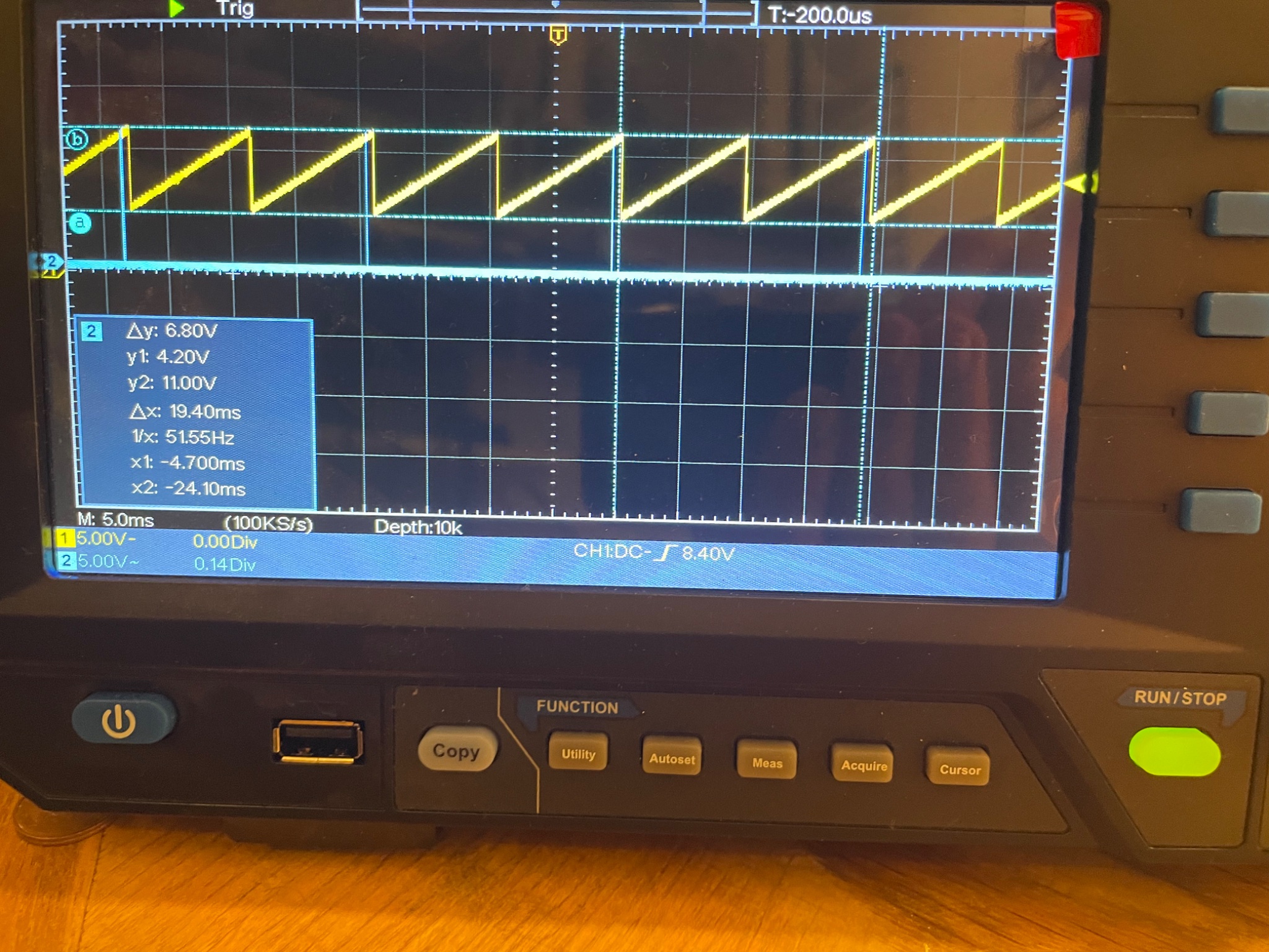

Pic: measurement of S and T with running 33.3 rpm
I measured the frequency on F: 33,3rpm 116hz; 45rpm 146hz; 78rpm 252hz

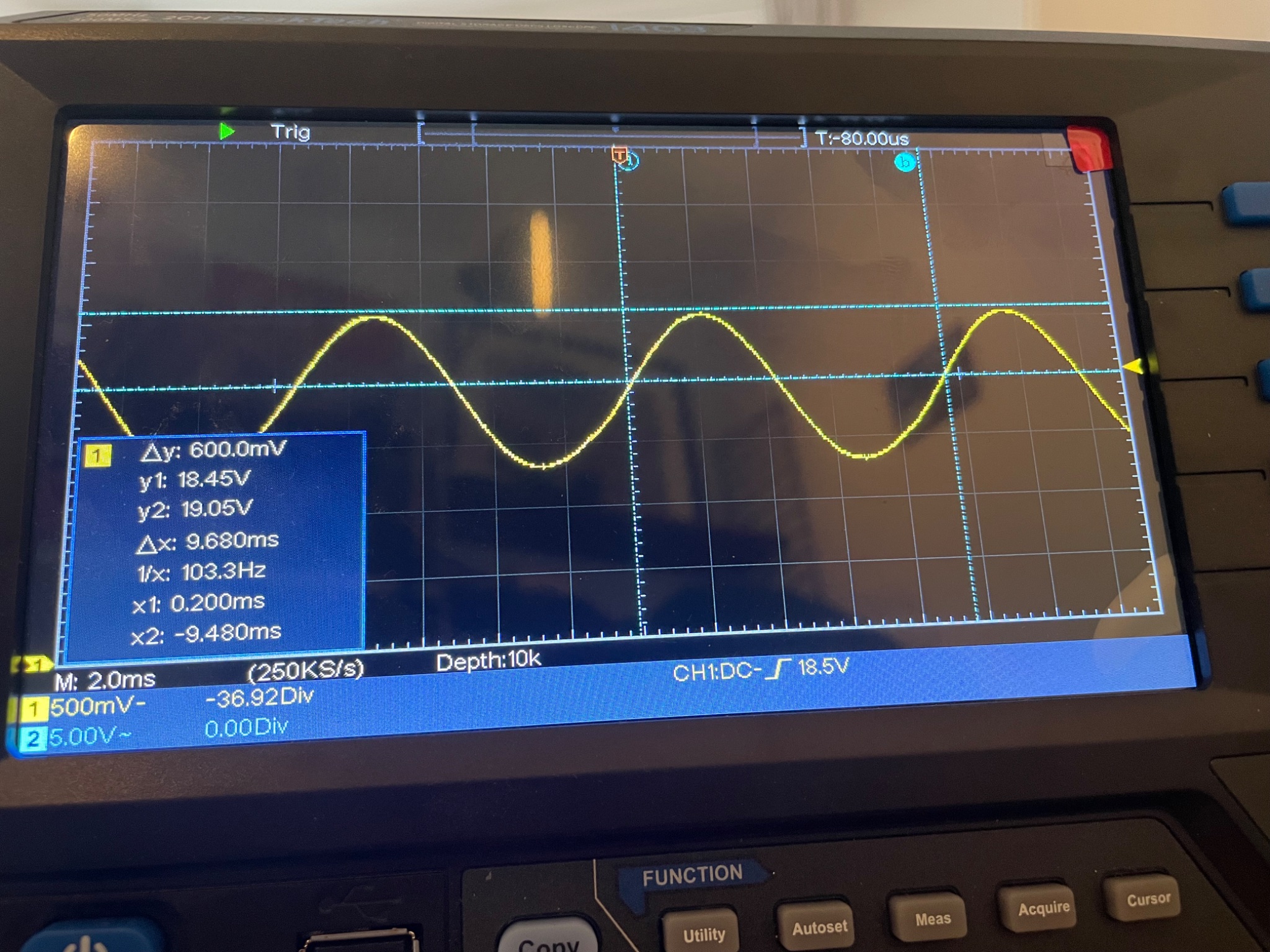

@Jo.es The FG should use 0.08mm magnet wire and 500 turns. The FG coils are differentially coupled and both wound CCW as viewed from the top of the bobbin.
Before you rewind the FG I would check the output of FG amplifier to see if it's correct for amplitude. If it's correct then perform the tracking adjustments. You may need to go back and forth a few times adjusting each pot to get it into specification.
The number of turns will affect the amplitude and if this is incorrect it could prevent the schmitt trigger from working.
If the output of the FG amplifier is NOT correct then I would rewind the FG.
  • Thank You
Reactions: Jo.es
Thanks a lot warrjon!
I just measured the amplitude on Point F with 33,3rpm. The time seems fine, but the voltage is wrong.
I also measured the
TR 101 E 1,6V (1,8V) B 1,7V (25V)
TR111 E 0,67V (0,6V) B 1,33V (1,3V)
TR112 E 0,17 (0,44V) B 0,83V (1,1V)
In brackets are the values from the service manual. That seems to be off a “little“ bit.
I just phoned a friend and he told me has a basic machine to do the coil winding. I will rewind the coil with the 0,08mm wire.
Will report if this is solving the problem.
