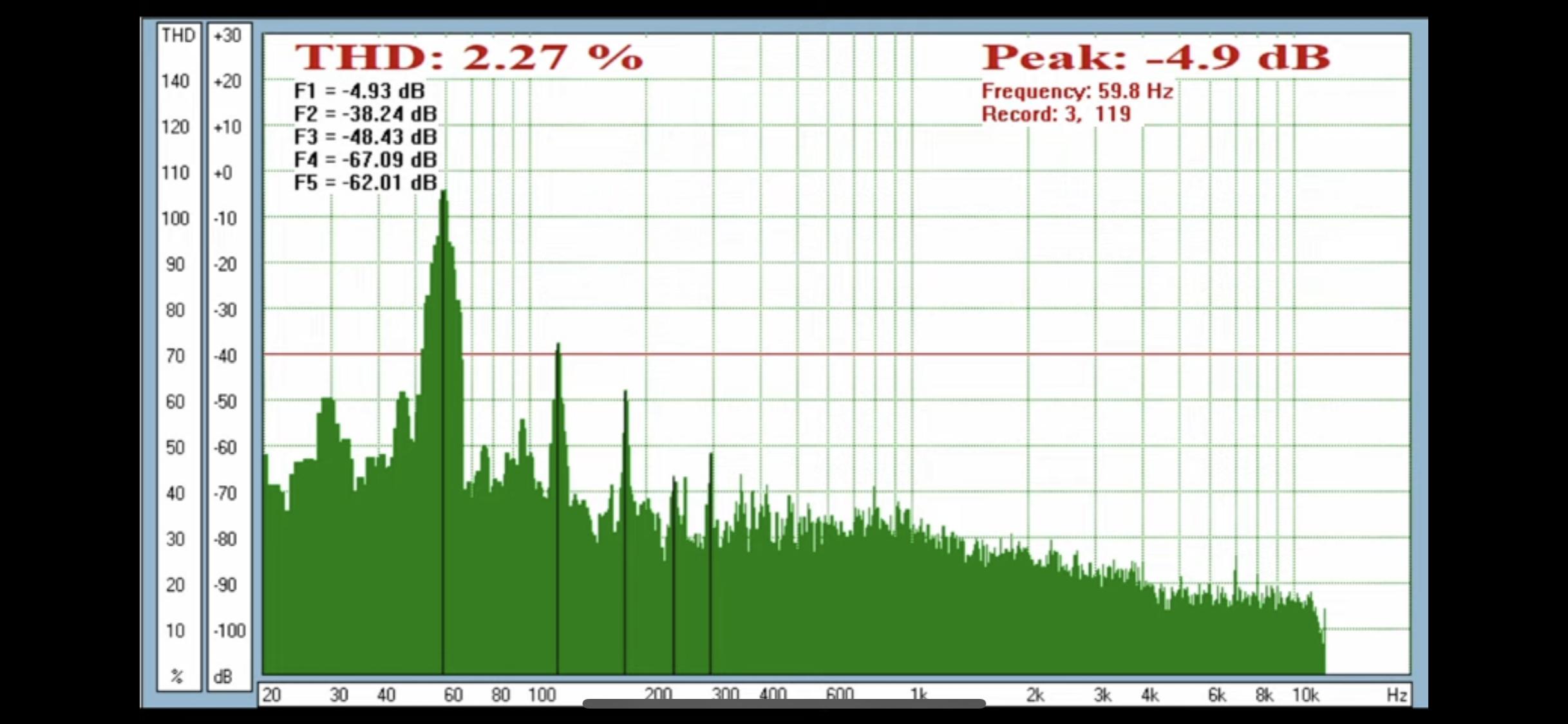

Current drive can have higher THD around Fs, but it is not the rule. It depends on the driver and how hard you drive it.If you go full xmax than voltage drive better. Back EMF acts like negative feedback linearizing a bit Kms and Cms large nonlinearity. Like electric motor if you load it, it will put more current to resist it. With current drive you don't get this. But this is important for large excursions (for very non linear Kms Cms part) I have measured better THD with current drive once down to Fs then comparing visaton BG20 vs Seas FA22RCZ. Just don't remember which driver looked better there. Of course it was not large SPL measurement.
So i think there is no one answer. Depends on conditions and driver. But usually around Fs makes sense to use voltage drive as Kms Cms nonlinearities should dominate there IMHO.
But lately i measured lowest THD around Fs with moderate output impedance about the same to driver impedance. So voltage has benefits and current has benefits, but where they meet is dependant on application , driver and use case. This is what i think around Fs up to Fs*2.
