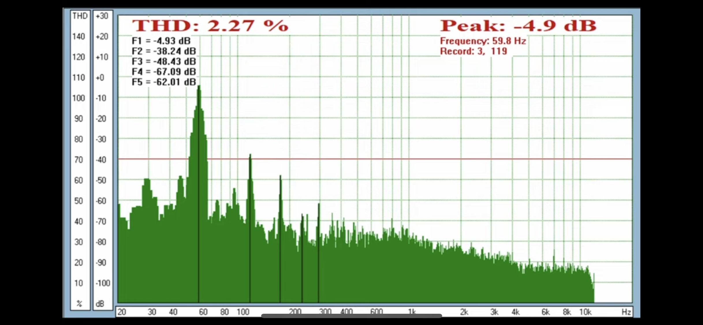

The harmonic distortion below (of a free air Td15m I think...) has a pattern up to F....cannot be changed with Eq, because its source isnt electrical
These patterns of thd look just like the patterns found in the impedance chart of a cd+horn....I think it has some kindship. These patterns in the thd are surrounding a "harmonic mode" like in a horn but different source
So anything to lower F helps...is where this is all leading...like potentially isobaric, lol yet, I think I caught that within low xmax le dominated...so if you create enough sd to keep xmax under 2mm in bass reproduction then what? I'd imagine lower excursion is the key for all areas of bandwidth
First thing to come to my mind was tuning choices, to address where F is...
The second thing to come to mind was isobaric, which doubles Bl, halves cms and lowers f...halving le doubling le depending on series vs parallel

We just got done entertaining the reasons why BL, F, le, cms, etc are important versus excursion...
I think I found a trend I'd like to explore but I just wanted to specify that the thd graph above appears to be in a ported cab...I thought it was free air at first, but non the less it reminds me of a horns impedance and thd reading...where as thd is reflection of excursion...I'd think that there is a similar excursion expression nearing tuning looking at horns vs bass reflex vs TM.
Unlike the horn, you cannot see the impedance fluctuate...but yet thd is oscillating as we near tuning...I need to very if this happens in a sealed cab and free air as well.
