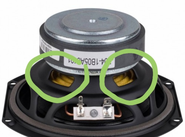

SDS woofer shown in post # 181
Could be considered cheap...I guess.
Has vented spider and bumped back plate.
And large mounting ring.
So actually appears to be rather good.
Going to cast frame would not be much of difference.
Since a lot of the magic of cast frame is heavier mounting ring.
Easily reproduced as shown by making the stamped frame
with a larger mounting area.
They Figured this stuff out way way back in the 80's
Seems pretty well designed actually.
Midrange duty would be rather good thermally.
Since spider is vented. The bumped back plate is likely
to increase linear travel for bass.
Not always a concern for midrange.
But venting the spider likely also for bass ( more heat)
can be beneficial.

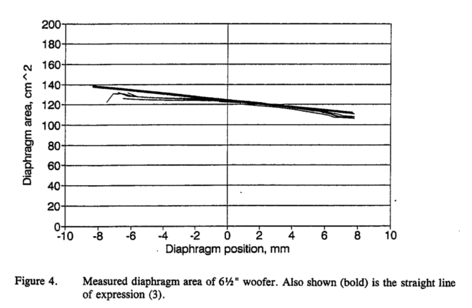

@lrisbo I do have a question about Sd(x)
So my first initial thought, was that it would have a major impact on Vas as well, since this is proportional to Sd².
However, I realized that this is not the case.
To make things a bit easier for us, here a visualization from that paper;
We get a graph where the Sd is smaller going outwards and bigger going inwards on respectively to max and min of a (single) sine wave.
This is fundamentally different compared to non-linearities like BL(x) or Cms(x), where the graph is symmetrical.
Aka; dip (or rises) on both sides.
Or in other words, the values will change equally on both sides of the since wave.
Meaning that the actual value has changed at these greater cone excursion, since the actual value is the average between (+x_max + -x_max) / 2
I think Klippel calls this the effective value if I am not mistaken?
However in this case, the value of Sd won't change, since (+x_max + -x_max) / 2 = equal to the rest position of the Sd (more or less)
I guess the only place were modulation can occur in this case, is when we are at the maximum of the cycle and at the same time have some other stuff going on.
But I have a hard time picturing that as modulation, since only half a cycle later this is totally gone again?

Can you write more what you mean? Intuitively with given x smaller Sd makes less volume displacement, which means less SPL. Higher Sd means more displacement and more SPL. Acceleration of cone is max with maximum cone travel, and since acceleration means SPL then SPL is higher on other half of sinewave and the other it's lower. If you picture SPL as sine wave on oscilloscope it's looks like poorly biased class A amp, one side of sinewave doesn't get as far as the other. But which harmonics is it, or series of?
But it's not just the excursion creating frequency that is affected: while say 50Hz makes great excursion to one side increasing Sd, a 1000Hz played on same woofer makes ~10 loud cycles, then ~10 quiet cycles, within one 50Hz cycle so the whole bandwidth is having amplitude modulation. And, since low frequencies need more volume displacement to get certain SPL, then say 10% change in Sd makes less difference to volume displacement on lows as the x is high, but on highs the required x for given voume displacemetn is lower due to high Sd, so Sd modulation makes relatively more difference the higher the frequency? Fun to imagine stuff 😀
See picture couple of posts back.
So when the excursion is at positive excursion maximum, the Sd is the smallest.
When the excursion is at negative excursion maximum, the Sd is the biggest.
Meaning that the average between the two is just (Sd_max + Sd_min) / 2 = Sd.
Which is different than say like BL(x), there the BL drops at positive maximum, as well was negative maximum.
So within the same cycle, BL drops twice at both maximums (or max and minimum, depending how you look at this problem, but that's the same thing)
So I think from a low frequency perspective, we don't really have to bother about a change in Sd, since positive and negative changes cancel each other out.
With mid-range frequencies I am just not entirely sure how to picture this myself to be honest?
Since on average there is no offset and modulation like BL(x), the only modulation I can picture is that there will be a difference on the positive side of a sine wave vs the negative side of the sine wave.
From a thought experiment, we can't just change the Sd for the radiation area, since like I said, the average is just the Sd
Because of this phenomenon I also have a hard time picturing that it can be that significant.
Since mathematically it doesn't add up as bad as when changes happen on both sides of the cycle.

Aah yes I ment radiation area, used Sd there.
I imagine it like this: since ~all frequencies of the source signal on the woofer bandwidth output at the same time so it's too simple to think just one sine wave that makes the excursion, but also thinking it all at once is to complicated. Hence I like to take low frequency sine wave and imagine it making big excursion, and then another sine wave at high frequency and imagine that too.
If both the low and high sine waves make say 90db of acoustic output at the respective frequency, the low frequency wave has to make huge excursion, say +-1cm while the high frequency wave makes almost none, like +-1mm. In general, excursion must be different, because effective cone area for both is the same. Now, slow down your mental video on this so that the low frequency cycle lasts like full ten seconds or so, you see the cone slowly moving, you see the surround tensioning with the movement. Now picture the high frequency there as well, making much faster and much smaller vibration on top of it, as if the highs just ride on the lows.
Now it's "easy to see" in the video in your head ( 😀 ) how when the cone is at full swing to positive excursion the effective cone area for the high frequencies gets smaller as well even though the highs makes way less excursion. Respectively, when the cone as it full negative excursion the effective cone area for the highs is bigger. The highs play multiple cycles while the low makes it slow paced one, and hence is amplitude modulated.
I guess you could take the average Sd for lows, if you consider wavelengths and room having an effect to sound. But, imagine you input perfect kick drum hit with only single positive amplitude impulse, now depending which way your cone moves the peak either compresses or expands the original signal depending whether the effective cone area increases or decreases. Of course this is very simplified imagination model as well because overtones and all, kick drum hit is not just half of a sine wave, which would make their effect perhaps before max excursion. Anyway, fun stuff to imagine 🙂
