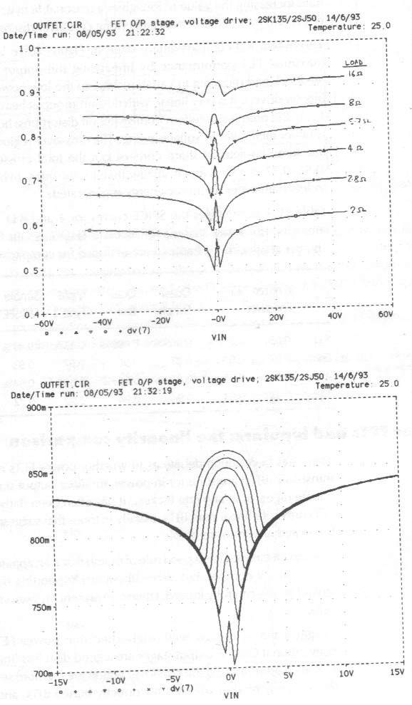

jupiterjune said:devices in my A-75
The devices in the A75 likely have half the Ciss/Crss values of the ones used for these curves, don't you think the curves for the A-75 devices will be at a different distortion level?
The most interesting part is after the transition to Class AB, where the distortion level for the 0.25A curve still remains at 1/10th the level of a regular AB single compl. pair output stage.

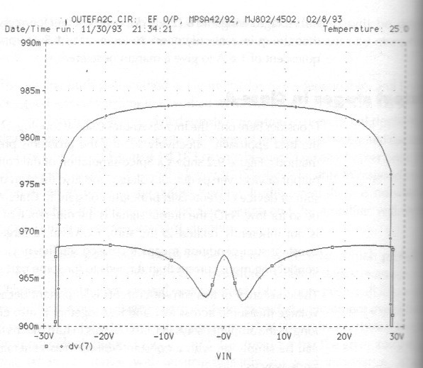

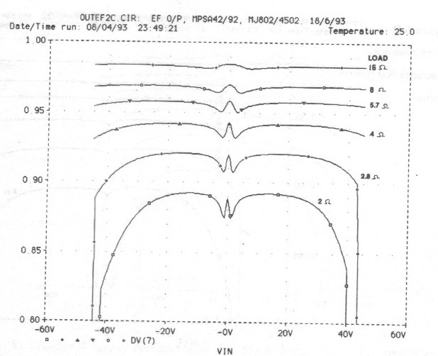

I cannot find the data of the bias current of those graphs. It is from DSelf book, but it seems that he believes in the voltage drop accross RE degeneration more than the bias current.
This graph is from the exactly same cct, the upper is when the output is classA (biased at 1.6A) and the lower is at the "optimally biased classB"
The classA graph has relatively steady gain between 0.980-0.985, while the lower is very curved (especially around 0V) and the gain is always less than 0.970
It's a good clue why Papa likes classA 😀
