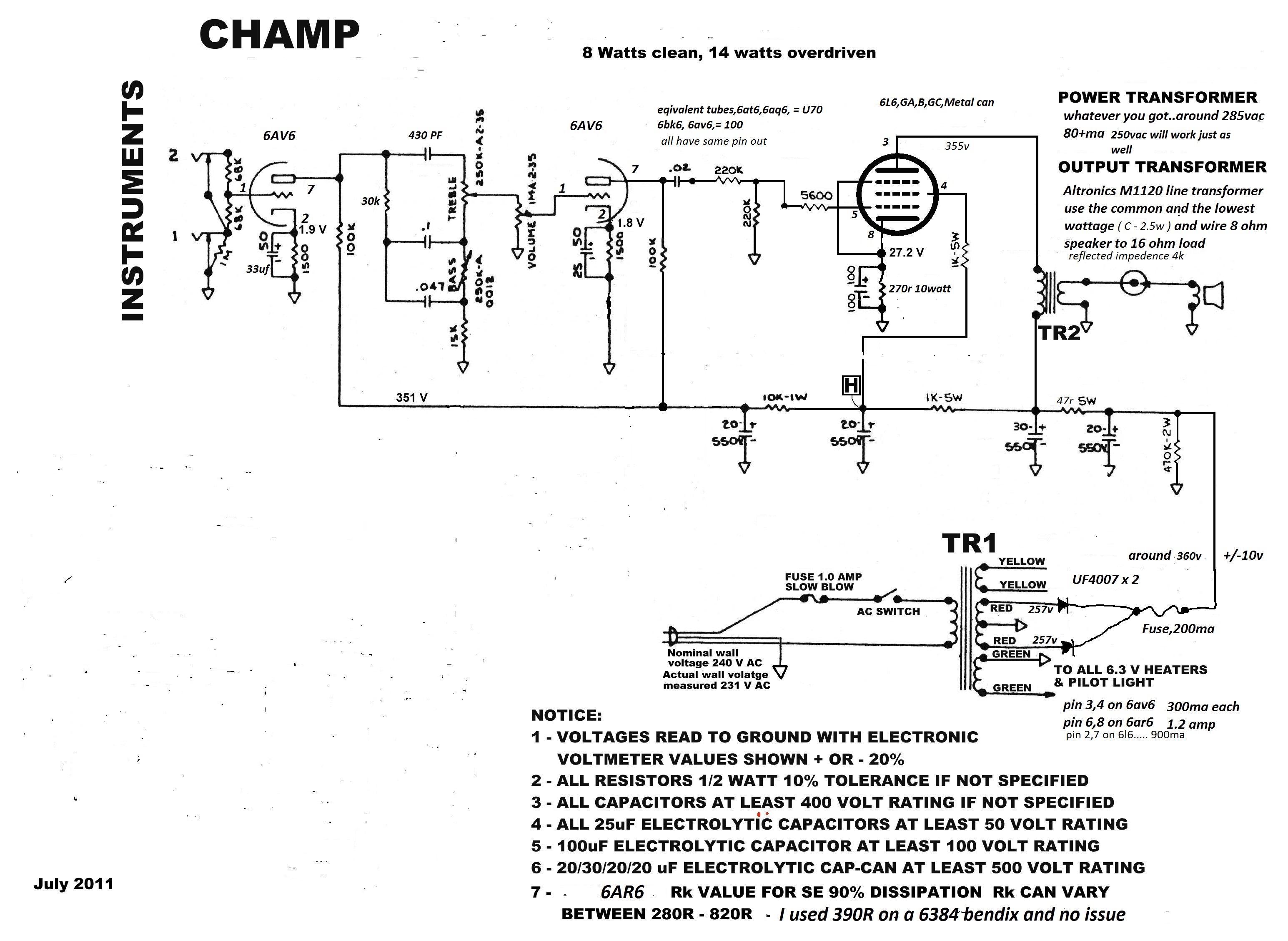

Hi....just thought I would update the progress of the amps....I preferred the 6L6 over the 6ar6 amp so I converted the 6ar6 to 6L6...6ar6 has its own merits though
the m1120 tranny is a little shy of bass so some mods had to be done to bring the bass through...as a guitarist you want that thud when you palm mute...a must for modern sounds
but on its own it would make a surprisingly good stereo amp (my next project is a stereo amp for my I pod )
I use them as a stereo going into my Quad box (which has mono / stereo switching) and my pedal board has stereo mode as well and there is nothing cheap or nasty about the sound coming from them....totally PRO sounding 18 to 25 watts all for less than $200......there has been mention that the metal can 6L6 as dangerous or bad sounding on other threads over the net.......total crap !!
updated schem attached...enjoy 😎

I'm impressed it (the M1120) can cope with 100 mA of DC current!the m1120 tranny is a little shy of bass

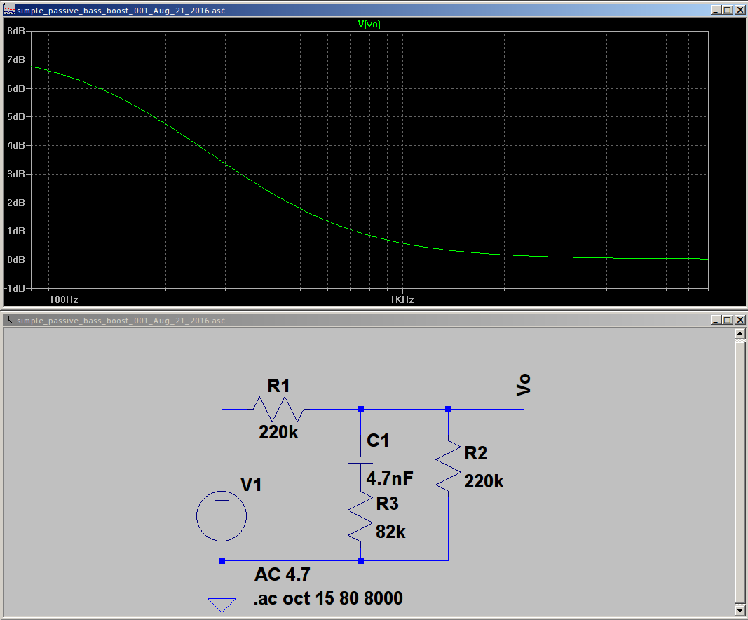

the m1120 does handles the current fairly easy ....barely heats up at all in SE conditions....my concern was getting bass out of them being light on iron
As I thought they are a little light on bass for guitar use.....but you can make adjustments in the tone stack....more capacitance in the cathodes etc
and it worked.....to a degree........for me its enough but for others maybe not be enough....neither do they lack for loudness....two used in stereo is giggable and most important of all......they are enjoyable to use
see the schem...if you can find a simple way to induce more bass let me know

One easy way is to add a series resistor and capacitor in parallel with the existing 220k grid bias resistor of the 6L6. The other 220k resistor (going to the 0.02 uF cap) in your schematic also plays a part.see the schem...if you can find a simple way to induce more bass let me know
I'll attach a screenshot. The 82k and 4.7nF (same as 4700pF, or 0.0047 uF) are the two new components. The graph shows what LTSpice thinks the frequency response will be - a gentle bass boost, with a +3dB corner frequency at about 300 Hz. I've plotted from 80 Hz to 8kHz, which is what matters for guitar.
If you want, you can tinker with the R and C values to change the frequency response to suit your taste. Reducing the 82k will increase the total amount of bass boost, but at the cost of some overall gain loss. Reducing the 4.7nF cap will move the boost up to higher frequencies.
Keep in mind that, at higher volume levels, boosting the bass may cause the output transformer to start to saturate. Once the transformer starts to saturate, it puts out even less signal (bass, in this case). So the added bass boost may only work at lower volume levels.
But it's easy enough to try, and if you don't like it, easy enough to undo!
