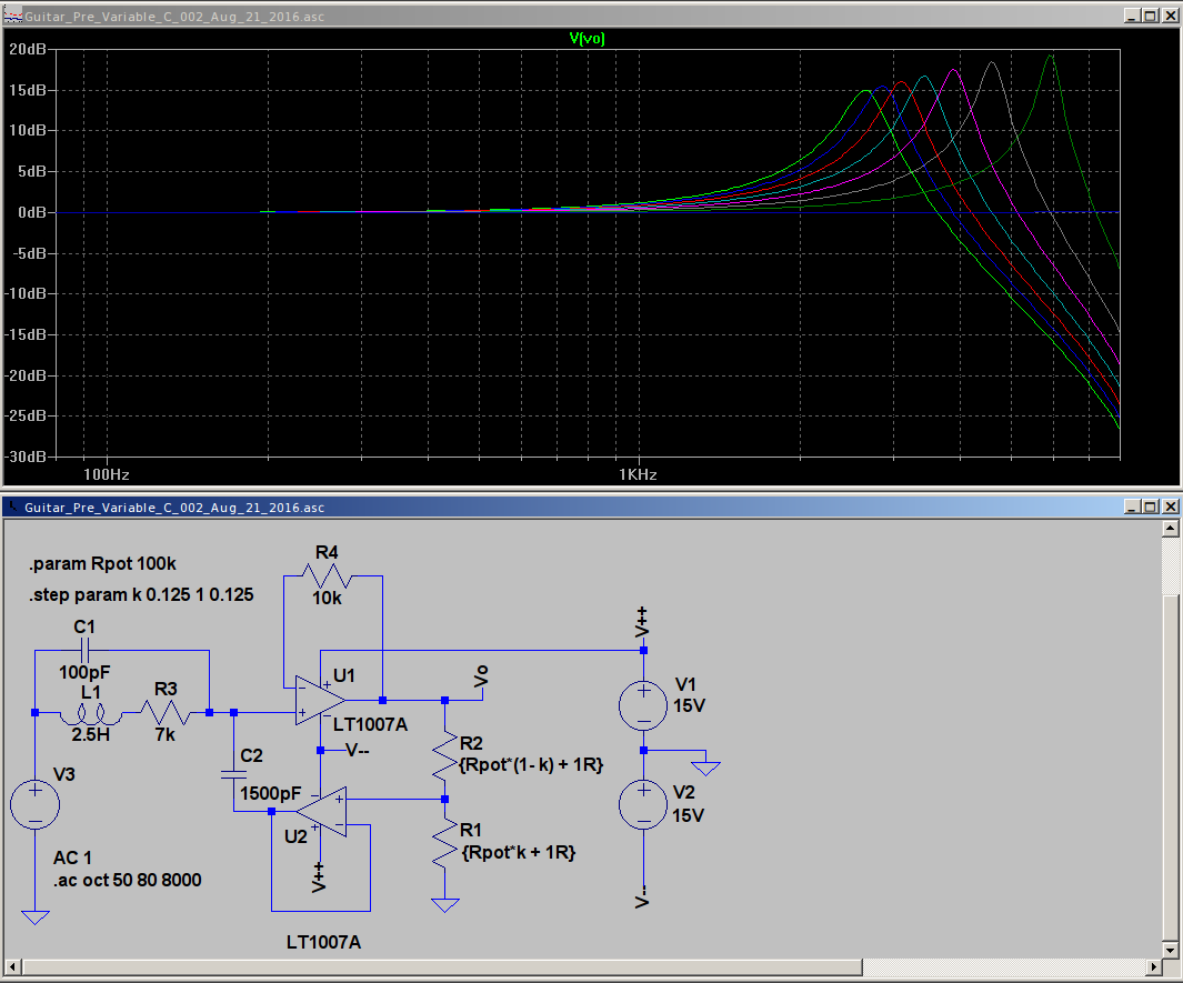

Now that Voltwide reminded me of the variable capacitance technique, I couldn't resist quickly throwing a circuit together in LTSpice.
Roly Roeper's version used a JFET, but I implemented the same idea using a couple of op-amps instead. The near-ideal behaviour of op-amps made things very simple, avoiding some possible issues in Roly's JFET-based circuit.
In the attached schematic, R1 and R2 are the two segments of the potentiometer that tunes the amount of parallel capacitance seen by the pickup. Their junction is the wiper of the pot.

Oh, I believe you! 😀Which is exactly the same principle I described and found on the VOX-Wah long time ago😉
(Roly never claimed he was the first to invent the idea, but it was new to me, so I thought it was his.)
