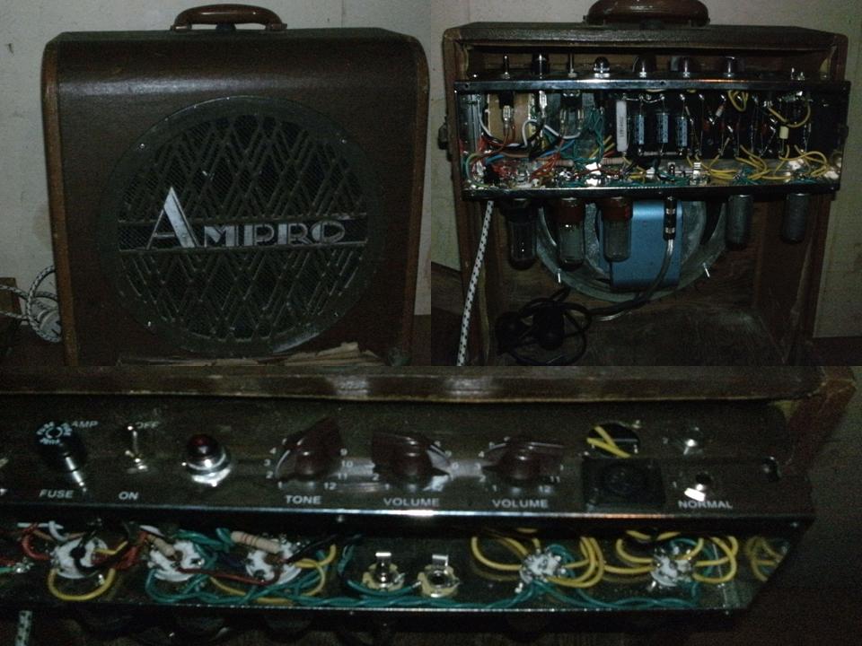

Yup, old radios make great chassis for small heads. I did my AX84 SEL in one.
http://jazzbo8.files.wordpress.com/2011/11/img_1163.jpg
More about it here.
End of shameless self-promotion...

Nice, Jaz. I also have an old radio, maybe someday...
Gracias! Since I don't know how to make real guitar cabinets, that's about the quickest and probably least expensive way (at least for me) to get a decent looking finished amp.
