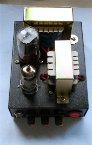

Hi...
I designed a guitar amp that costs, here in Brazil, around U$50,00 to build.
I used as preamp an EF184, and as power a 25L5. They give me around 2.2W.
The power transformer i used a 30+30V 800mA, with a doubler for HT, and heaters in series.
If someone wants to take a look...
100Buck.pdf - 4shared.com - document sharing - download
100Buck002.MP4 - YouTube (a very quick and simple sample of the amp)

Cool, sounds good also. I did not download your schematic, they want you to sign up and I would rather not.Hi...
