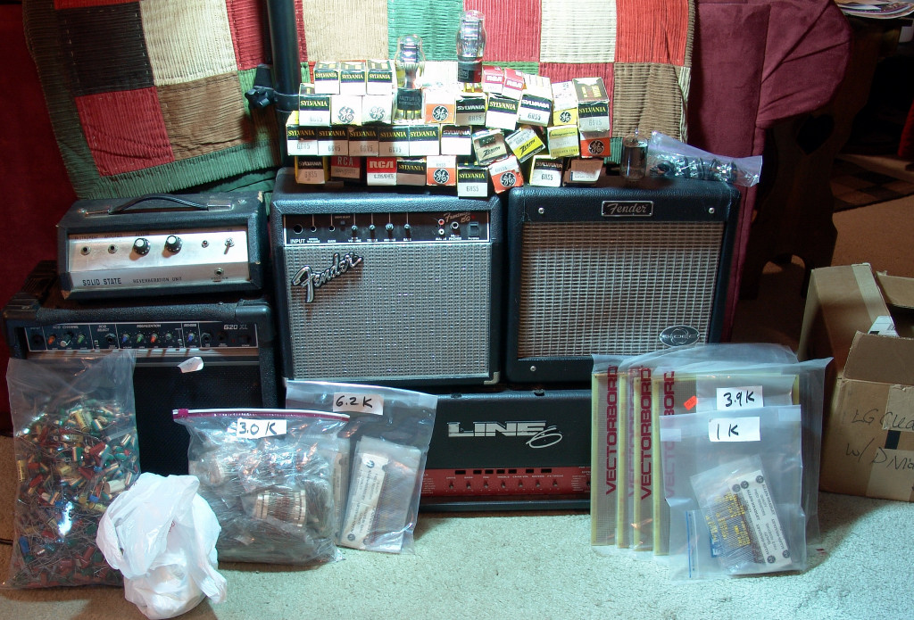

I went to the Orlando hamfest a few weeks ago where I bought 5 dead guitar amps for $5 each.
Whoa!

Whoa! You are just trying to make me jealous......Love to go to some hamfests soon, may be on my next trip to the States, where are the "big ones" held and when?
There are local hamfests scattered all over the country usually timed to coincide with reasonable weather since many are outdoors. Here in Florida they are usually in the winter. Further north they are in the spring or early summer. Some are small parking lot shows for a few hours, a few are huge spanning 2 or 3 days.
The three biggest are Orlando, just happened (Home), Ham-Com in Texas on June 8-9 (Ham-Com | The Biggest Hamfest in Texas) and the mother of all hamfests in Dayton Ohio on May 18-20 (Dayton Hamvention). I usually go to Orlando and Dayton but have never been to the Texas show.

A picture of the Orlando haul:
Thanks! Hope to make it to at least one of them in the near future.

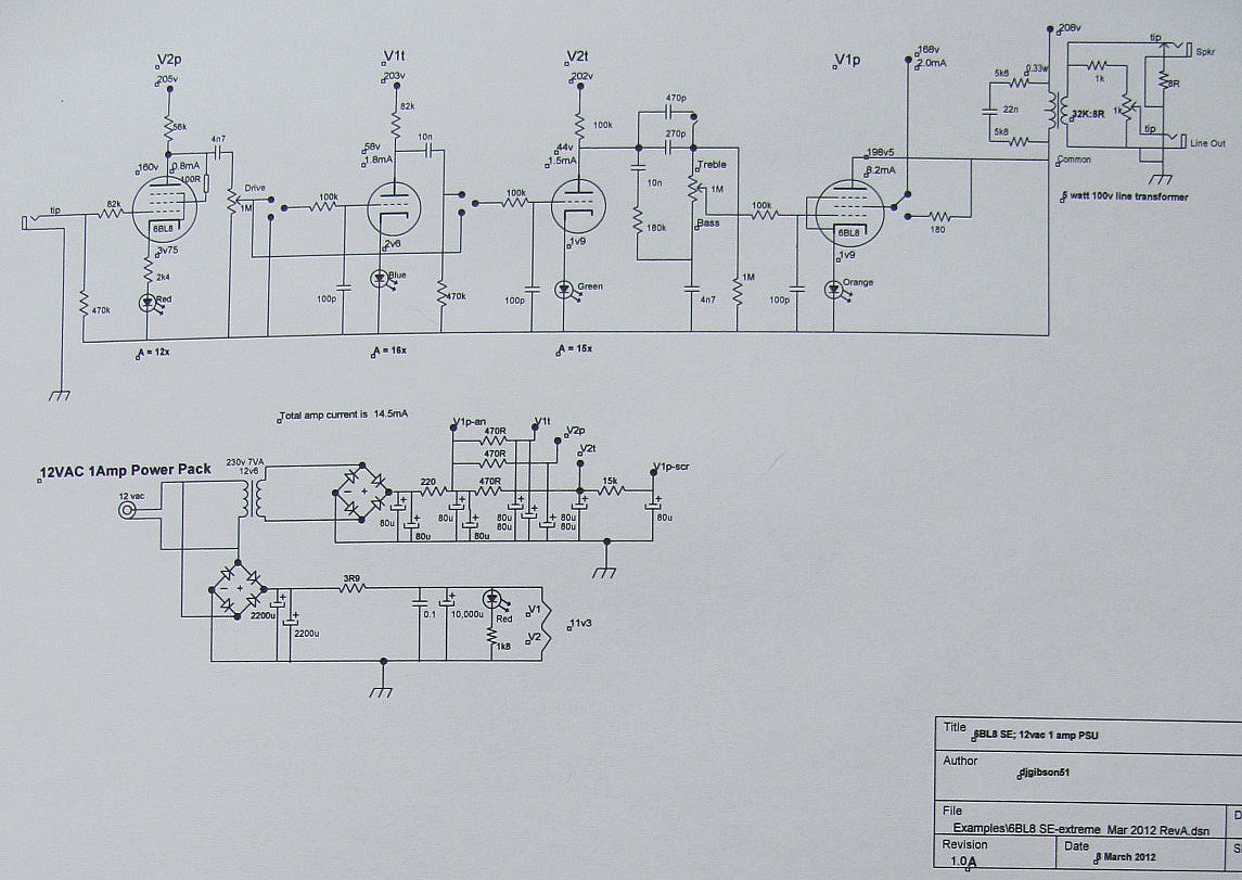

Only two tubes - sustain for days
The single ended 6BL8 output pentode starts clipping - more or less top and bottom - with a peak to peak 2v signal at the grid.
This is achievable with drive set below 4 o'clock and 1st triode out of the signal chain.
I can get happy chords and not too much yelling from the neighbours at this setting.
The 2nd triode clips (grid current) a bit before the output stage if signal is big enough - so switch in 1st triode. This setup gives sustain for days at a range of settings.
Current feedback in first stage is mainly to get the gain down to likable levels - tweak to taste. (The red LED is only an indicator that current is flowing in the tube - handy when prototyping). The other LEDs were selected to set the bias of their respective tubes - they got swapped around a lot during development.
If my wife goes out, and I shut all the doors and windows, the neighbours don't yell (they do go very quiet though).
Through my 12" 96dB speaker I am immersed in the sound but don't need ear plugs.
Yes it is not a single ended trafo but with under 10mA current I haven't detected any signs of saturation with the little 5 watter.
NB: Heresy aside, switchable silicon &/or germanium clipping pairs of diodes at the input of 2nd triode give further range to the tone pallette. Not better, just different (more civilized even), and still endless sustain. Good enough to leave in.

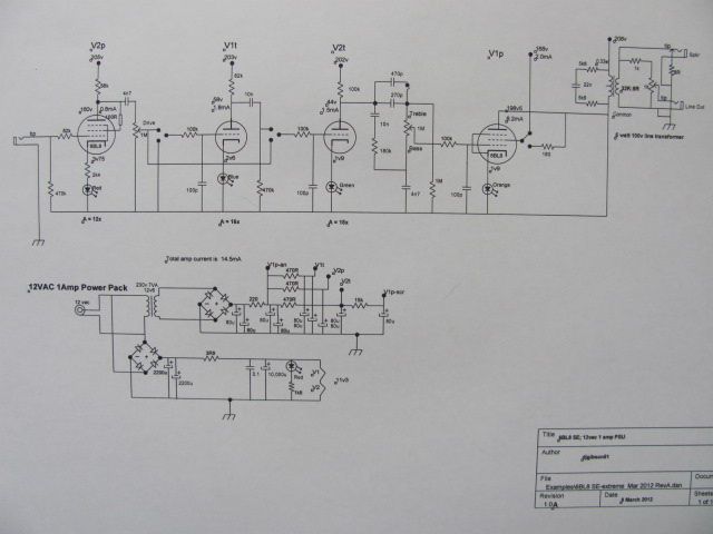

Going to button this one up cos its fun just as it is.
Now for my next trick: Maybe pentode/triode pot (Merlin's version) on input stage, and cathode follower driving the tone stack. Same two tubes cause they are cheap and easy to get.
JimG

So I am pretty much done with the circuit. I probably could spend hours adjusting the screen voltage, changing the capacitor and resistor values, not going to bother. The amp sounds good enough and does not get too nasty. The output cathode resistor is a 220 ohm, changed the first bypass capacitor to a 1uF and the coupling caps before the output tubes to 0.0068uF. Otherwise the circuit is as the schematic. The resistor value for the preamp filter got cut off, it is a 3.3k. Need a few holes and screws and it should be good to go.

Much better, thanks.Sorry about picture - still struggling with the technology😱
Normally I have the tube on the schematic, not sure what happened there. I have 12AQ5's, a 12V 6AQ5, and the transformer is a run of the mill 10 watt 70v line transformer. I just want to tweak some capacitor values and try fixed bias on the PI, might even change the screen resistors lower just to hear the effect. The amp sounds good clean, it does have a bit of a problem with too much bass content when you crank everything. I went to a 1.0uF capacitor on the first bypass and it helped. Going to try 4.7nF after the PI.
Thanks, also what is the switch on the plate of the PI for, sorry if this has already been covered before... 😱
