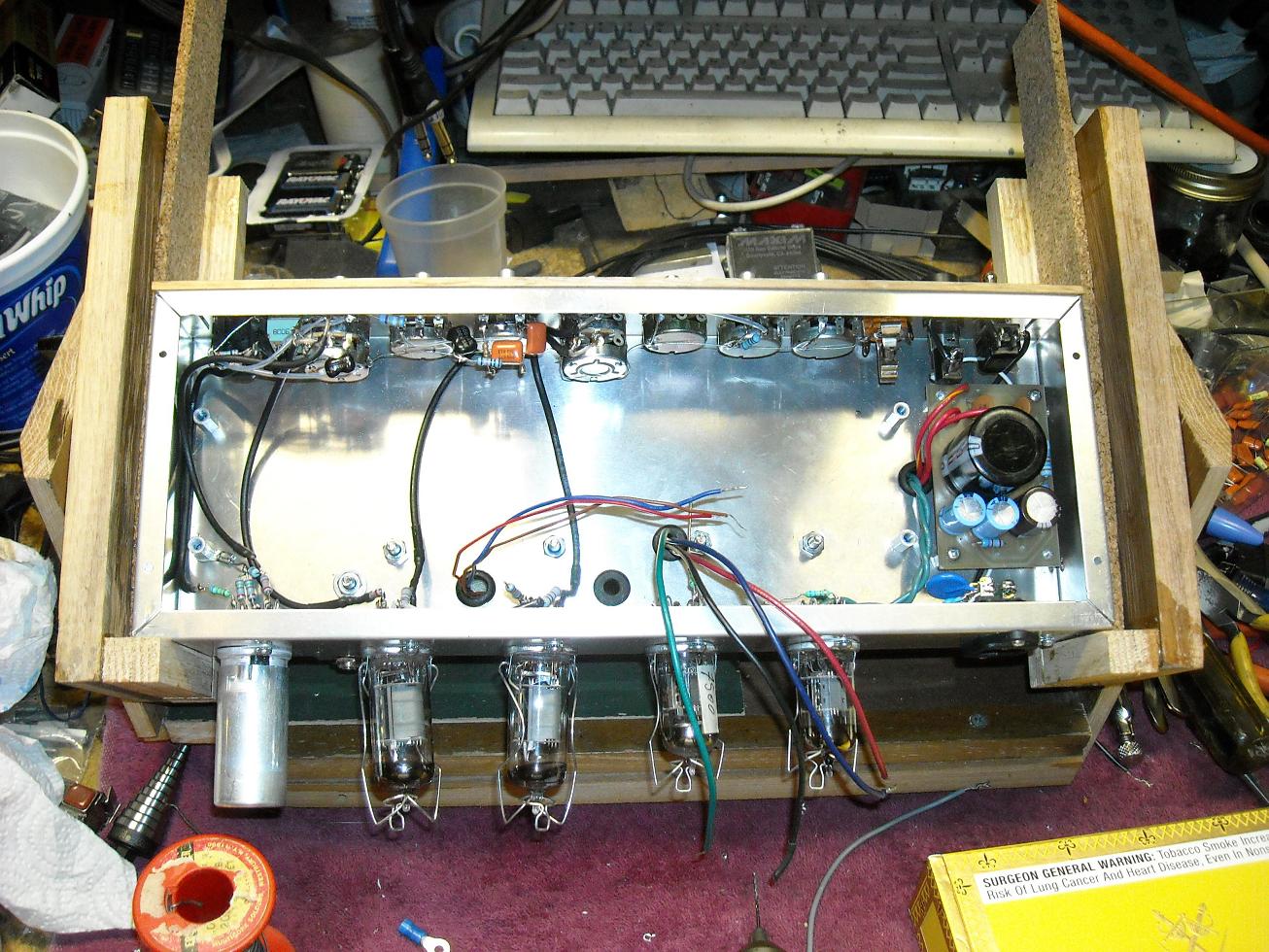

I've just about finished wiring all I can before adding the tagboard.
Progress has been slow as I stopped to make a cradle to make wiring easier.
The tube sockets aren't completely mounted, hence the odd angles.

@ Printer2:
Looks like it's between your second stage and phase inverter.
Do you want to put it somewhere else? If so, why?
Or are you asking for confirmation that this is where it best goes?

@ The Gimp:
Looks like maybe you've got five gain stages, too, like I do.
But you've also got five filaments. What are you using to heat all those tubes?
Also, I've considered using a dual-pot to tame the volume somewhat when gain is up. Is that what you've got there in pot #3 (left to right)? Or do I see seven pots, not six? And TWO duals (#1 and #4)?
Please enlighten us on this. (Apologies if you already did and I haven't read it.)
Secret ingredient #2, I wired them all in series and hung the string across the B+ supply. No heater winding....no heater transformer.
