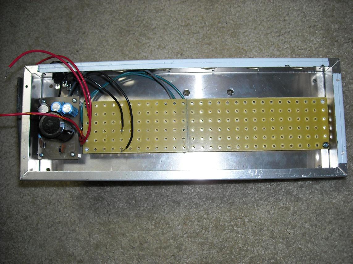

I'm still fiddle-farting around with trying to get the full amp (with parts that push it over the top) into a chassis.
I think I can get everything on a tag-board that fits since I put the Power supply on a pcb today.
