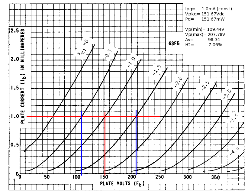

You have to be careful in drawing these comparisons. The 6AV6 isn't quite the same as half a 12AX7. For the 6AV6: Pd= 500mW; 12AX7: Pd= 1200mW.
There could be other differences as well. The 6SF5 is another one of those types that seem similar to the 12AX7, but it's not (attached). Even with a CCS plate load, the H2 estimate is hideous (and would only get worse with passive plate loading). This is even worse than the 12AV7, and I didn't think you could get much worse than that. You can definitely help the linearity of the 12AX7 with active plate loading, and a good many of the reports of sonic under performance of this type relate to plate loads that are way too small. Here, that's as good as it gets.
The 6SF5 was designed for use as a first preamp for AM BCB receivers, and that's a distinctly Lo-Fi application. About the only other use for this type would be in a guitar amp. You'd never want to see it in any design where sonic excellence is the design criterion.
