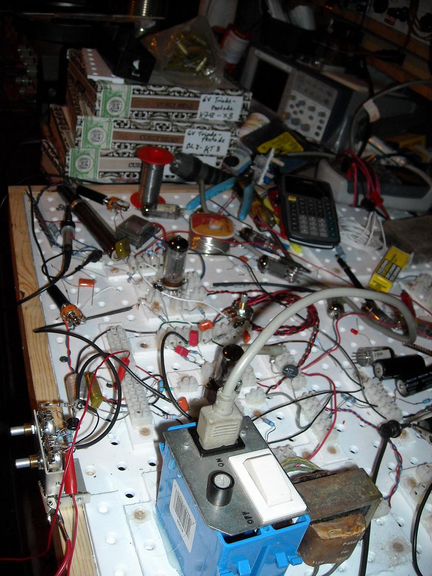

Aha a shower moment.
I realized it had to be PS related and not a tube oscillation as it is too low. So I stuck a 5uFd cap on the power terminals and it shifted to 65KHz.
I had tied all the B+ connections together and was getting PS feedback from the output stage loading the supply as it is on a tube lab breadboard.
I'll fix it tomorrow night (or this evening actually).

The thought was for future expansion, but after blowing things up twice last night, I have decided to just get the one channel amp working. The +/- 12 Volt supply has been abandoned for now.
I'm up to 147MHz on the oscillation. Time to try a cap/resistor across the anode resistor. I suspect I may be picking up the local 2M repeter.
Anyone find a low cost inductor for the power supply? I'm considering re-stacking the lams in a $4 xfmr, but will be a pain in the A--. For special effects, I have decided to make the amplifier clean, but include a $1 beam deflector tube for dial-in harmonic generation.

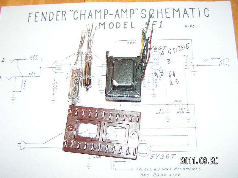

finished 5F1 clone, uses 12W6 tube output, 12ax7 pre and 5y3 hybrid rect:
Sub-miniatures... I am intrigued. 🙂
Take a look at curves: should sound almost like 12AX7 and 6V6.
I have a friend that has been looking to build a cheap practice amp. I was thinking of a 5F1 circuit but using a 6AY11 in place of the 12ax7 and using the beam pentode of the 6AL11 as the output tube. Total output power will be lower than with the 6v6gt but with a total of $2 invested in tubes he can purchase a few sets to keep around. A cheap edcor SE transformer and a suitable power transformer from either edcor or perhaps antek.

I have wired up 3 of the 5 tubes in my amp so far. The 3 easy ones, P-P output and PI. Nothing blew up, but there is some 120 Hz hum. I fixed it for now by adding a 470 uF cap from B+ to ground. It's to expensive for the final design. A few resistors are getting too hot to touch too.
I get a whopping 3 watts at 3% distortion. Frequency response is +0 -3db at 32 and 9000 Hz. I am using a 12 VA heater transformer for an OPT. I will try the P-T291 tomorrow.
I haven't measured distortion, but from the waveform on the scope I think I'm hitting 1.02W at about 10%thd into 8 ohms with a junk transformer, It looks like mostly 2nd harmonic.
