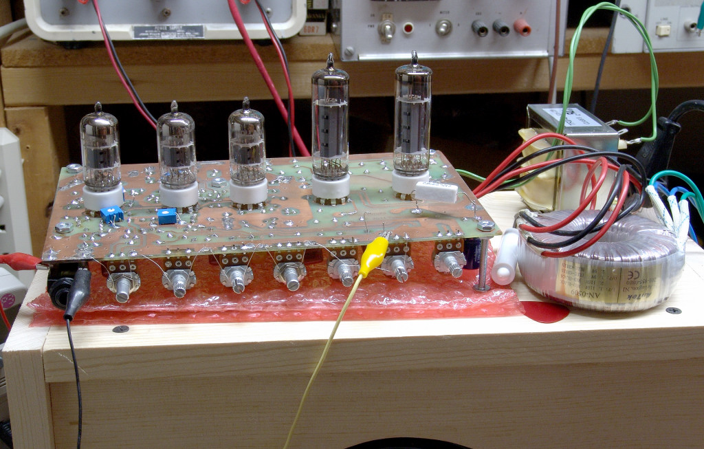

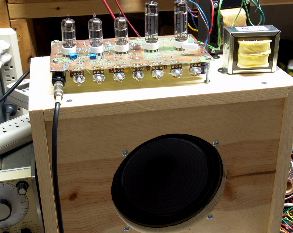

I looked back into my original HBAC directory and here is the list of tubes I was considering for the "big" amp (20 watts for just under $100). The "little" amps all used 7 pin tubes on the $1 list. All of the tubes used in my 4 watt "big little head" are STILL on the $1 list. 4 tubes, $4. OPT, $5. Power transformer. $16, all the other stuff, cheap. The chassis is the most expensive part. What's not to like.
The big amp used 9 pin tubes in odd heater voltages, all wired in series running from B+. The same tubes are available in 6 volt flavors, but some have gotten expensive since the HBAC happened.
For preamp tubes I looked at these, all have the same 9AJ pinout:
The 6BK7, 6BQ7, 6BZ7 trio (now $3 or $4) with a Mu in the 40 range. The 3 and 4 volt versions of some are still $1, wire 3 or 4 in series on a 12 volt winding.
The 6DT8 ($3) is very close to a 12AT7 (Mu of 60) without the heater tap, but the 12DT8 is now $7 or more since it fits many old radios.
The 6JK8 ($3) is an oddball, it has two different triodes inside, but both work well in guitar preamps. One has a Mu of 50, the other has a Mu of 70. There are 8 and 17 volt versions for those of us that wire heaters in series or use laptop bricks.

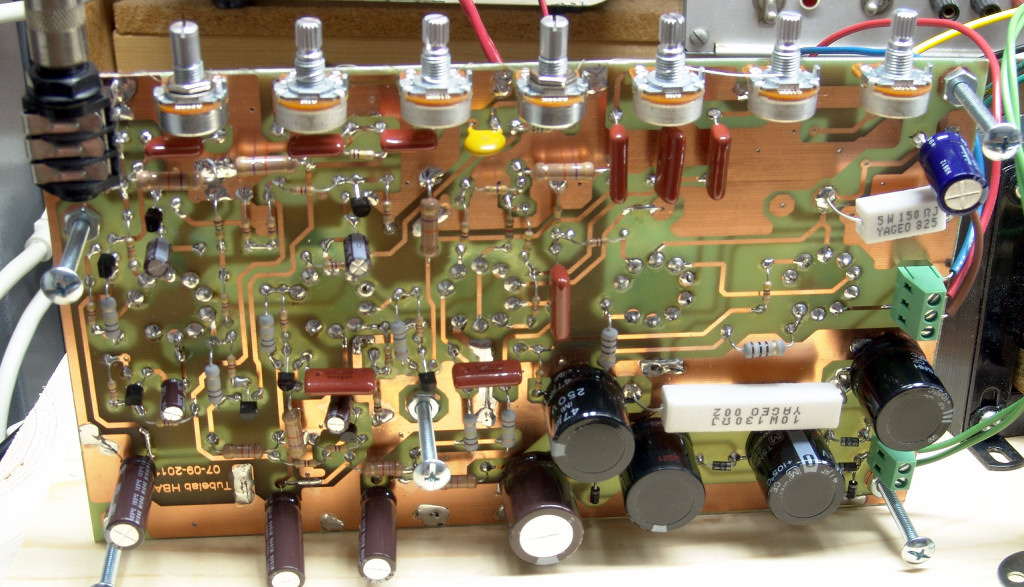

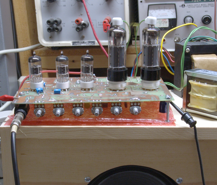

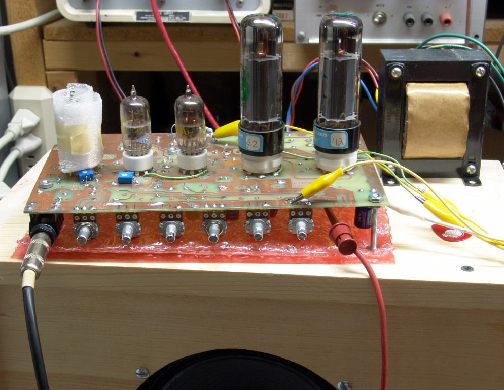

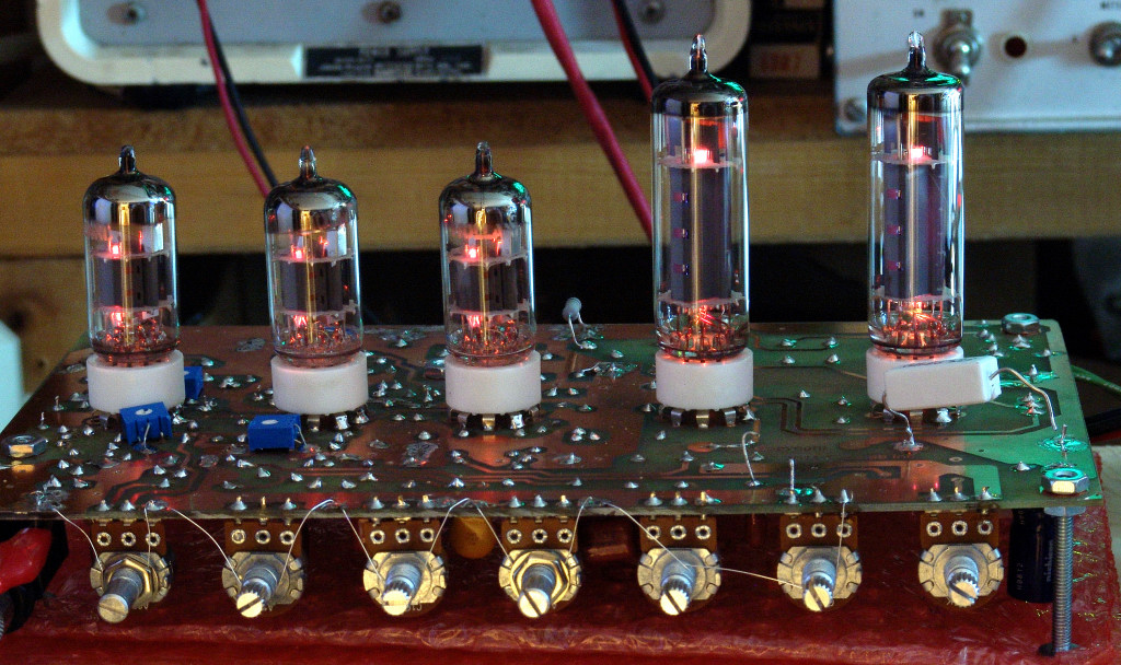

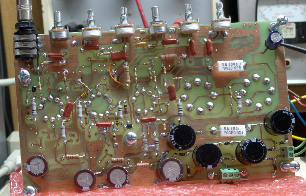

The tube I wound up using was the 26AQ8 / UCC85 (Mu is 50). I got a bunch from Stan for $2 each (now $4) and wired them all in series with a pair of $2 (now $5) 45B5 / UL84 which is a 6CW5 with a 45 volt heater). Unfortunately the 6volt version has been discovered by the audio world and run up to more than $15 each.
Thinking that a Mu of 50 was half that of a 12AX7, I used 3 tubes (6 gain stages) each with mosfet buffering. That turned out to be WAY too much gain, so I bypassed two or three gain stages, and removed most of the mosfet buffers. That resulted in a very useful guitar amp that's still around, but hasn't been used much since 20 watts in a concrete basement is loud. The little 4 watt amp is the one that sees constant use.
I got it all working with a real guitar amp OPT, then switched to an Antek power toroid for the OPT. I lost a watt or two in that trade, but the tone was pretty much the same.
For fun I created a second board that used octal tubes. I was planning to use the 26AQ6's with some 50JY7 TV sweep tubes that I could get for $1 but someone bought all that Stan had before I got the board finished. I finished the board, and did what every guitar amp hacker would have done, cut up some traces, rewired it a bit, stuffed in some 12AX7's, and EL34's and made it into a tiny Marshall clone. It's still running 6BQ7's in the picture.

The ideal load for an "ideal" triode vacuum tube is a constant current source with an infinite resistance and an infinite AC load impedance. None of these can be achieved in the real world, but we can do better than a resistor from plate to B+ and a cap into the next stage with its grid to ground resistor.
We can replace the plate load resistor with a CCS chip, or a discrete mosfet or BJT CCS. I have even seem vacuum tube CCS circuits used, although a mosfet is simplest and often close enough to an ideal CCS, especially in a guitar amp. I have used the little LND150 for small triode stages where the CCS is used within its dissipation limitations. Keep the LND150 to less than half a watt. The DN2540 mosfet, or IXCP10M45S CCS chip are good for more power.
This can raise the DC load to an impedance of over 1 meg, but we are still staring into the grid to ground resistor on the next stage. If that stage is a simple triode gain stage, we can often simply increase that resistor's value enough to get enough gain.
If more gain is needed, we can buffer the CCS loaded stage with a mosfet follower. Again any of the mosfet choices above apply, within the required dissipation limits.
The circuit used to do this does resemble the PowerDrive design that I use to feed output tubes grid current in AB2 operation, but for simple gain stages, big mosfets are usually not needed since we don't need to drive the next stage into positive grid operation.
Look at the schematic for the 5 tube amp that I designed for the original HBAC. It used 150K resistors for the plate load and mosfet buffers to feed the next stage. There were 4 gain stages plus the PI. That turned out to be way too much gain. I ripped out the buffers on all but the feed to the tone stack. Ignore the mosfets on the tube cathodes. They were an experiment in variable stage gain that failed, so they were replaced with wires. I later used some e-pots to make programmable stage gain work.
Sometimes the CCS and the buffer can be combined into a single circuit, which can be built with silicon or tubes. The common SRPP design is one, though I often use a mosfet for the top tube. There is another circuit often called a gyrator that works too. I used on on the input pentode in my 4 tube HBAC redesign.
A CCS or other infinite load should be used with a triode gain stage. In theory an infinite load on a pentode will give infinite gain. In reality it can make for some serious instability, but I thought that might just be fun. It took me several weeks of tweaking to make it work, but this little 4 watt amp is the one that I use most often. See the input stage of the 4 tube amp. Try it with a triode first. This amp only runs 170 volts of B+ the mosfets are LND150's.
The 1 meg pot (R9) and the parallel combination of R6 and R7 control the stage gain. With a pentode the gain goes from mild (about 50, what you get from a typical 12AX7 stage) to wild, over 2000. At this extreme the tube gets very microphonic making for full on oscillation if the amp is sitting on top of the speaker cabinet. It will extract any hum your pickups can find, and magnify it, so C3 should be chosen to roll off the low frequency response.
The whacky single knob tone control does weird things to the mosfet load, so it is a combination distortion, treble, and bass knob all in one. These effects are minimized with a typical two or three knob stack, but I didn't have room for one in a tiny amp.
