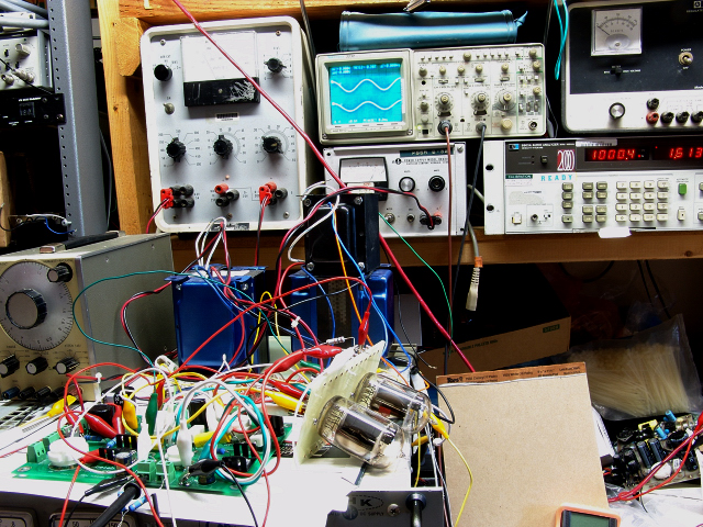

The pentode inside the 6LU8 and 6LR8 (same guts, different base) is not equivalent to the 6L6GC. It's more like a 6EZ5 or 6W6. The triode inside is like a 12AT7.
That said they do make a decent little audio amp. You will get 2 watts or so in triode mode, or maybe 5 watts in pentode in a single ended amp. A pair in push pull will make at least 25 watts.
I used them to make a single ended HiFi amp a dozen years or so ago. This started out with a Tubelab SSE board and a bag full of clip leads. I did make a PC board for it, but it never got beyond the prototype stage.
These tubes like other TV sweep tubes have a fragile screen grid, respect its maximum voltage spec and they will live long and prosper.

Nice project there George, where did you run the screens?

I ran the 6LR8 amp in triode mode or UL mode. This puts the screen grid at nearly the same voltage as the plate, which was about 320 volts in these tests,

This little breadboard uses some old radio tubes to make 20 watts. I let it run at full power overnight with no ill effects. It will be a guitar amp when I ever get around to finishing it. See posts #39 and 57 here:
