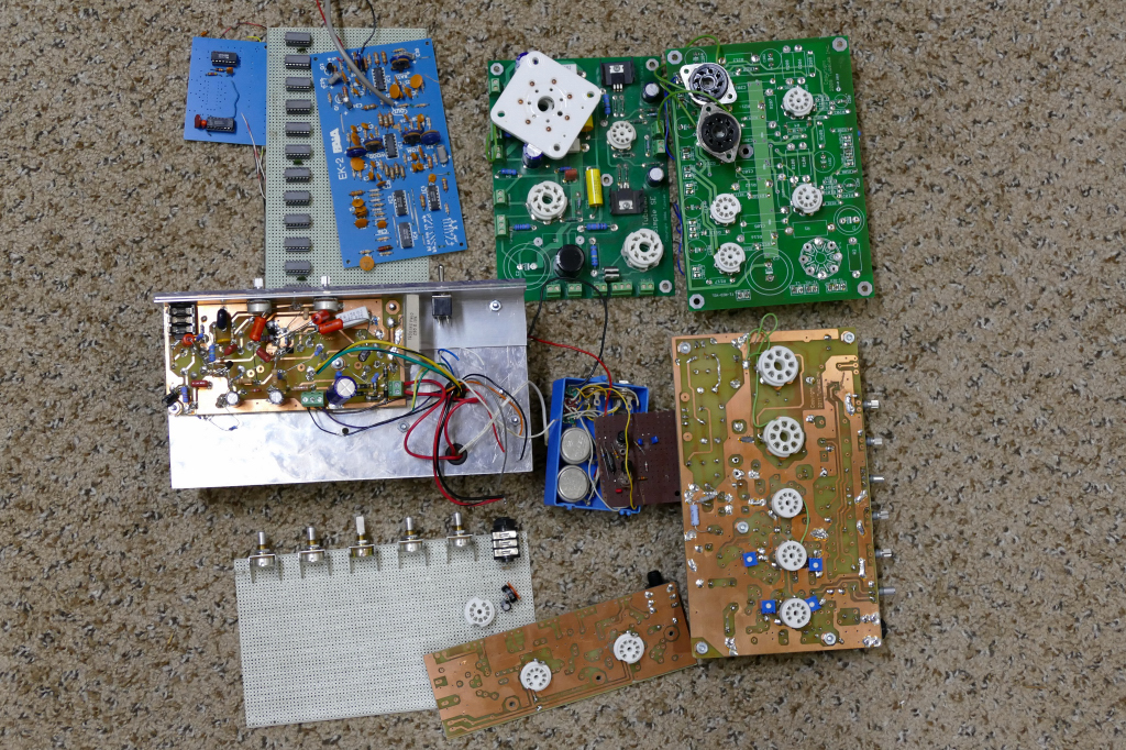

In a quest to find parts to fix a customer's dead HiFi amp, I opened a box......surprise! There were a few un finished, and some barely started breadboards, a PC board for a guitar preamp where only the tube sockets and input jack had been installed, a germanium Fuzz Face clone I made back in about 1970, some PAIA synthesizer experimenters boards, and a couple of my HiFi PC boards hacked to fit bigger tubes. So, there will be some new material.
During the original challenge, I had designed another higher powered amp, expressly for the purpose of seeing how much amp can be made for $99.99 USD. There were two version. The one that saw the most testing and guitar playing used all 9 pin tubes, made about 20 watts and could go from clean to full metal racket. It still has not been found. The other version used the same 9 pin preamp / tone / PI as the all 9 pin version, is just used octal output tubes. It is the board seen in the lower right of the picture. There will be some serious hacking on this board in the near future to see what can be made from it.

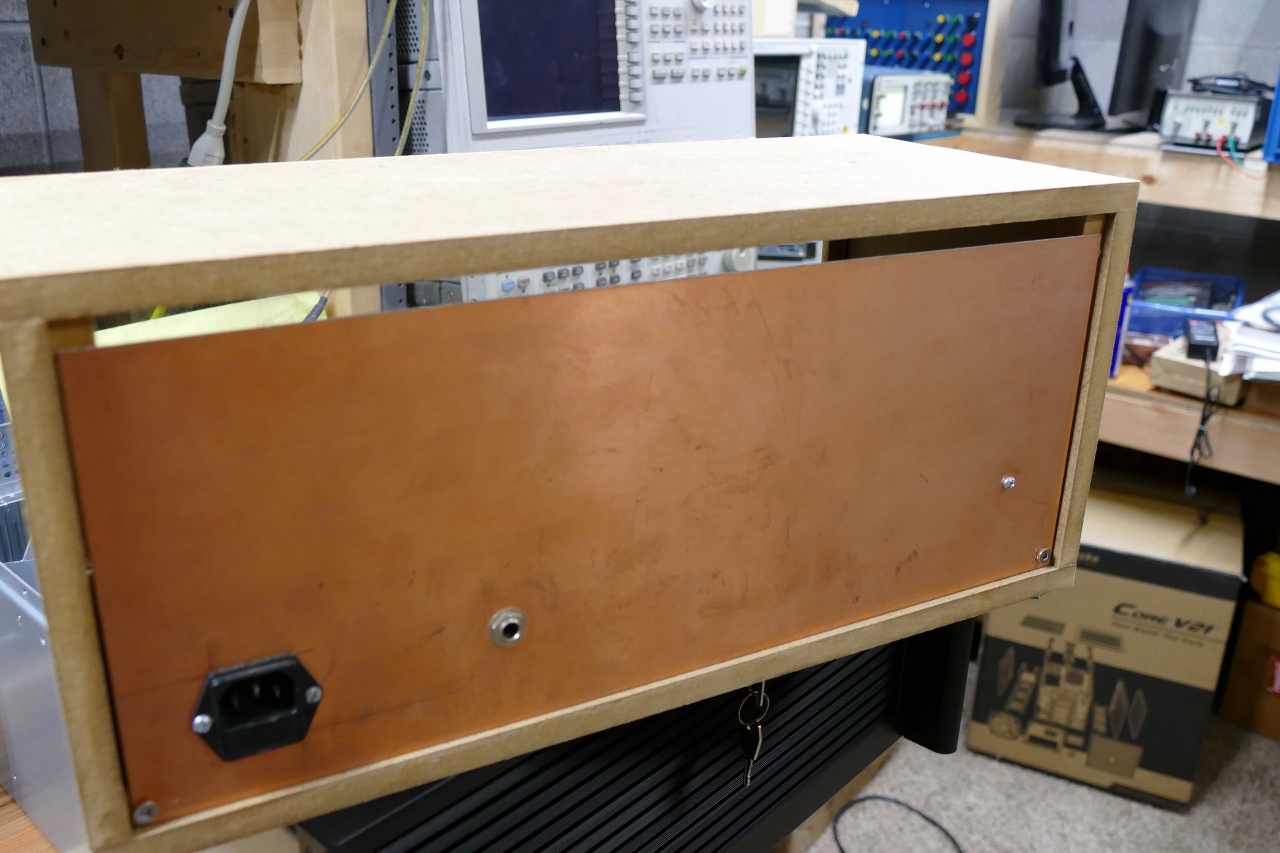

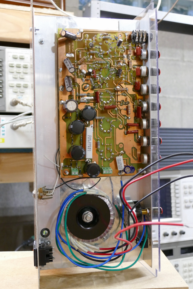

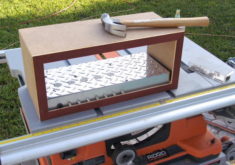

It is amazing how something like posting about an amp I made about 6 years ago can spark up an old memory.
I looked through my pictures from the original thread and realized why I couldn't find the remains of Amp 2.0. I had been looking in smallish boxes for a PC board. I should be looking for a complete amp! I found pictures from 2011 of me building a cabinet for this sucker in Florida. In the first picture you can see the chassis with 5 tube sockets standing vertically on it's side, and the 4 tube amp board (now Amp 1.5) in a box. In the second picture the chassis in in the box sitting on top of the table saw. These are the last known pictures of amp 2.0.........
Until today. The old pictures lead me to believe that there might just be a complete amp somewhere, but I honestly don't remember building one. If it existed, there can't be to many places for it to hide. There is an abandoned mobile home on the property that I use for storage. It is rather run down, and can't be locked up, so I don't keep valuable things there, but it was sitting in a box on the floor in a closet along with a big 48 volt 15 amp power supply that I have been looking for.
I brought it back here and took a few pictures. It is nearly finished.....well maybe. I need to wire up the transformers, and plug it in! The Antek toroid under the deck is the OPT. This amp made over 20 watts at full crank, so there is an "L" pad "power brake" to turn it down.
I will be plugging this baby in as soon as I finish a few commitments and clear off my bench.

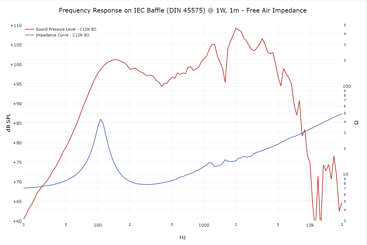

I've attached the frequency response graph of my own favorite guitar speaker, the Jensen C12N. It's very similar to the Eminence speaker you posted earlier.
Another epiphany about guitar amps came when I was playing with 'tone stacks.' Have you ever put an Ampeg-version James tone control in a Fender amp? Want to know what it sounds like? It transforms the amp into a sonic Ampeg doppelganger, at least as far as the clean sound goes.
So, I took away that if you take a so-so amp, put a nice speaker on it (with a sound you like), and make sure the 'tone stack' you use has the kind of EQ/phase bumps and valleys you prefer, you can get that amp to sound pretty OK, at least as far as its clean sound is concerned. Overdrive sound is a different matter.

Re: guitar speaker FR --
In the rock guitar world, players apply a lot of low treble boost. Also, the audience doesn't get the sound pointed at their knees, they get it right in the face.
