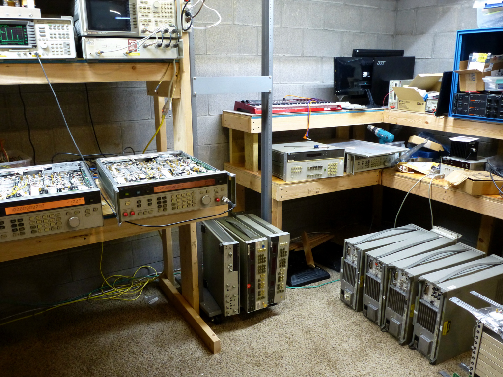

Most of the time I work with one or more bench type power supplies, all Ebay or Hamfest sourced old stuff, a scope and a handful of $4 digital multimeters. I also have an old HP 8903A distortion analyzer and a HP204C audio oscillator. You can do a better job at making the same measurements with a PC and some software.
When designing an amp from scratch, I dial everything in with external power supplies to figure out what the circuit really likes, and then design a power supply to give me those voltages. Sometimes it's an iterative process if there's no cheap transformer to get me there.

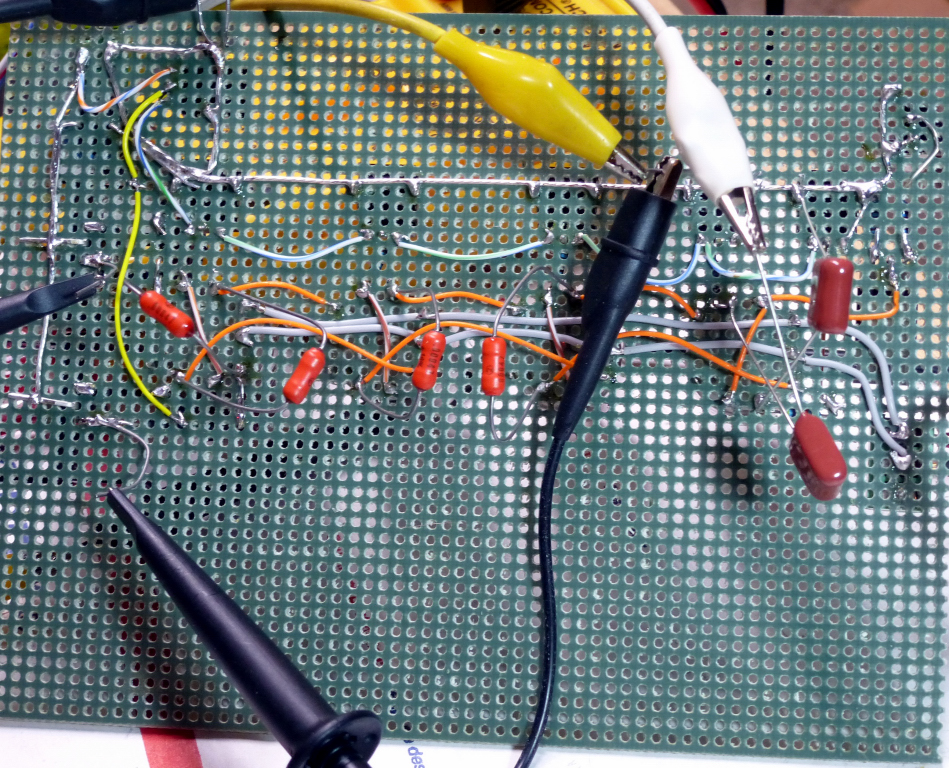

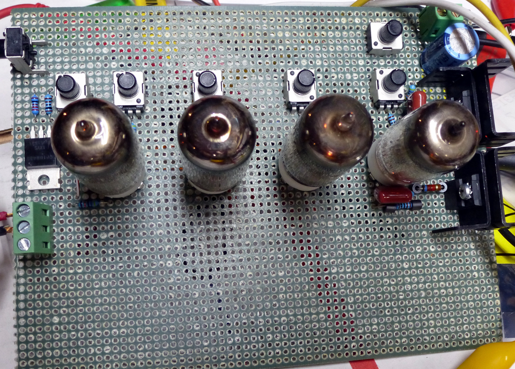

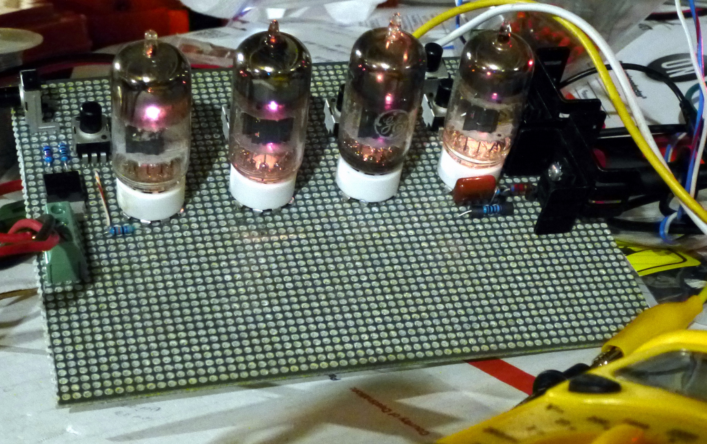

I got a stupid idea into my head. It wouldn't go away, so I had to build it. Of course it didn't do quite what I planned, but it did have a WHOLE bunch of gain. 10 mV of input gives 100 volts of output. I now have a few dozen more ideas to try, but this design is a dead end.
Now does anybody have an idea as to what it was supposed to be?
No idea, but I'm intrigued by how few passive components there are, to support four (?) valve stages. Some direct-coupled stuff happening, maybe?
-Gnobuddy
-Gnobuddy
Yes, all 4 tubes are wired together as a really tall cascode stage, or two of them in a balanced setup. It was my first attempt at a vacuum tube Moog ladder VCF for a music synth. It did actually work, but the plate resistance of the wimpy TV tuner triodes doesn't vary enough to cover even one octave, so it has been deemed a dead end.
