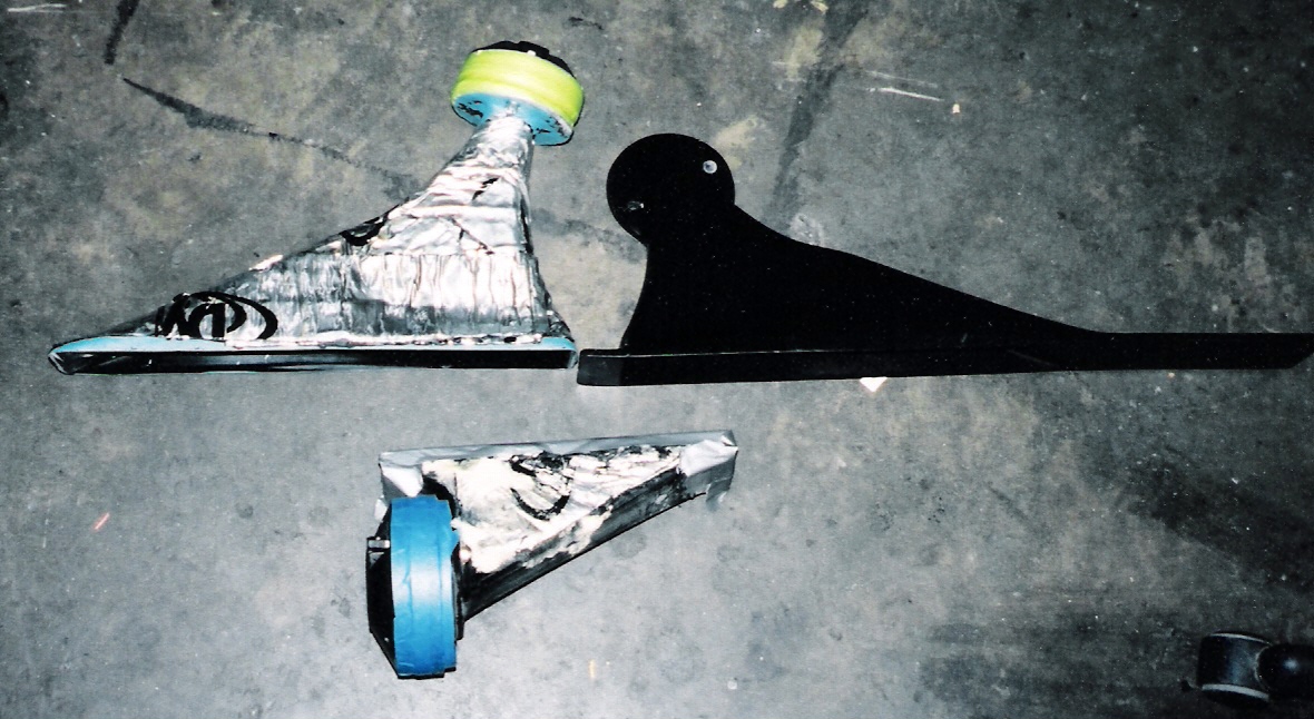

The thing that's enlightening about my experiments is that the three things mentioned in the previous post seem to be as important (if not more than) the shape of the horn itself.
Everyone seems to obsess about the shape of the horn, when those three things seem to matter a great deal also.
For instance, the majority of commercial loudspeakers don't have any diffraction treatment whatsoever. The roundover seems to make an extraordinary difference.
- The off axis response of the treated device is better than the off axis response of the untreated device. This reinforces the theory that a significant fraction of the energy produced by the untreated horn is being generated by waves which are not traveling down the axis of the horn.
- I have treated oblate spheroidal waveguides with foam, and they experience a modest reduction in SPL. About 3db above 10khz, decaying to about 1db at 1khz. This horn, with a diffraction slot, is seeing a much greater reduction in SPL, with a foam plug which is smaller. My theory is that there are more HOMs in this diffraction horn than in an OS waveguide, and the foam is attenuating them.

Well these aren't Summas by any means. I'm listening to my Summas as I type this, and I've been listening to them since 5am this morning. I'd love to see someone listen to a horn for fourteen hours straight without crying "uncle." 🙂
Having said that, the foam and the roundover makes a measurable and breathtaking difference. It's interesting that people have been using EQs to tame horns for decades, when this seems to work a lot better, *and* it's cheaper.

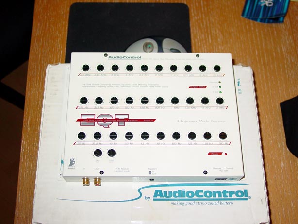

Just curious but where in the frequency range?? Are you talking passive EQ for CD or EQ an in an equalizer??

In the car audio world there's a lot of reverence for "old skool" setups, and a lot of people are copying what worked in the 80s. Myself included, honestly.
In the 80s a standard setup was a set of horn-loaded compression drivers, driven by a good solid state amp, with a pair of 31 band EQs to tame the horns. These were ubiquitous:
If I'm not mistaken, USD, Image Dynamics and Crossfire were basically re-badging Rane EQs. I could be wrong, maybe Winslow will chime in.

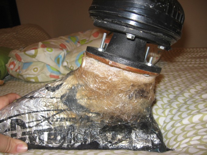

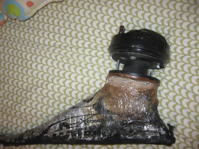

The EQ can tame the horns to an extent, but the foam and the roundover is far more satisfying. Subjectively, the combination of horn and equalizer is satisfying in the short term, but grows fatiguing quickly. In this respect, it's almost perfect for winning sound off competitions, because when you first hear a good set of horns, it's a life-changing experience.
The problem is that they begin to grate on your ears. Slowly, but surely.
The foam and diffraction treatments make the horns sound like a good direct radiator, albeit a very efficient one, instead of a conventional horn.
It would be great to see a company like Image Dynamics license this technology.
The ID EQs were not Rane. USD were Rane. Don't know about Crossfire. I'm using a converted Rane RPM88 in my car for all of my processing needs.

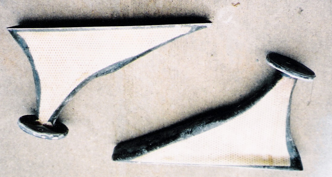

Interesting results. I have been trying to scheme a way to make a curve for the bottom of the horn to the floor for critical listening and judging. The problem I am having would be it would completely obscure the midbasses in the floors. Might give this treatment a go when I get the horns installed in the new car.
Eric at ID does have a copy of Dr. Geddes's book. I am supposed to have sent him some foam a few months back. I need to do that.

Dare I say it, I think the curve you mentioned would be overkill. Just add some foam, a roundover, and be done with it.

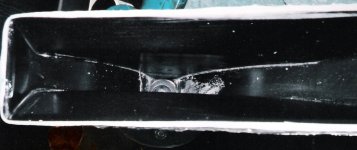

I figure the first couple of inches are very crucial for HOM and diffraction artifact development.
This has been debated extensively and I don't think that there are any conclusions. Its not clear that its true although it does appear to be logical. But "logical" is not proof of fact, and, in fact, in acoustics, its often misleading.

Good application of constrained layer dampening!
I notice the Dynamat layered over with fiber glass cloth. I kind of thought that applied on the exterior of the horn it may work to dampen the resonances. I'm guessing as a slightly viscous layer in between two rigid layers it would really dampen well. Does it work well?
I personally use what is called ice and water shield up here. ( not much use for ice shield in California ) It is used for the first layer on roofing underneath the shingles. It is pretty much the same as Dynamat but has aggregate loading on one side like standard shingles and the most unforgiving sticky glued side on the other. It is not cheap but $85 will get you 3 feet by 60 feet.

The production horn bodies are urethane and could use a layer or two of damping materials to help tame body resonances. These particular horn bodies are fiberglass as they were custom made for me by Image Dynamics to be a straight entry horn rather than having the driver enter at an angle.
But the plan was to use a 2" compression driver and a super tweeter...so I could play the horns really low. So, knowing the flare rate of the horn I found the area progression where the flare went to a 2" entrance. Then I cut the horns there. The glass was used to hold a new 2" mounting flange. I just spread the chopped fiber until it was smooth and even from the cut part ..like icing a cake. There really wasn't a plan to do any additional damping via the glass...but I guess it worked to some degree. The most resonant part is the mouth, the shape and need for thinner material makes it ring some- though nowhere near as bad as the aluminum bodies from Veritas did.
So, I scrapped the idea of the 2" driver and got a smoking deal on the 1.4" Beymas and rolled with them on adapters. The Beymas sound really really good. Hopefully once I get them in the car I will have them crossed a little below 500 hertz on a 72 dB/octave slope.
