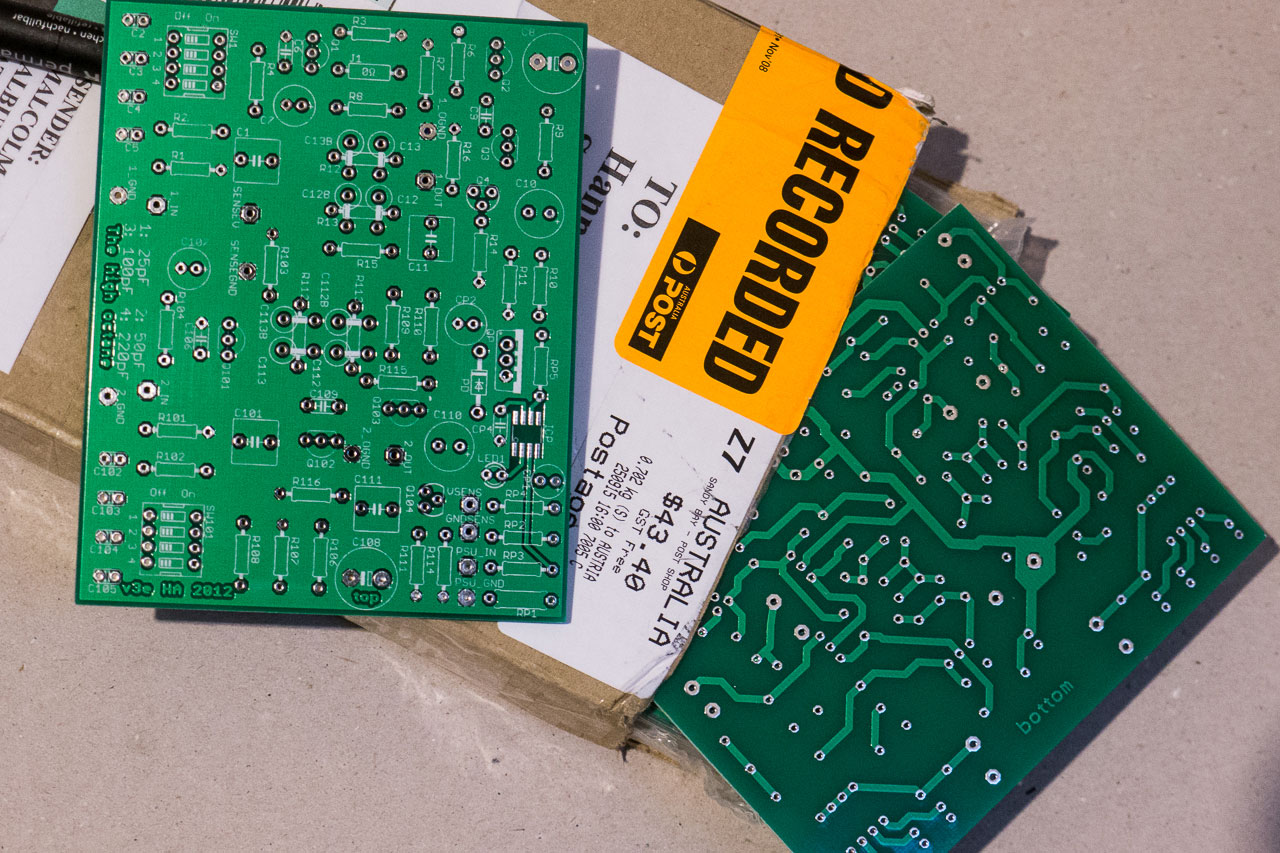

I built your preamplifier with a PCI made by myself. The result of THD and noise were excellent (like published values), and sounds very good, but for a reason I still do not know, this pre saturates the output voltage by approximately + VCC for no apparent reason (at random times), but I can not detect RF oscillations or performance problems in the circuit (when running)...
I used different transistors in the circuit. Someone commented to me these transistors could be suffering from high shot noise or flicker, or is it not the case?
I appreciate if anyone has any suggestion or suspicion.🙂
It could be a flaky electrolytic that intermittently leaks through. Hard to find this kind of issues. Is it only one channel or both? If both, probably in the power supply.

I had checked the power supply and it does not change at all during the event (in fact, this power supply is very good, with good low impedance and low noise). This happens in a channel but during an audio test I suspected that the defect appeared on another channel, but may have just been an swapped channel in the RCA connections during the rapid test.
Another likely defect could be the current source (it it stop providing the output current, logically the voltage output will rise dramatically), but a quick test showed that was still properly polarized (I used a two transistors ring bipolar instead of DN2540).
Some resistors are used but in the previous location they were OK (and them survive better than capacitors to this abuse), yet not rule out the possibility of being one of them.
Probably the fastest would change the capacitors/some res, but as I always like to discover the real cause, so be it ...

Last Saturday I was researching a failure in a timer that I did recently, and the problem lay in the PCB. I "sanded" tracks around the suspect sector, and that solved the problem. And in the pre phono the problem was the same: some invisible residue left over from the corrosion time (I always clean the solder flow, but such cleaning is not the same as "sanding" the PCB).
Maybe it's time for renew the PCB's "acid" (in fact, ferric perchloride is an salt)...

Boards available!
Hi everybody,
one of those things happened that are only made possible by the Internet - pcbs are now available!
Malcolm from Tasmania had ordered a few boards from a board house, but apparently there was a misunderstanding and he got much more boards than intended for the excellent price.
The surplus boards he kindly send to me and I'll gladly give them away for the cost of shipping only (8 Euro for worldwide shipping)!
Whoever is interested to build the high octane is welcome to contact me for boards!
Many thanks Malcolm!!
