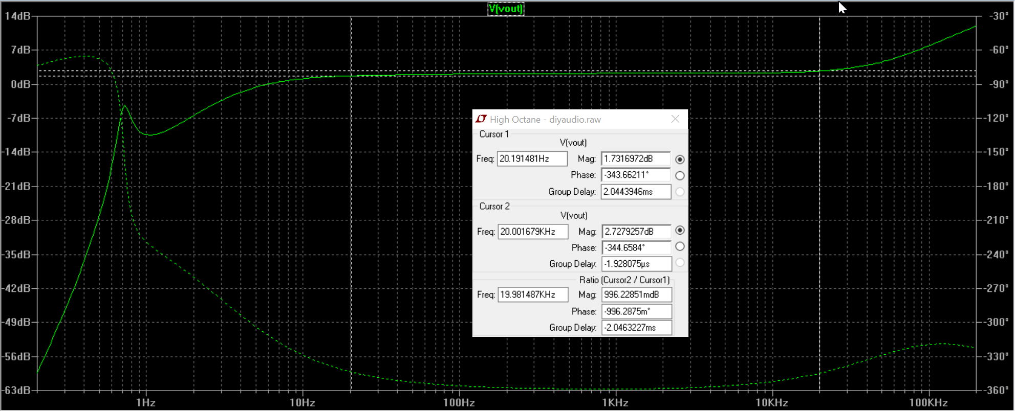

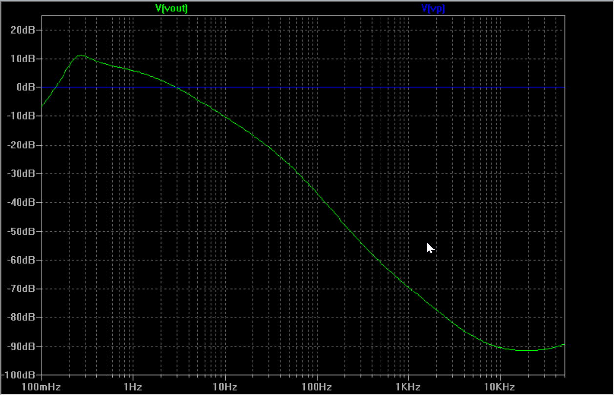

Analysis of the High Octane
Hi fellow RIAAlists
I only saw this thread a few days ago, when it appeared on the first page, and I wondered how good is it really?
I set out to investigate the circuit by simulation with LTSPICE, and this post is the first in a short series:
1) The schematic and AC performance
2) Distortion
3) Noise
4) PSRR (Power Supply Rejection Ratio)
5) Statup and shutdown - how does it behave?
6) Suggestion to improvement.

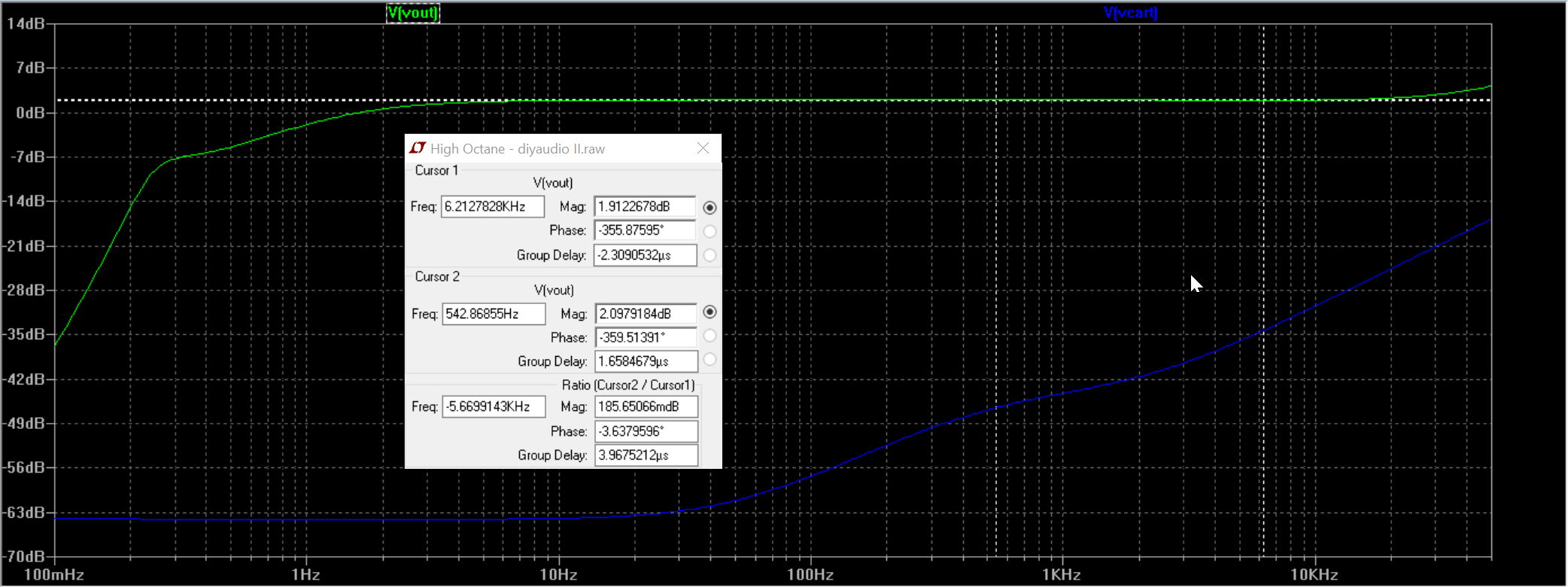

A few comments:
I did not have a LTSPICE model of the 2sc2547, so I tried with 2sc2240 and 2sc3329. The would be my first choice, unfortunately the LTSPICE model has some issues in transient analysis, so I used the 2sc3329. Further I did not have a model for the DN2540, so I substituted with a resistor. This means that specifically the distortions I've found probably would be improved.
AC Performance:
I general it performs quite well with except maybe above 10kHz, where the output rises. Otherwise very nice.
One important observation: at approximately 0.7Hz there seems to be some form of resonans - not so good - I'll get back to that later.

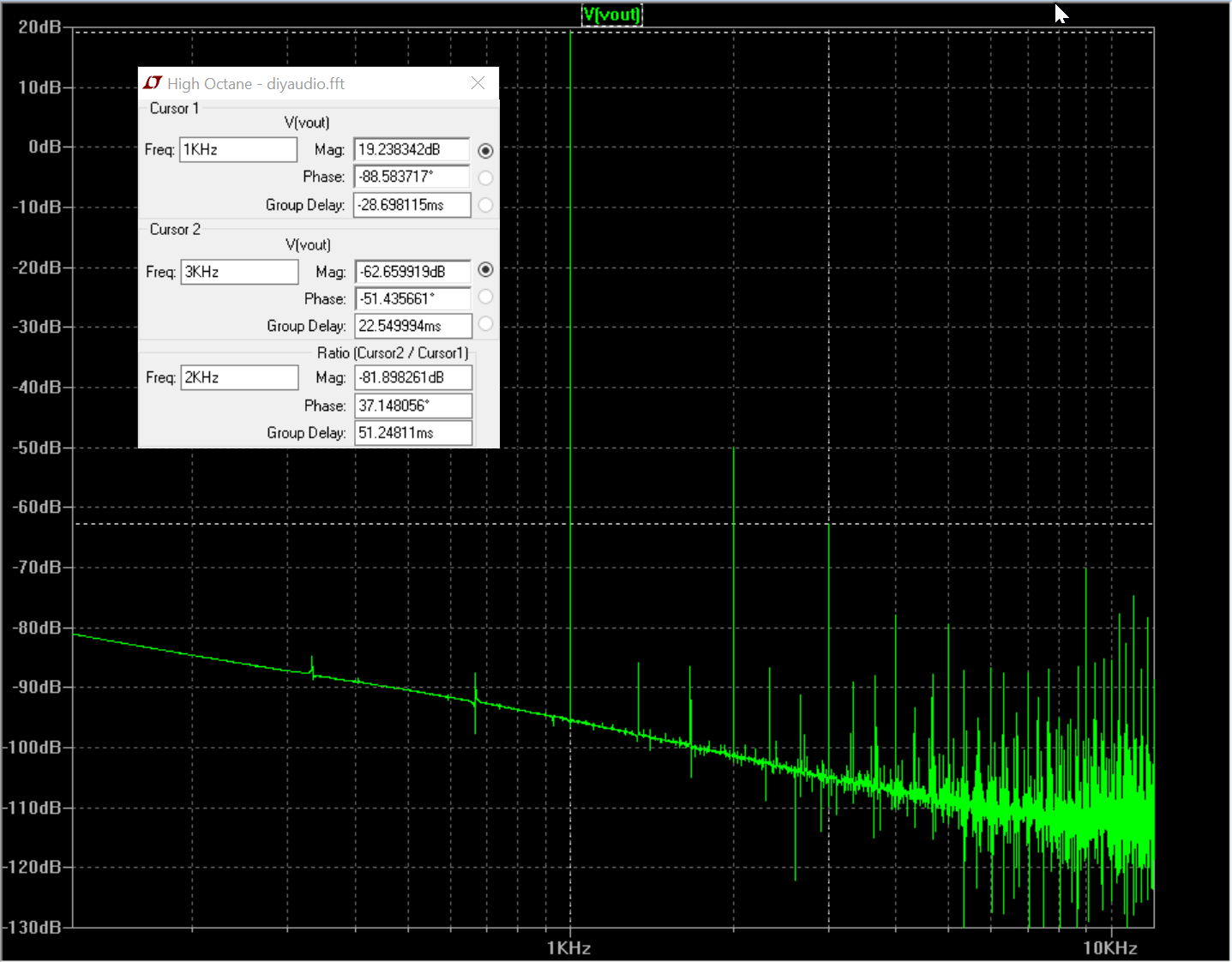

Analysis of the High Octane - Distortion
Distortion
I only simulated at 30Hz (very high gain), 6kHz - the last frq where you can hear the 3rd harmonic at 18kHz, and 1kHz with input turned up to +20dB.
As you can see from the FFT plots, it is very well behaved. Even at +20dB it is well behaved.
Distortion

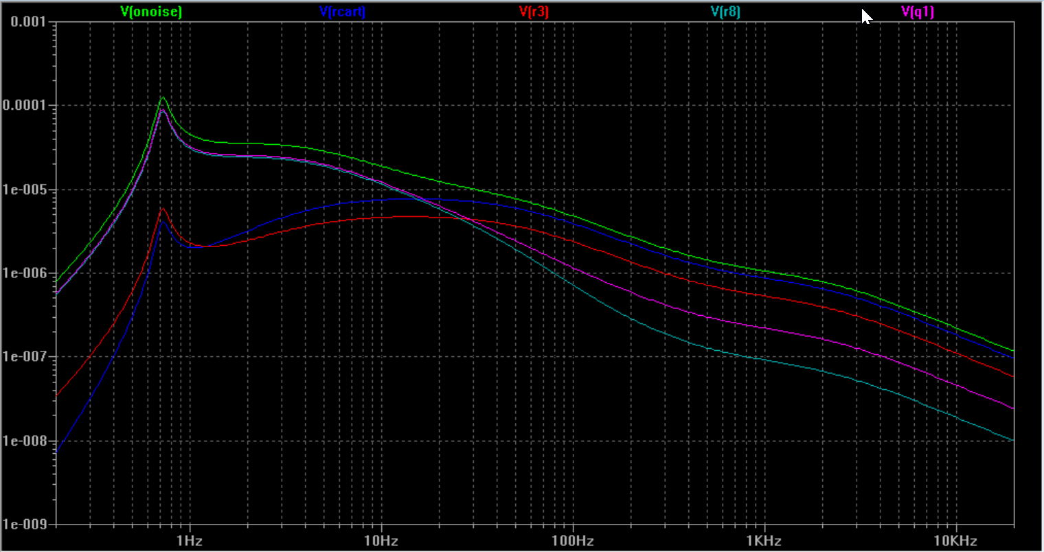

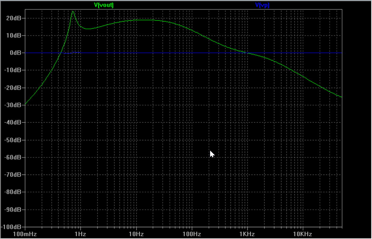

Analysis of the High Octane - Noise
From this graph you may observe two things:
1) In the audio band (20Hz-20Khz) the main noise-contributor is the cartridge itself, as it should be.
2) Below app 17Hz the noise is defined by Q1 and R8. Further it get accentuated by the resonance mentioned earlier. You can't hear this, but if you but finger on the woofer, you most likely will feel it if the volume is set at "realistic" level - whatever that is.
Analysis of the High Octane - PSRR
This is where this circuit shows a spot of bad behavor. Below 1kHz the correct description would be Power Supply Amplification Ratio! This is not exactly stellar performance, it shows how vital it is with a *very* quit PSU.

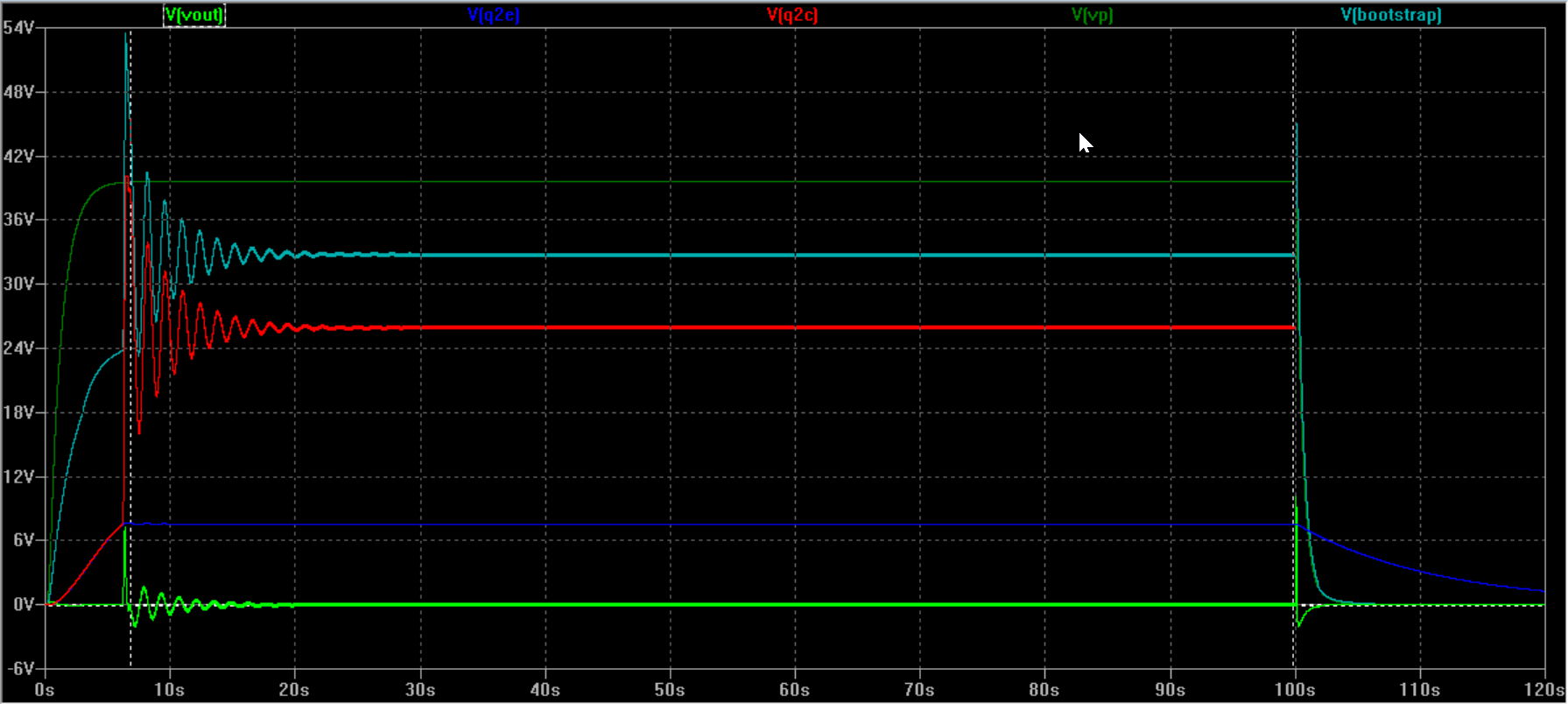

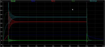

Analysis of the High Octane - Startup
I have not simulated the original PSU, rather supplied my own design. It is first of all completely discrete - no ICs! And it's a shunt regulator as in the original.
Seen from the right, there is voltage doubler rectifier and reservoir capacitors. Next follows a constant current generator, build around Q201 and Q202. Then follow a simple RC-filter (C203 and R204)to remove HF noise. And yes, they are in the correct order! Then we have a power-Zener with a large transistor (Q203) that ensures it can cope with dissipation if it should be tested without load.
Finally there is a lo-pass filter build as a second order Sallen-Key filter.
The actions when power is applied is problematic to say the least, but not very different from other single supply circuits. Capacitors have to get charged before things settle down. But in this case there is a (damped) oscillation at app 0.7Hz - same frq as the peak in plot in my first post.
What happens is basically this: when power is applied, Q1 is off as there is no bias. Q2 then is turned on hard - it saturates - through R4, now C8 slowly charges up through r10 and R9. Eventually Q1 is turned on, removing the base current from Q2 which opens. Q3 then saturates and with the aid of the C10 bootstrap, the base of Q3 actually rises above the power supply. Result: a massive spike at the output.
Also, there is quite a spark when power is removed at 100 second. In other words you do not want to have your input selector on grammophone when turning ths amplifier on or off!

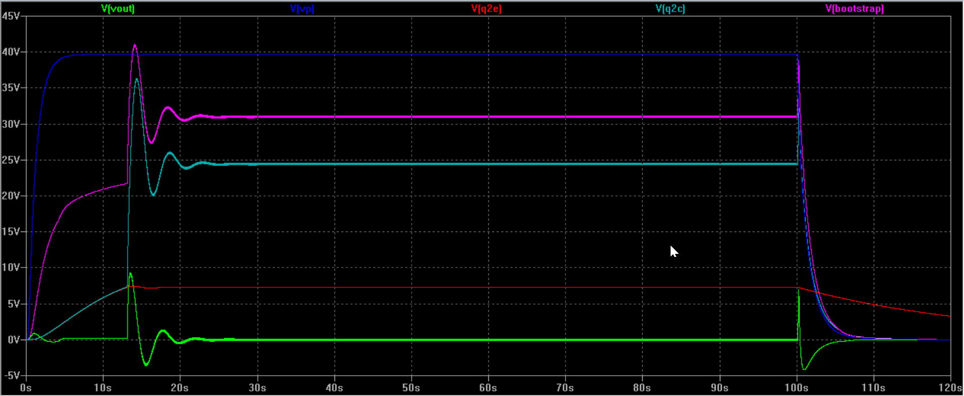

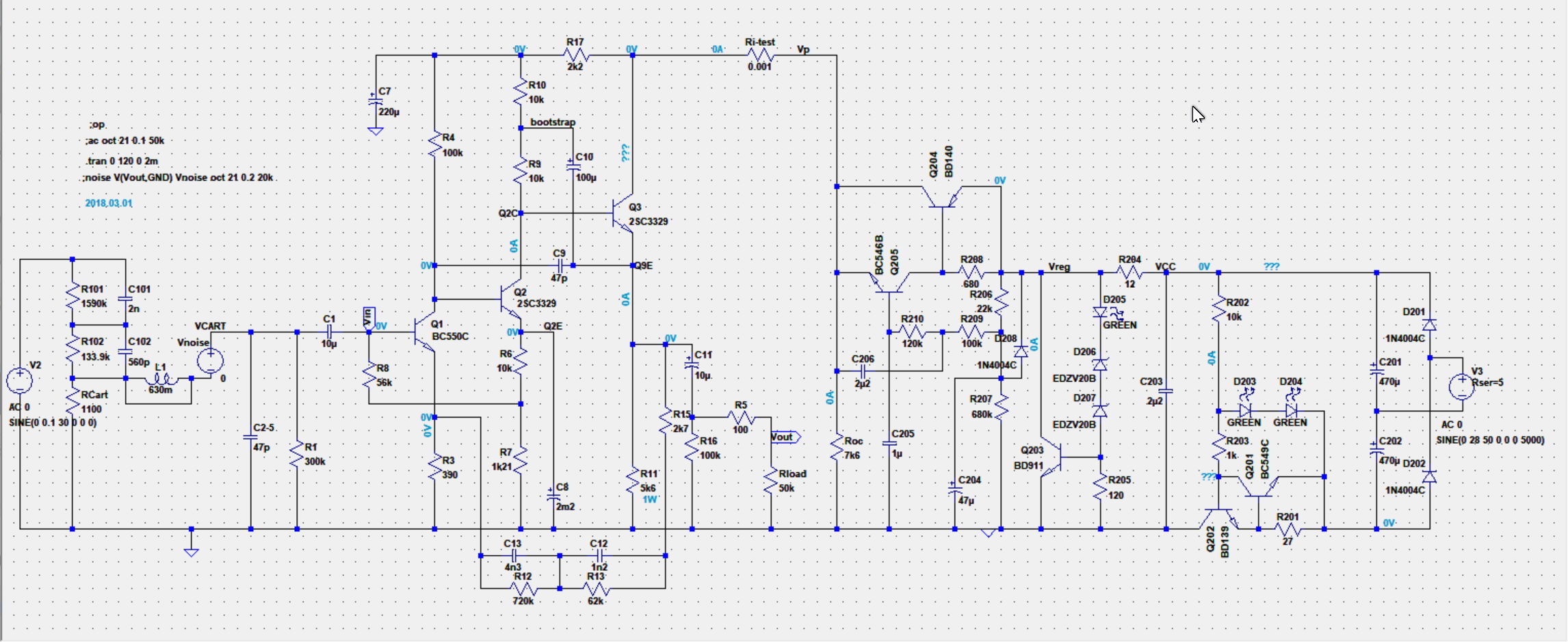

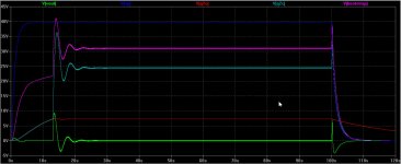

High Octane mrk II
Mrk II
I have found that if you make the changes as can be seen in the schematic below, the problems (sub sonic noise, PSRR and the 0.7Hz resonance) are reduced
I suggest the following component changes:
from to
R1 100k 300k gives 47k input resistance in parallel with R8
R8 100k 56k reduces noise from R8 and Q1
C1 1u 10u maintains contact with the cartridge further down,
reduces noise
C8 1m 2.2m all but eliminates the 0.7 resonance => reduces noise
C9 10p 47p for added stability
C11 1u 10u 1u cannot drive an input at 10kOhm
R16 40k2 100k R16 is there only to insure the potential at the output
is zero, not a filter
R5 47 100 Just be sure there is no oscillation in Q3.
Further I have added
R17 2k2 R17 & C7: PSU filter, improves PSRR
C7 220u Could be larger for better filtering
Mrk II
from to
reduces noise
