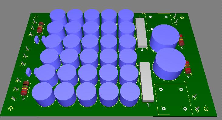

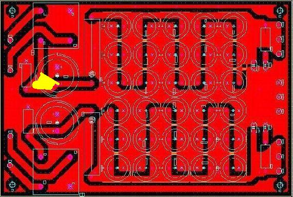

Again a few pics of my pcb i plan to make for my psu. based upon carlosfm schematic!

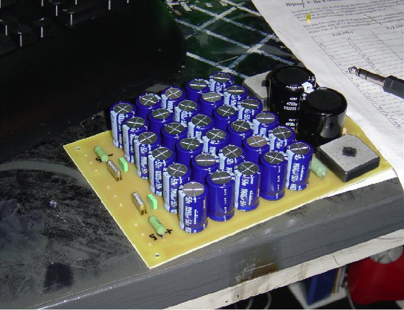

al those little caps are 1000uF/50V nichicon and the big ones are 4700/63V nichicon. bridges are GBPC3504W types.
anyone some comments? what could i improve? what did i do wrong/right?
Thanks in advance
Thanks in advance
board size is by the way 12cm x 18cm not so small.. But i think i can't get it any smaller!
will this PSU with a 300Va 25-0-25 Tranny be sufficient to power 2 ESP P3A's ? an maybe 3 but then with a 500VA tranny?? ( but that's for the future.

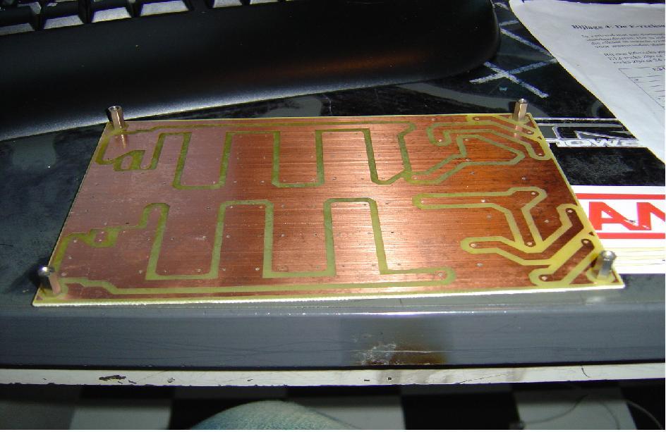

and the copper bottom pic:

fixation said:will this PSU with a 300Va 25-0-25 Tranny be sufficient to power 2 ESP P3A's ? an maybe 3 but then with a 500VA tranny?? ( but that's for the future.
I think so, but I would use at least 20,000uF capacitance after the series resistors.
Unless you have already bought all those caps, consider using 1,500uF or 2,200uf (x15, as you have).
Check it out if you can make a smaller board by using 3,300uF or 4,700uF caps in parallel, for a total of around 30,000uF.
fixation said:and the copper bottom pic:
Much better. 😎
Just one remark, I don't like those traces between the bridges and the first caps. Avoid those corners (on the bleeder resistors), at least fill that up, allow a straight path from the bridges to the caps.
It looks like FIXATION is using the same PCB program as I (Multisim) --
To get rid of that nasty vertex Carlos points out you can drag the power trace towards the ground plane and the vertex will melt away, you can fatten up the trace which will force the vertex to shring. You can also but a "prohibited" area -- in the form of a polygon. Make sure your mitering settings and trace separation are set properly.

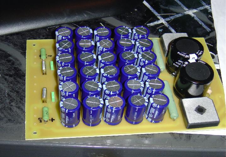

fixation said:and here is the result......
I thinks it looks a quite nice....
It does. 😉
