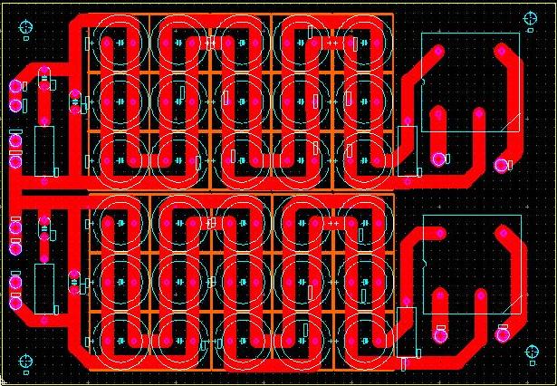

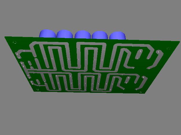

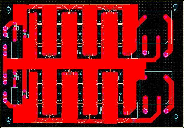

last pic: Copper bottom
PCB is made in Ultiboard 7. Everybody who want a copy of it please email me.
