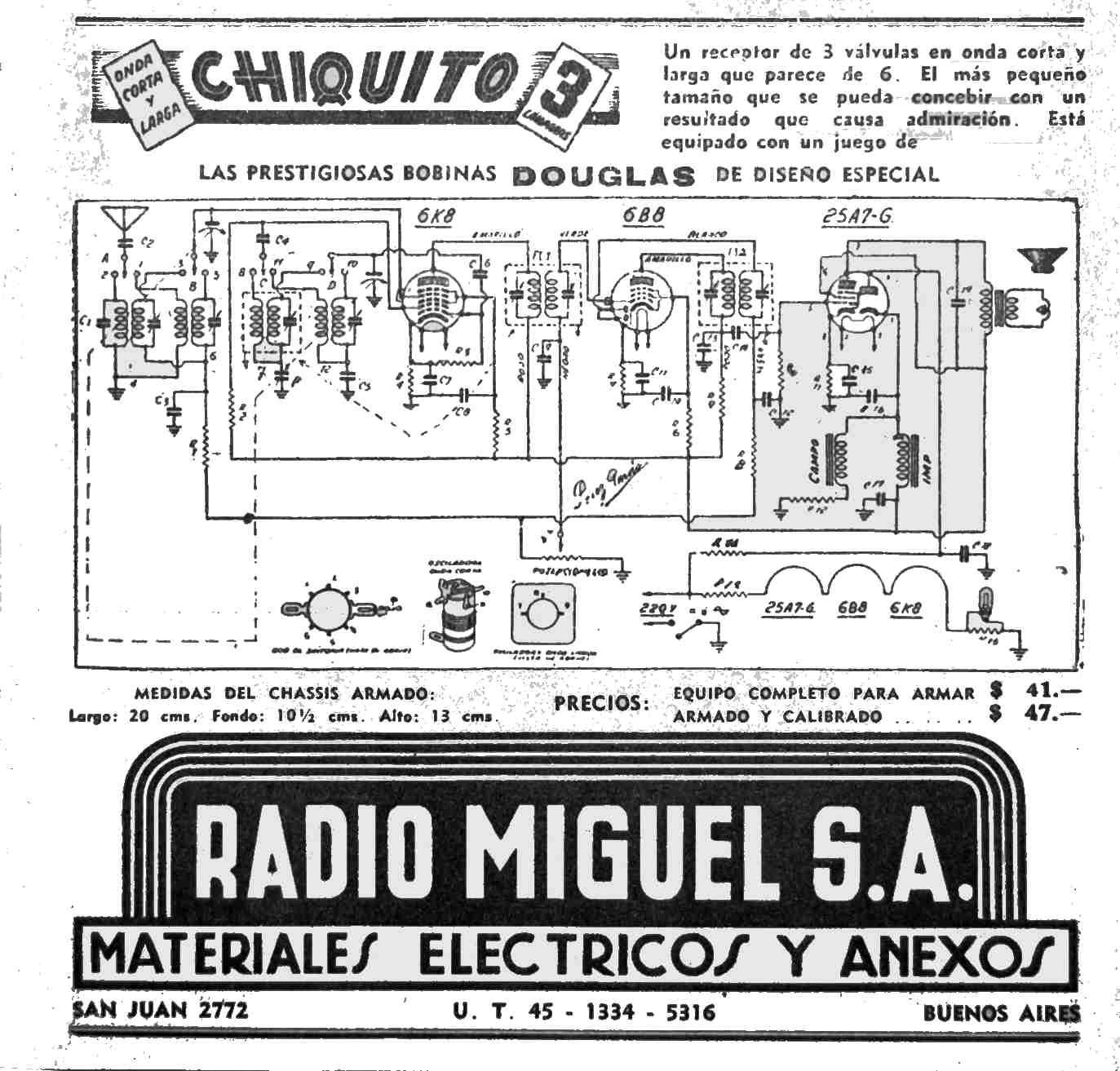

The radios of both current valves were a guarantee for electrocution. If the plug was connected in such a way that the chassis was connected to the live, your life was in danger.
And many inexperienced users/repairers did not tighten the metal screws of the bakelite knobs enough, leaving them exposed to hand contact when handling them....
so if you received a shock, you just had to turn the plug, easy! And here they complain that today there are no safety standards? Is there no longer brave? 😳
