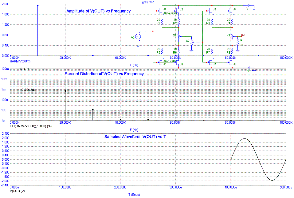

Hereby the analysis:

PMA,
Thanks for posting the analysis.
Grey
